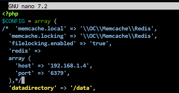

Like this Notice the /* and then the */ further down. Anything between those will be comments. ie. you could write /* Hello World */ as a comment. I just checked, I'm on 30.0.5. I never upgrade in a hurry, I always wait for the upgrade bugs to be ironed out. This may isolate if the issue is Redis. You didn't post your Redis docker log, so that's the only info I can really respond with. Unfortunately, I'm also pressed for time, so its likely I missed something.
[Support] Linuxserver.io - Nextcloud
Yep, if NC is configured for Redis and it can't reach it, it'll fail. Can you ping Redis on it's ip address? What do the Redis docker logs say? If Redis is okay, then it's Collabora, are you running it as a separate docker or AIO? You can temporarily comment out Redis in config.php if it's the main issue.
