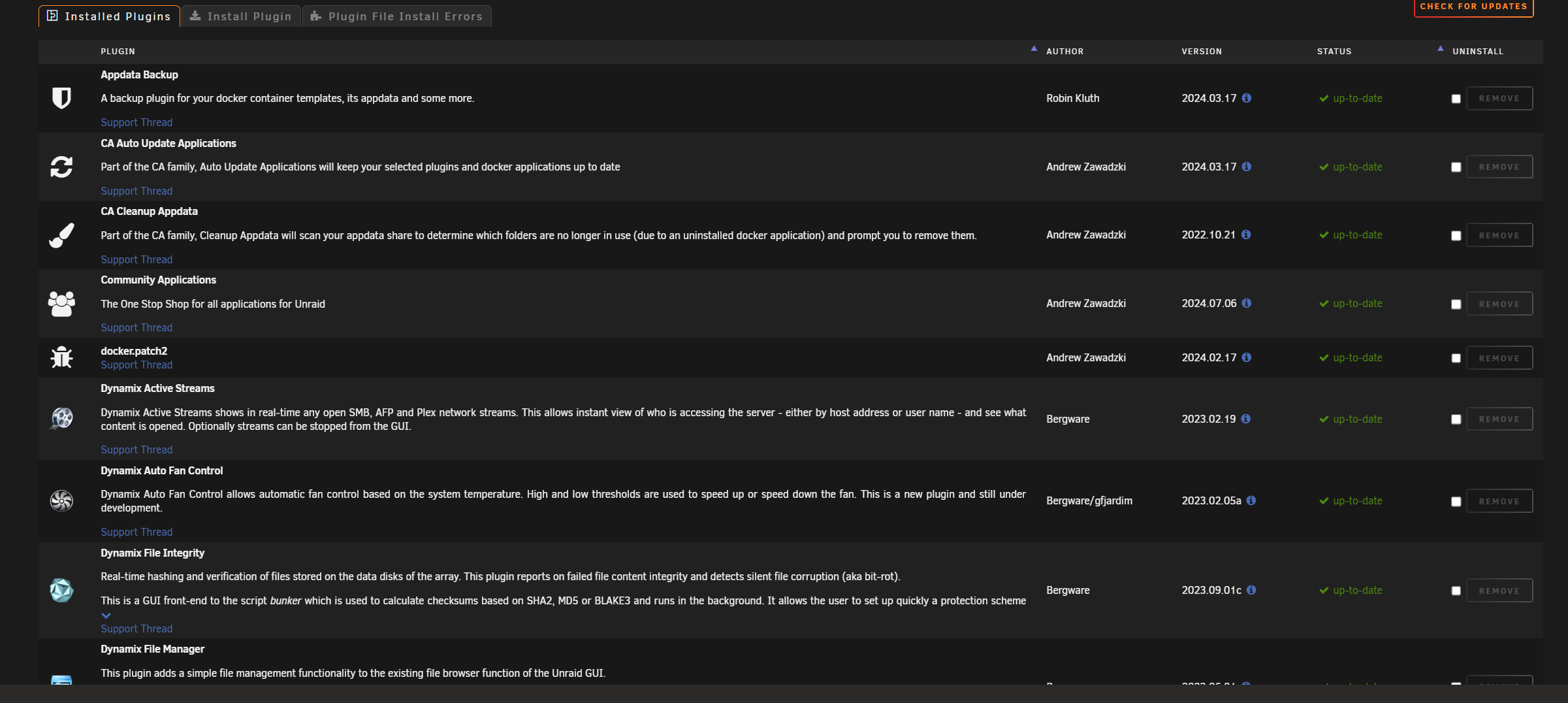

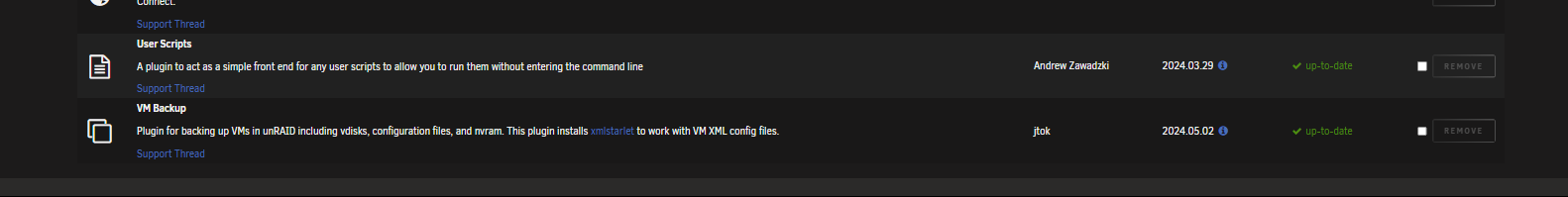

  8. I would load a trial version and don't mount the disks. If that lasts for 24 hours, then mount the disks and give it another 24 hours. Then load a basic docker, like Plex and the disks and another 24 hours. If its conking out at any point along this basic line, then you have a problem that has to be physical. There is no way a clean unRaid build, running Plex and some disks can fall over because of the dockers or issues in the base config. Anything is possible, but highly unlikely. If it doesn't conk out, I would use the same usb and re-build the image (don't restore the image) and re-license. My two cents for what its worth. 🤪

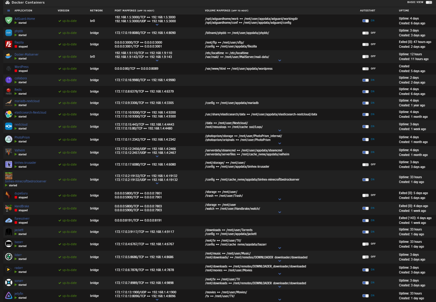

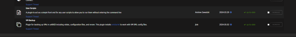

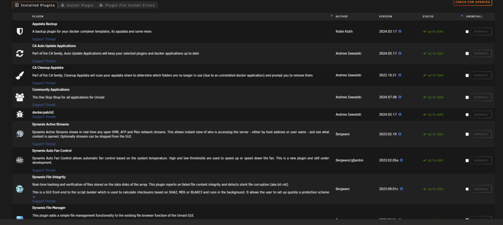

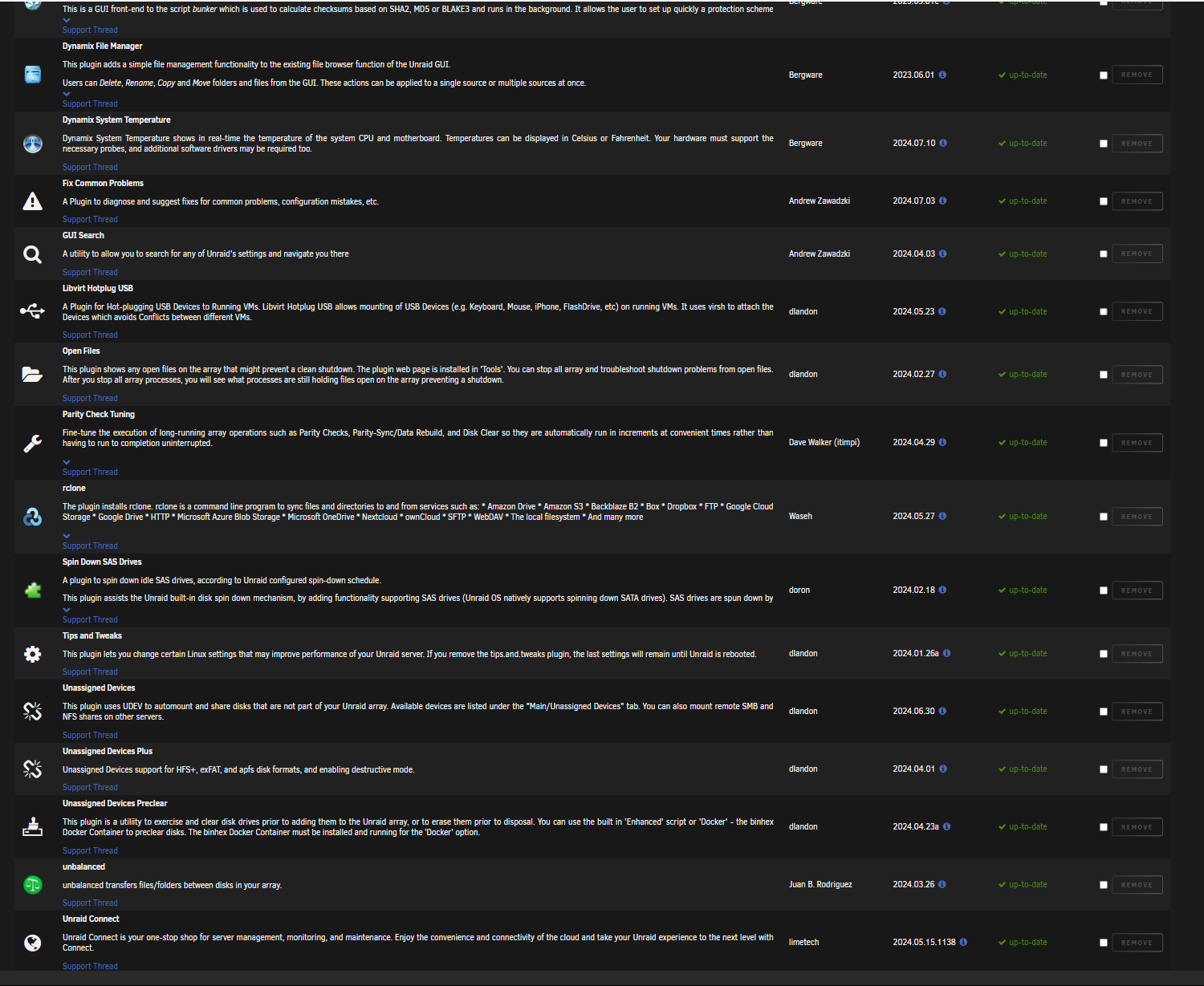

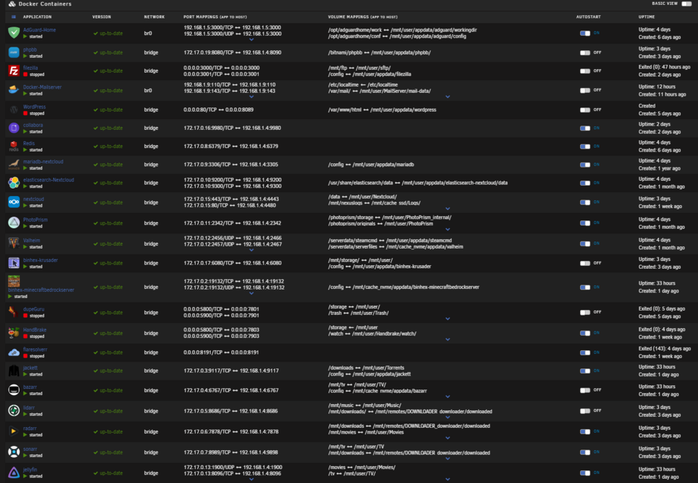

  9. That's what I've got for plugins and dockers, fairly unremarkable. I don't have any nVidia plugins, etc. I run a couple of basic Windows 11 VMs. I still don't think its the plugins though. The only other thing I can think of, is your motherboard's firmware. Sometimes the latest firmware doesn't play nice. I'm guessing if you've tried everything, you've upgraded, etc. and people normally do that when they have a new motherboard. Have you Googled to check if anybody is having trouble with their firmware version that you're on? (Sorry, if that's obvious). Also, are you using an LSI SAS board? If you are, have you tried moving the drives to the motherboard's SATA? Have you Memtested? Short of the above, have you got an empty SSD / nvme that you can use with a Windows or Linux build. Boot with it and leave it for a few days to see if this still occurs (leaving the physical part of the server exactly the same). If nothing, trash the unRaid image and start clean. Backups If you're machine is going down as often as this, I would really look at backuping up the important stuff and I mean daily. You're going to end up with a corruption somewhere along the line. When I was dealing with the similar issue (which was PSU), I eventually trashed the whole lot and started again, but it was an old rig that I'd had in storage for a while.
  10. List your plugins and dockers. I'll compare it with mine.
