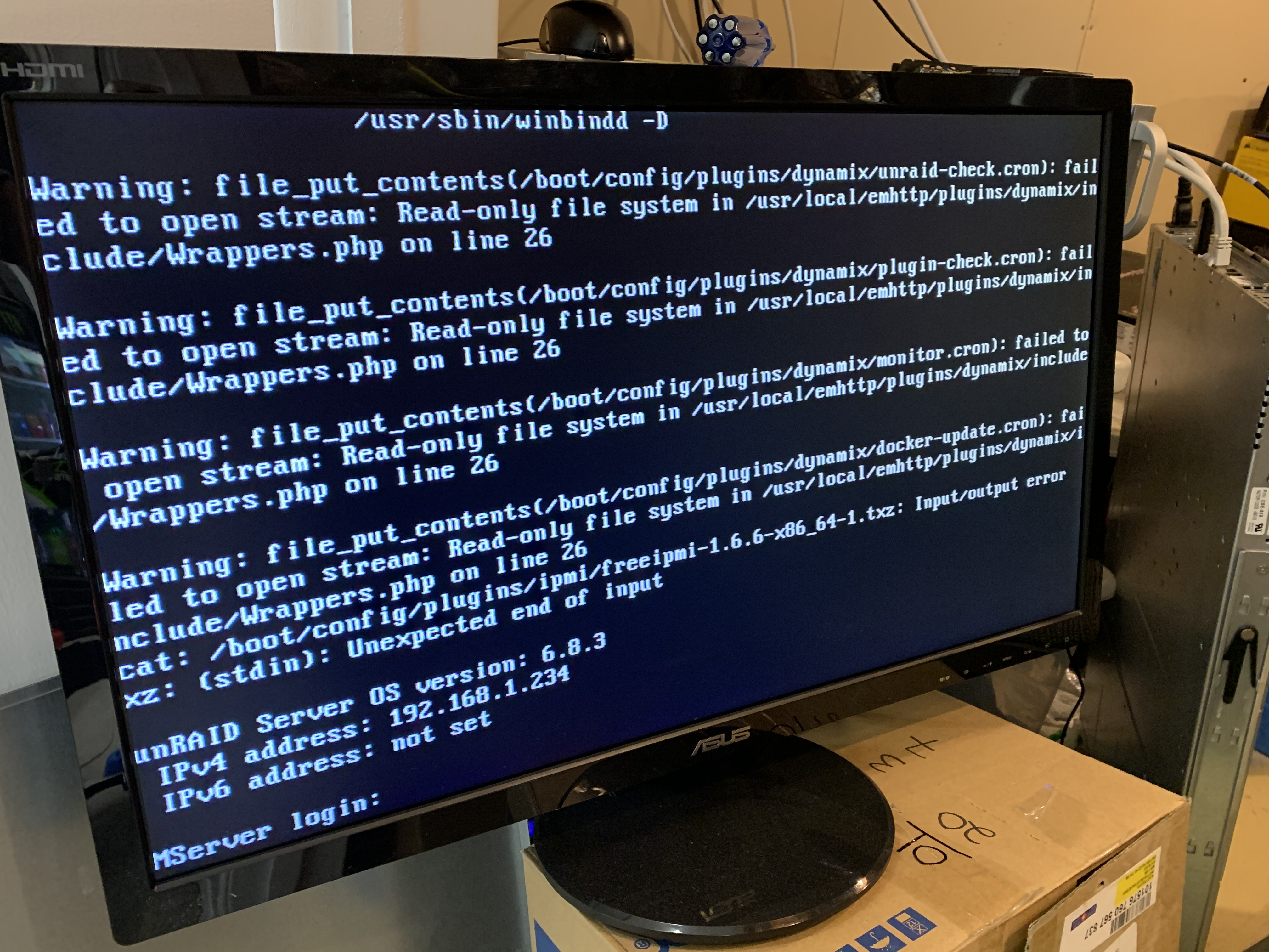

I recently tried upgrade my unraid from a P400 to a P2000.
I couldn't find any resources on how to swap other then shut it down properly and swap it out. Then boot it up.
I could not get access back to the webgui. I have tried with changing back to the p400, tried with no gpu. Everything was working awesome before i changed the gpu. That is all i touched.
I tried the Gui boot, monitor attached and when it tried to pull up the webgui on the machine itself it cannot find it.
Nginx is not running according to the command line.
Command line on the machine still works, ssh still works. how do i get a diagnostic dump to put in here? Or is it a easy fix?
Managed to try to get my diagnostics. i get " mkdir: cannot create directory `/boot/logs` : Read-Only file system Bus Error"
i am signed in as root through ssh.

That would indicate a problem with your unRAID flash disk as would all the other errors on the screen that indicate problems writing to the flash drive.
Put your flash drive in a Window machine and let it run chkdsk on it to correct any errors.  Then try booting again in unRAID server.
