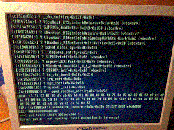

I'm now on 5.0.3, and starting my unraid VM I got a kernel PANIC!
See attached images, anyone else see this ? this have been working flawless on previous unraid releases..
a better size of the image : https://dl.dropboxusercontent.com/u/46562247/IMG_0362.JPG
it's happen 3 times, now i'm afraid if it have cause any damage on my drives ??, parity check for the third time is running ..........

Yes,  running on my second box with the Supermicro-H8DM8E-2, as soon as I moved to 5.0.3  I had kernel panics anytime vboxwebsrv was running.  I could not start any VMs without introducing the panic.  Things worked 100% stable under 5.0  so I reverted back.
I can run 5.0.3 and it appears to be stable for me as long as I disable vboxwebsrv .
I didn't tested it yet, but I'm wondering if you didn't got such problems on 5.0.1? Since kernel was updated on 5.0.1, and looking at changelog seems strange that changes on 5.0.2 and 5.0.3 could cause it?
Also are you running VirtualBox 4.3.2? Same VirtualBox version before the problems?

Yes, version v4.3.2 and it was working great when I used 5.0.1 and  5.02
//Peter

The Realtek driver was updated in 5.0.3 and your m/b uses a Realtek chip........
O yes, that might be the issue here? Shall you do  a new version with the older r8168, if so please read the mail I sent to you ????

I do also have Realtek and just recompiled virtualbox (4.3.2) package myself on unraid 5.0.3 and no problem at all, my vm's start and work without any problem or error shown on syslog. Maybe you just need to recompile it on 5.0.3 really due to some changes on kernel config/patches from 5.0.2?

5.0.2 seems stable to me, but 5.0.3  does trigger the panic.  I'm using a Supermicro H8DME-2 with one of the onboard NICs.
The NICs are nVidia MCP55 , here is the result of lspci:
00:08.0 Bridge: nVidia Corporation MCP55 Ethernet (rev a3)
        Kernel driver in use: forcedeth
        Kernel modules: forcedeth
Anyone that have compiled vbox with 5.0.3? if so, can it be up loaded somewhere for DL ?
//Peter
//Peter
You can download my package at http://nars.aloj.net/temp/unraid/
however please note that there is a small difference on it from lainie packages: the installer script on my package doesn't link configuration dir /root/.VirtualBox to /boot/custom/vbox then you may need to do it before running vboxwebsrv... just:
ln -sf /boot/custom/vbox /root/.VirtualBox
Edit: If you use the virtualbox unraid plugin the link will not be an issue, as I did looked at the plugin code and I can see that it actually gets rid of the link created by lainie packages, and then re-recreates it to the user specified directory.
