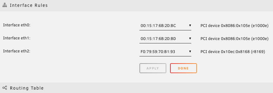

5 minutes ago, letrain said:
Rules section? i'm not seeing that.
It's immediately above the Routing Table section:
but since you're not seeing it you'll have to free up those other NICs temporarily so that Unraid can see them, then that section should appear. So go to Tools -> System Devices and un-stub them (you'll need to stop the VM that uses them first, of course). Then re-boot, navigate to the Settings -> Network Settings page again and reassign eth0 to the appropriate MAC address. Then you can go back and re-stub them, re-boot and start the VM.
