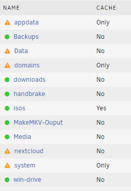

Verify no shares are set to cache-prefer?
I set everything to no on the cache settings. Still not moving. From my understanding of the settings is that "No" won't move anything but anything no won't go there. Is that a correct understanding?
My plan is to use unBlance to move the files "Data" files off the cache. Is that a good approach?
That is correct. Cache-no won't write any new files to cache, but it also won't move anything. You need to get things moved off cache.
  1. Disable Docker and VM Manager in Settings
  2. Set appdata, domains, system shares to cache-only
  3. Set Data and nextcloud shares to cache-yes
  4. Run mover without the plugin
Wait for it to complete then post new diagnostics.
Thanks you guy are amazing and I don't know how to read  :). I was miss understand the difference between "Yes" and "Prefer".
It's working now. Thanks for helping out.
