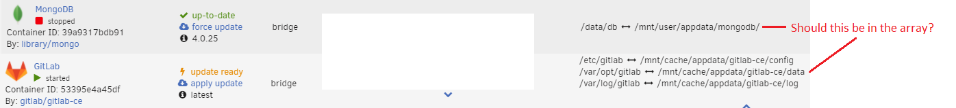

I have all my docker appdata and most paths defined in the docker templates located on my cache drive. I have been relying on the CA Backup / Restore Appdata plugin to ensure the data is safely stored on the array in case of a failure of the cache drive. I recently changed my cache drive to one with a larger size and had some hiccups with file permissions resulting in some files left on the old drive not moved to the new drive etc. I fixed it by restoring a backup from some days earlier. The only problem is my MongoDB container which won't start now due to corrupted files. I read up on it and it seems that the WiredTiger.wt gest corrupted when CA Backup / Restore Appdata does it's thing. Now this post is not about fixing my MongoDB install, but rather about container path mapping. After these issues I started thinking about how my container paths are mapped to paths on my server. Two examples are my GitLab and my MongoDb instances.
Generally should the data paths of containers be located on the array instead of the cache drive?
Also I see the GitLab instance points to /mnt/cache/appdata/ instead of /mnt/user/appdata/ is that a problem?
