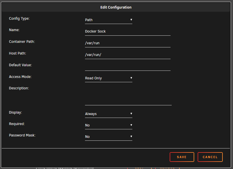

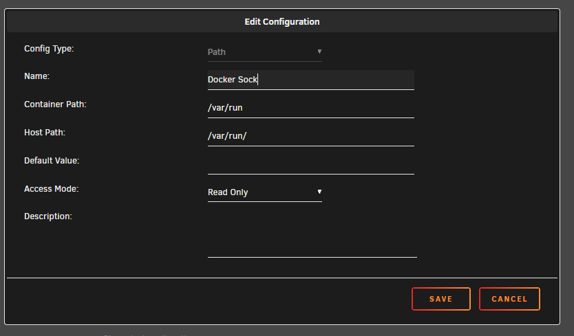

Docker monitoring works fine for me.  One thing you do need to do that is not part of the template is add a read only path for /var/run
So I already had that in my docker template. What resolved it for me was to use the docker container ID in the monitor instead of the docker name.

This container maps all of /var/run from the host into the container. This appears to be so that the container can access the docker socket (/var/run/docker.sock), but the container actually gets all of the data in /var/run, including the Tailscale socket in /var/run/tailscale/tailscaled.sock.
The "correct" way to fix the issue is to remove the "Docker Socket" mapping from the template. If you need the Docker socket, you can instead map it directly by creating a new mapping for /var/run/docker.sock -> /var/run/docker.sock

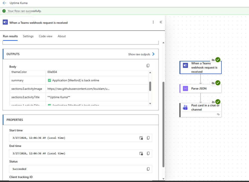

I need some help from a guru, I have uptime Kuma working great and I have it sending a notification message to a teams group using Power automate since Webhooks are being discontinued. so here is where I am at, I can get the message to fire when something goes down and I get teams message however its not pulling any of the ServerID info from uptime. I am only getting Server: Unknown instead of the name of the device. I can see that the info is getting sent to power automate because I see it in the log. I am brand new to power automate so IM sure its something I am or am not doing. would anyone be willing to help me get the power automate configured properly to show the right info?
Here is a test I ran, You can see on the output on the left the data is pulled. I just dont know how to pull that data to send the message.
