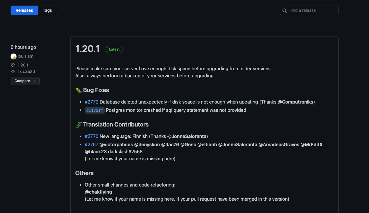

Ouch latest update seems to have wiped out everything I had.
I saw mention that there were back up files but those were empty also.
Any recommendations on this moving forward so we don't lose all data.
Also when I went to click on the Web gui it went to the "Create your admin account" asking for username, password, repeat password.
Edited by chip

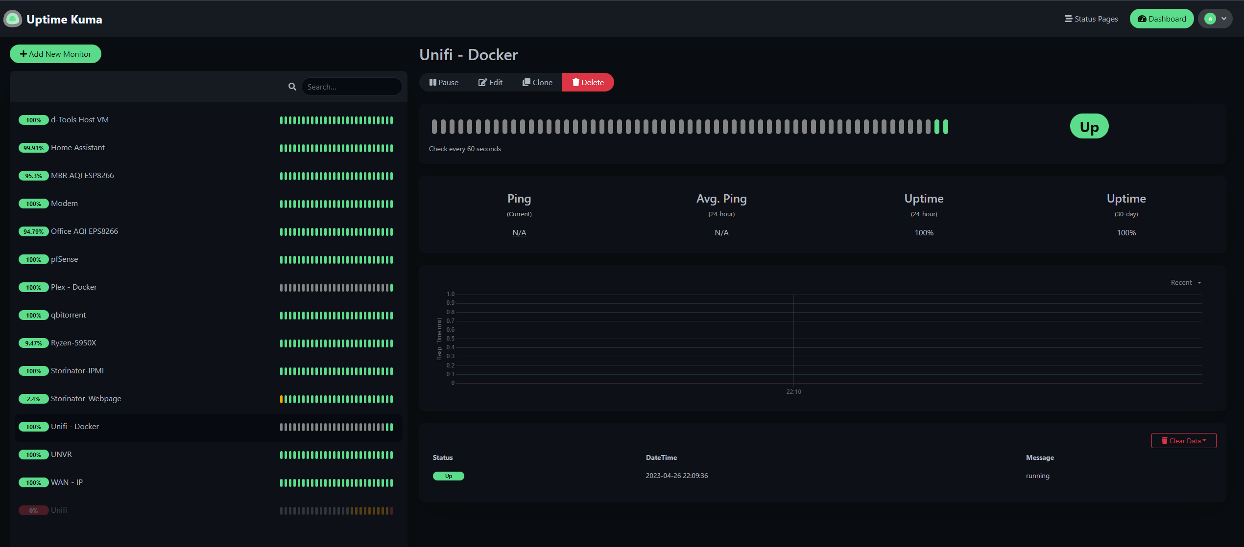

For some reason a recent Uptime Kuma or Unifi Controller update broke them talking to eachother for webpage status.
Found-out the docker host connection was now added. Woot!
