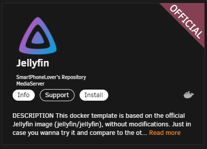

January 20, 20224 yr Not sure if that`s the right topic, but any possibility to add the official jellyfin repository/template to CA? https://github.com/jellyfin/jellyfin/blob/master/deployment/unraid/docker-templates Or otherwise to support the official jellyfin release with an unraid template? Kind regards.
