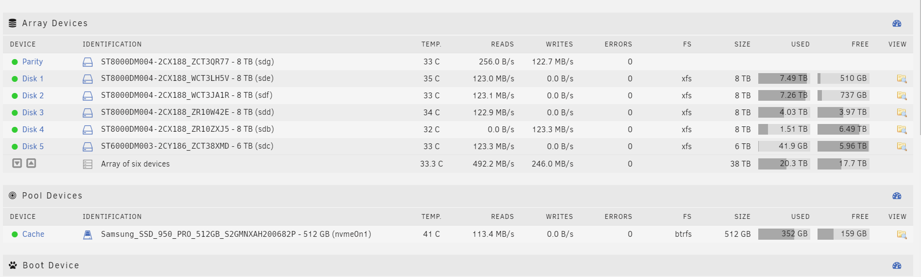

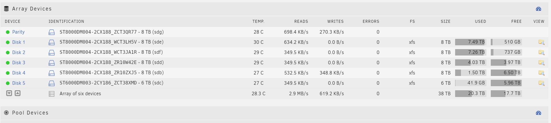

August 8, 20215 yr so im very new to unraid/linux and ive been having having fun setting everything up, i recently added a NVME drive to help with Sabnzbd and overall system response, for the most part its been good, but today i've had some strange behavour where mover seems to either get stuck or Moves VERY slowly from the cache drive to the array, while its moving from the cache drive to the array it seems to Write at lets say 5mb to drive 4, but it also reads from drive 4 at 5mb and read and writes the same to parity, from my experience so far with unraid, that seams strange/odd, ive had to restart (uncleanly ill add) twice now one of witch took ssh'ing to force a reboot as it seemed stuck could any one shine some light on what could be happening? jarvis-diagnostics-20210808-0148.zip

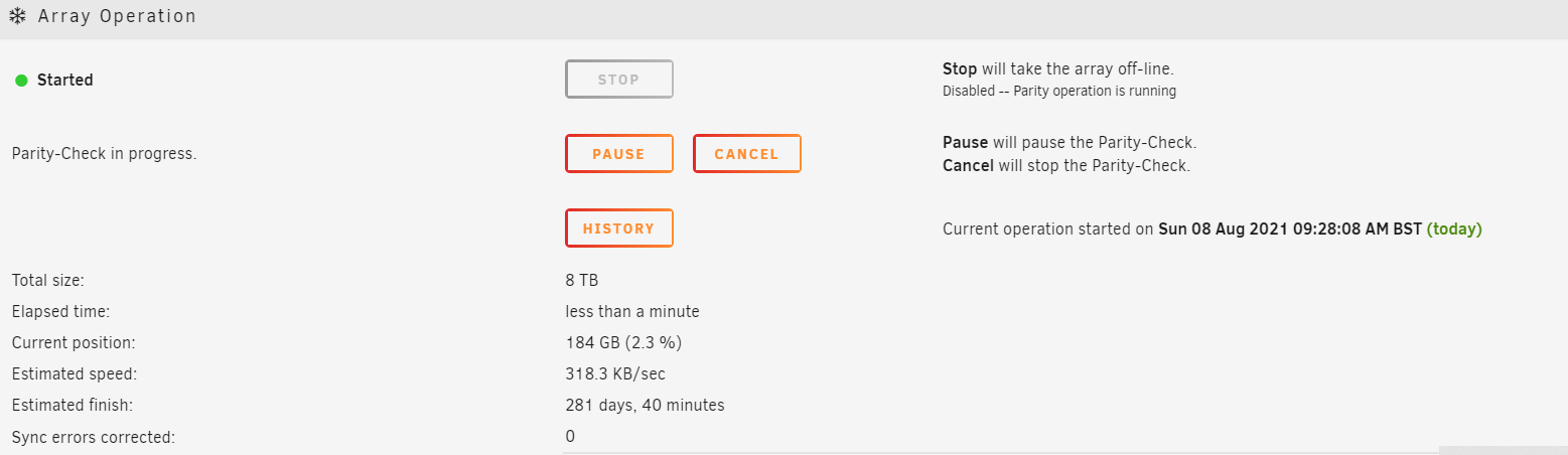

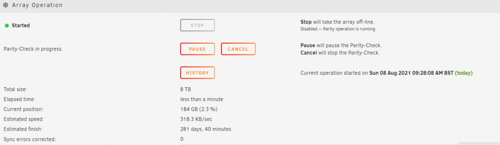

August 8, 20215 yr Author its done it again, i thought i had solved it, so its been running its parity cheak, woke up to find it doing a 318kb parity cheak it was doing about 140mb before i went to sleep..but yeah.. with 281 days Remaining 😂

August 8, 20215 yr 52 minutes ago, Puregreen59 said: its done it again, i thought i had solved it, so its been running its parity cheak, woke up to find it doing a 318kb parity cheak it was doing about 140mb before i went to sleep..but yeah.. with 281 days Remaining 😂 I suppose at least one drive or controller is not behaving correctly. Your diagnostics during the check might show something.
August 8, 20215 yr Author 6 minutes ago, ChatNoir said: I suppose at least one drive or controller is not behaving correctly. Your diagnostics during the check might show something. well i hope you know more than the uninitiated that i am Haha! i paused the parity check to try and get to the bottom of it, but on the assumption that the log has info from this morning when i work up maybe there's something interesting in this one. jarvis-diagnostics-20210808-1033.zip
August 8, 20215 yr Author so just a update, i noticed that stopping all my dockers didn't do it today, then i remembered that i have a VM ill just add that System, iso's and domain are all cache ONLY so they shouldn't have been writing to the array and have confirmed they is none of them shares on the Disk1, Dist2 ect ect. its all on cache where i expect it to be, any ideas on this weird behaviour? could it be the cache drive?.. i don't know its really strange.. i mean its a old nvme ssd but it should still be WAY good enough to at the very least be able to do more than 5mb's while its running a VM that's idle? i feel like its not that, i feel like something strange, either something that's normal with unraid i don't know about, or something bugging out. some background specs, asus tuff x570 plus ryzen 3900X 32gb ram IBM ServeRAID M5110 flashed in IT mode (LSI SAS2308) the Cache drive is a Samsung 950 PRO 512gb (BTFS) 5 x 8tb Seagate baracuda SMR (5400 i think? all shucked, one of these is my parity drive) 1 x 6tb Seagate baracuda SMR (5400 i think? also shucked) Nvidia 1080

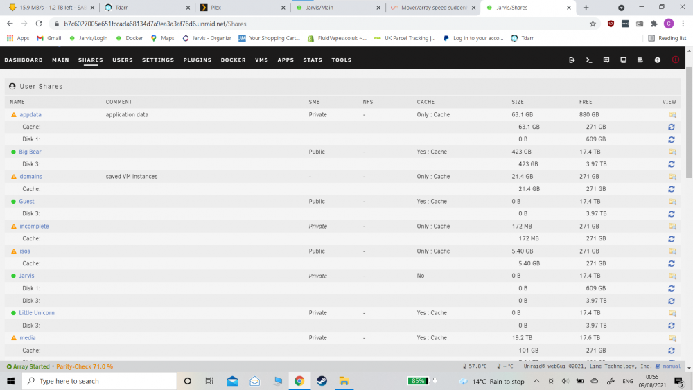

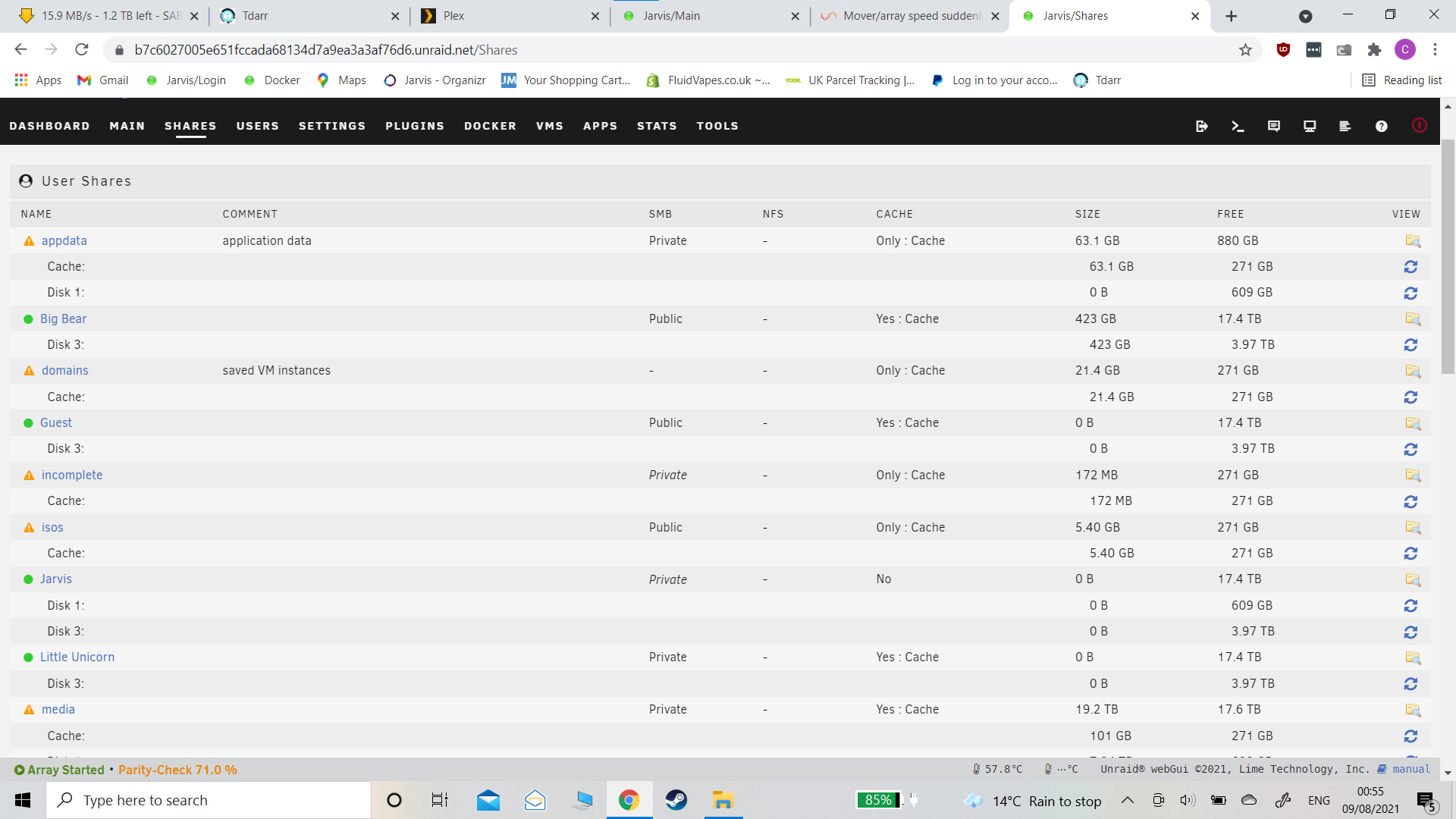

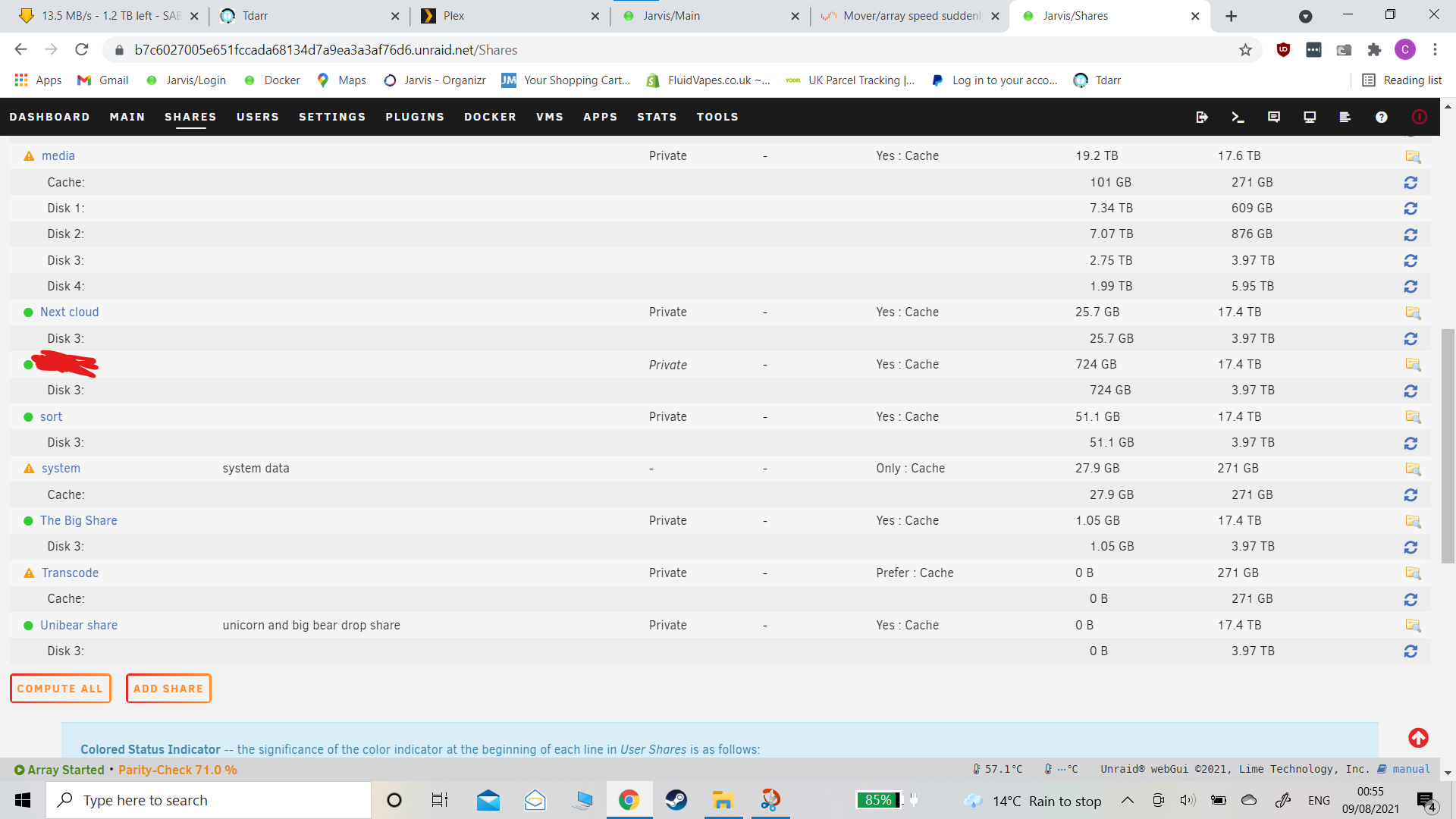

August 8, 20215 yr Community Expert And just to give some idea of what is typical for parity check, I usually estimate 2-3 hours per TB of parity. So for you, 16-24 hours for 8TB parity. Also, nothing has changed about this problem I mentioned earlier: 16 hours ago, trurl said: It looks like you may have accidentally created some folders at the top level of pool or array disks. Any folder at the top level of pools or array is automatically a User Share. Go to Shares - User Shares, click Compute All, wait for the result, then post a screenshot.
August 9, 20215 yr Author 5 hours ago, trurl said: Go to Shares - User Shares, click Compute All, wait for the result, then post a screenshot. I've crossed one out, don't ask questions and I wont lie too you 🤣

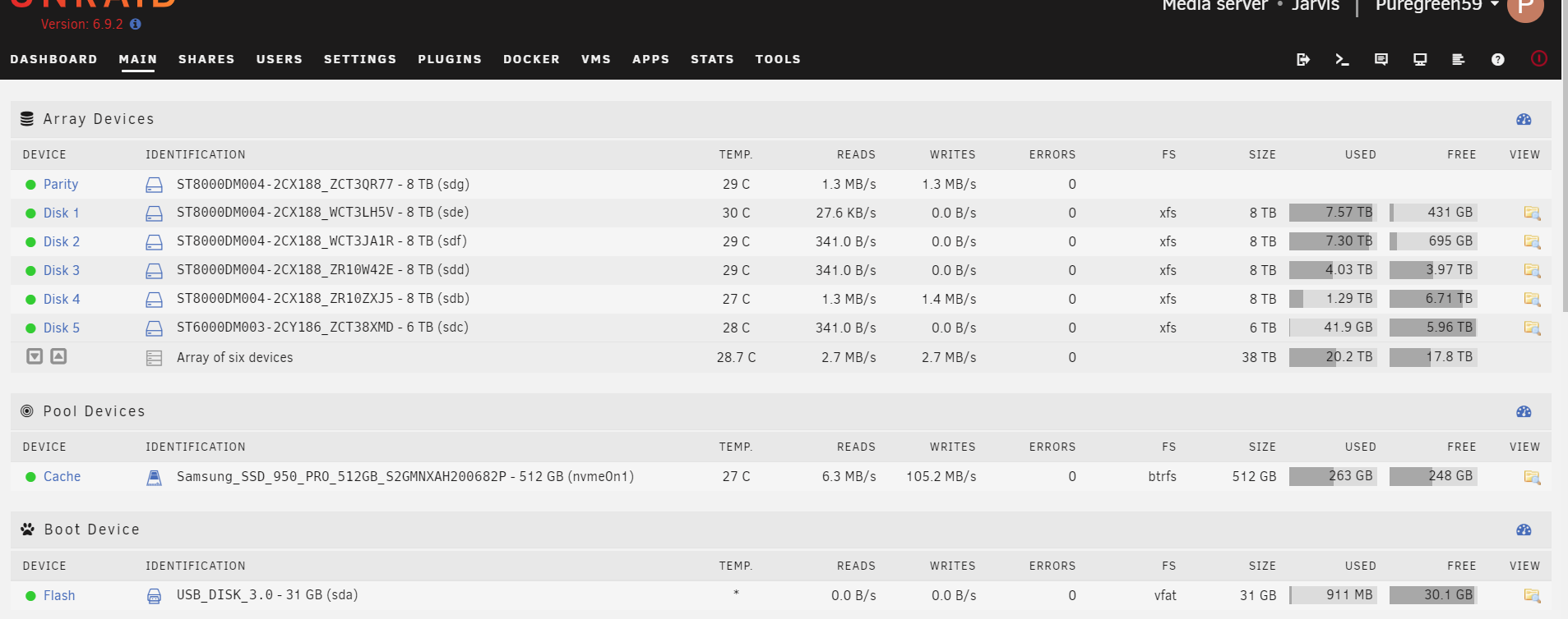

September 4, 20215 yr Author okay so im still having trouble with with mover. i've currently almost finished migrating to unraid, and ive set up my lists on radarr and theres quite a back log off movies, a good tb or 2, that need to be downloaded un-rared, recoded to h265 via Tdarr while on the cache drive then move to the array, but what's holding me up now is this mover problem. if anyone can shed some light on more commands or something im missing please enlighten me. im lost and a bit frustrated because i know what happens next, from here im gunna get bored of waiting for seemingly nothing, im going to try and reboot unraid, that's gunna take forever, possibly fail, but if it doesn't fail its going to reboot and tell me it detected a unclean shutdown. then i've got a 50/50% chance its gunna work perfectly fine and move everything like nothing was wrong. i really need some in-sight to whats going on here. hopefully this helps show what i see my side as well as logs.. jarvis-diagnostics-20210904-2120.zip
