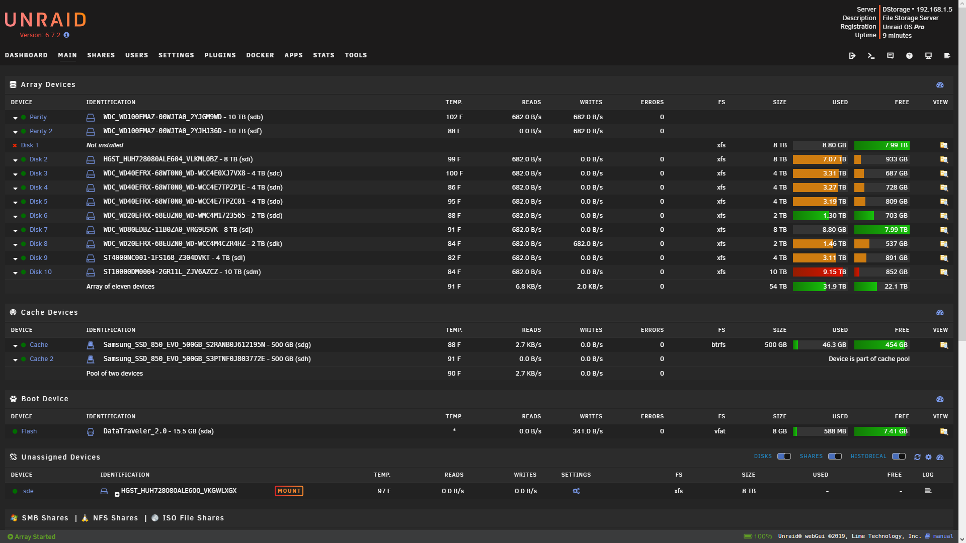

August 16, 20215 yr This is a total horror story. I had 2 drives go down. I have dual parity. I followed the procedure to begin replacement of the first drive that failed. I unassigned both drives, stopped the array, and added one (new) drive to the empty slot. While the drive was in the process of rebuilding, a power issue happened, and the system got powered off. When the system came back on, it reported that the rebuild was still in process. However, it was asking me to format the drive and the unassigned device. I left that request alone until the rebuild was completed on that drive, assuming it would go away after the rebuild. After the rebuild finished on the first drive, I rebooted. The message was still there, and the drives said they were unmoutable, so I made the mistake of using that format option. I now have an unassigned drive and the newly rebuilt drive that are both EMPTY. I am horrified. I need to know how to get this system back to normal. Edited August 24, 20215 yr by David Spivey solved

August 16, 20215 yr Author @JorgeB The "not installed" disk from my screenshot has been formatted. I had no idea that unraid could or would even format an emulated drive. @trurl Both disk1 and disk7 were almost fully filled disks in the array. The current disk7 is the replacement drive for that slot. My diags are attached. diagnostics-20210816-1520.zip
August 16, 20215 yr Community Expert 8 minutes ago, David Spivey said: The "not installed" disk from my screenshot has been formatted. I had no idea that unraid could or would even format an emulated drive. I was asking about the unassigned disk:
August 16, 20215 yr Author 2 minutes ago, JorgeB said: I was asking about the unassigned disk: This is the disk from disk1's slot. It is mountable and readable. The other drive that was unassigned from disk7's slot is outside of the system.
August 16, 20215 yr Community Expert 52 minutes ago, David Spivey said: It is mountable and readable. If it has the old data you can copy the data to the array, or do a new config assign it to the array and re-sync parity, same for disk7.

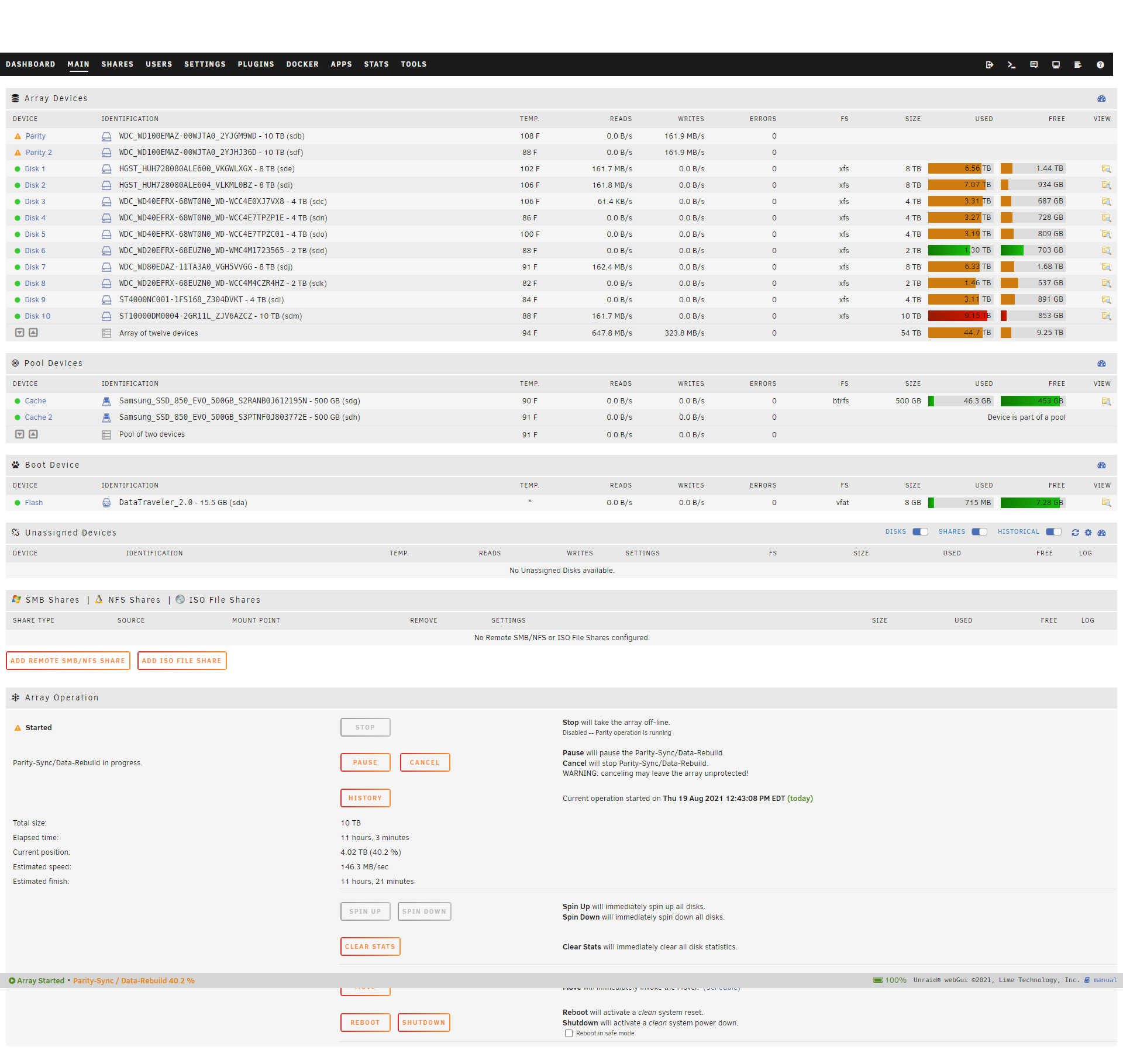

August 19, 20215 yr Community Expert 2 minutes ago, David Spivey said: Fortunately I had already been careful enough to go into disk settings and disable auto start before I rebooted to put the drives in. Rebooted... So does that mean you already put the drives in and booted up?
August 19, 20215 yr Author 7 minutes ago, trurl said: Rebooted... So does that mean you already put the drives in and booted up? Yep. New config already done. All drives carefully assigned to their proper places, and it's rebuilding parity now.
August 20, 20215 yr Author 8 hours ago, trurl said: Post a screenshot and new diagnostics dstorage-diagnostics-20210819-2345.zip
August 20, 20215 yr Community Expert That looks good, data on disks 1,7, zeros in the Errors column with parity resyncing, nothing bad in syslog.
