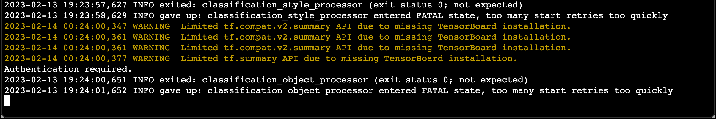

February 14, 20233 yr I installed Photonix but I haven't been able to get it to work. I'm pretty sure I was able to configure and get through the initial set up, but I just get a blank page when I go to the webUI. Checking the logs I seem to be getting the following error about a missing "Tensorboard" installation over and over. Did I miss something that I was supposed to install?
May 7, 20233 yr I just installed and get the same thing. I see that my postgresql database is populated with tables, so it made the connection. The redis documentation is lacking and I cannot get that to work. Sitting here with a blank login screen too. Maybe I bag this app, but I want a multi user app. Dang it.
