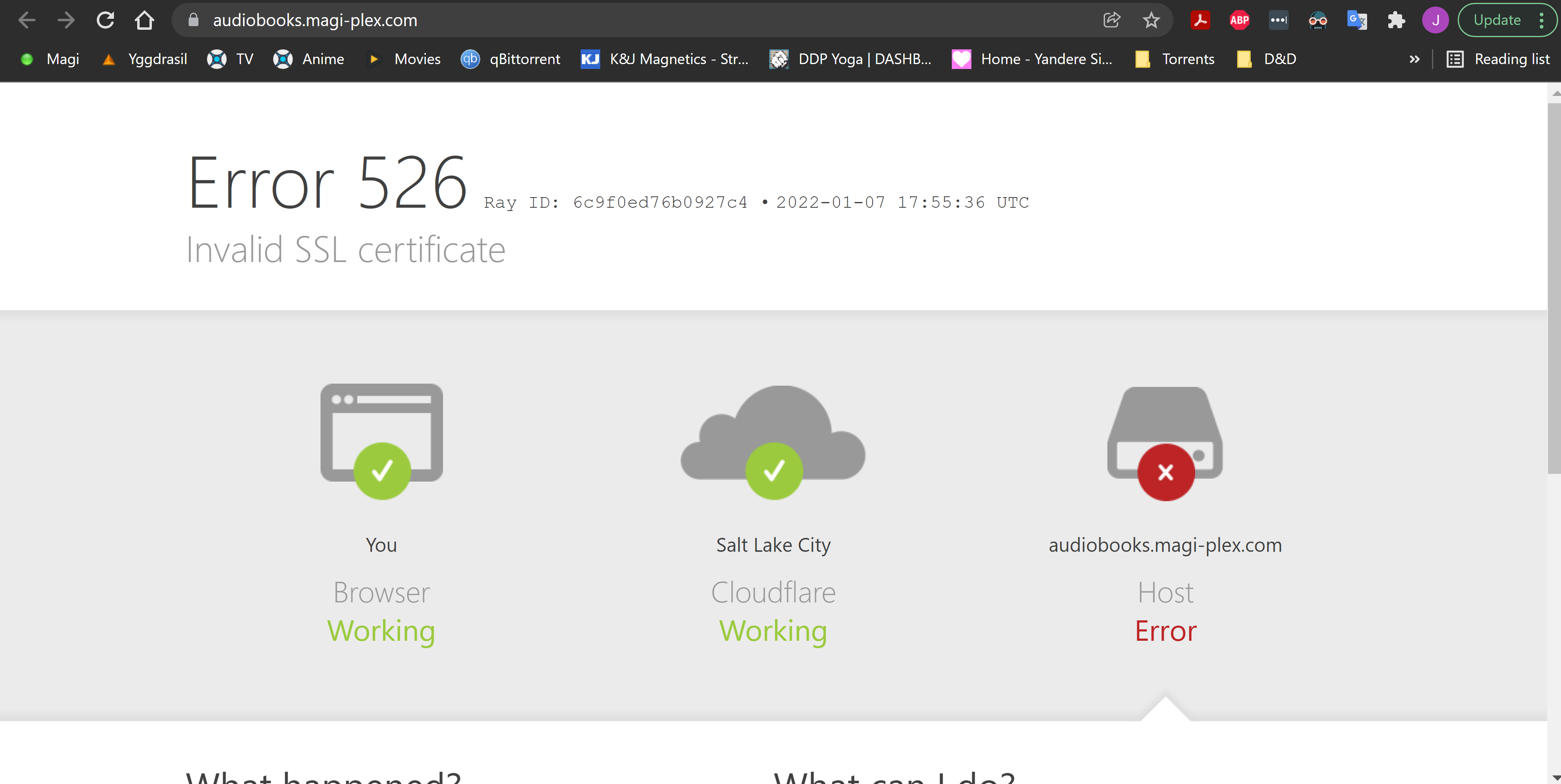

I do have both a cert and a key, and I have set them to the correct path in the code:
server
        listen 443 ssl;
        server_name audiobooks.magi-plex.com;
        access_log /var/log/nginx/audiobookshelf.access.log;
        error_log /var/log/nginx/audiobookshelf.error.log;
        ssl_certificate      /config/magi-plex.com.pem;
        ssl_certificate_key  /config/magi-plex.com.key;
        location / {
                     proxy_set_header X-Forwarded-For    $proxy_add_x_forwarded_for;
                     proxy_set_header  X-Forwarded-Proto $scheme;
                     proxy_set_header  Host              $host;
                     proxy_set_header Upgrade            $http_upgrade;
                     proxy_set_header Connection         "upgrade";
                     proxy_http_version                  1.1;
                     proxy_pass                          http://192.168.1.110:13378;
                     proxy_redirect                      http:// https://;
But I get the following when I navigate to my url:
Can you tell what I am doing wrong?
See step 3 in the link I added that take you to the digital ocean instructions. You need to add the authenticated origin stuff in your config:

-----END CERTIFICATE-----
Also, you definitely want to obfuscate your config files here, blank out the URL and the name/location of the certs (I recommend you rename them now).
Good to know, I will definitely rename them.
As for the added authenticated origin stuff, adding that had no effect on the error.
Then you'll need to reach to Cloud flare to work out what's missing and/or where to get the correct client connection certificate.
