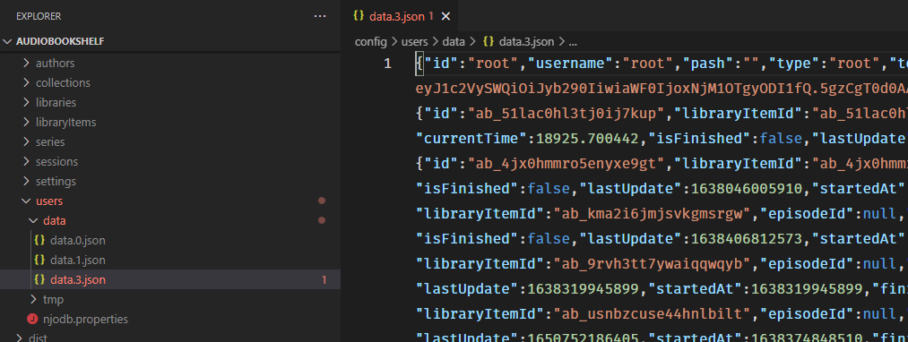

1 hour ago, AndreasLindroth said:
Hello, Quick question:
Is there a way to reset the root password when you do not know it via CLI or so?
My password manager overwrote my generated password when i created a new account so now i don't know the root password anymore..
Im still able to log in to it via auto sign-in from one of my computers so i've made an other Admin account, but would still like to recover the root password.
Best regards
Currently the only way to do this is to open up the JSON file containing the root user and manually change the password.
The JSON files are located in /config/users/data and then you need to find the data.json file that has a JSON object id root.
These are not actually valid JSON files because each line will have a JSON object for each user, so don't edit these files in anything that will auto-format on save.
Once you find the root user object the attribute after id and username is "pash". Update the value of pash to empty quotes "".
Make sure you have turned down the server for this and do a backup of that data file you are updating so if something weird happens you can just copy in the old one and try again.

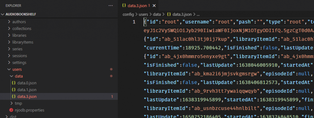

Thanks, Worked like a charm!

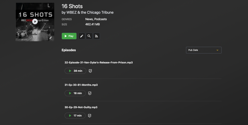

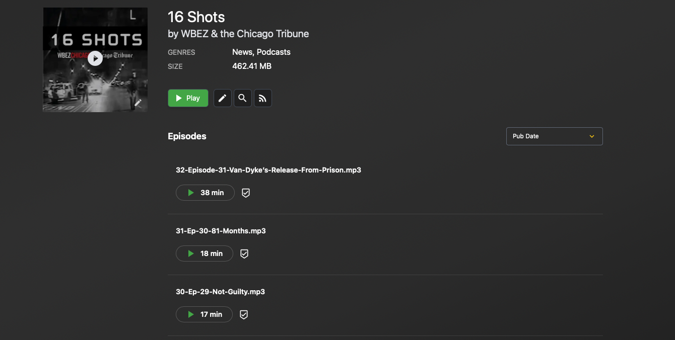

Hey advplyr, thanks for the reply.

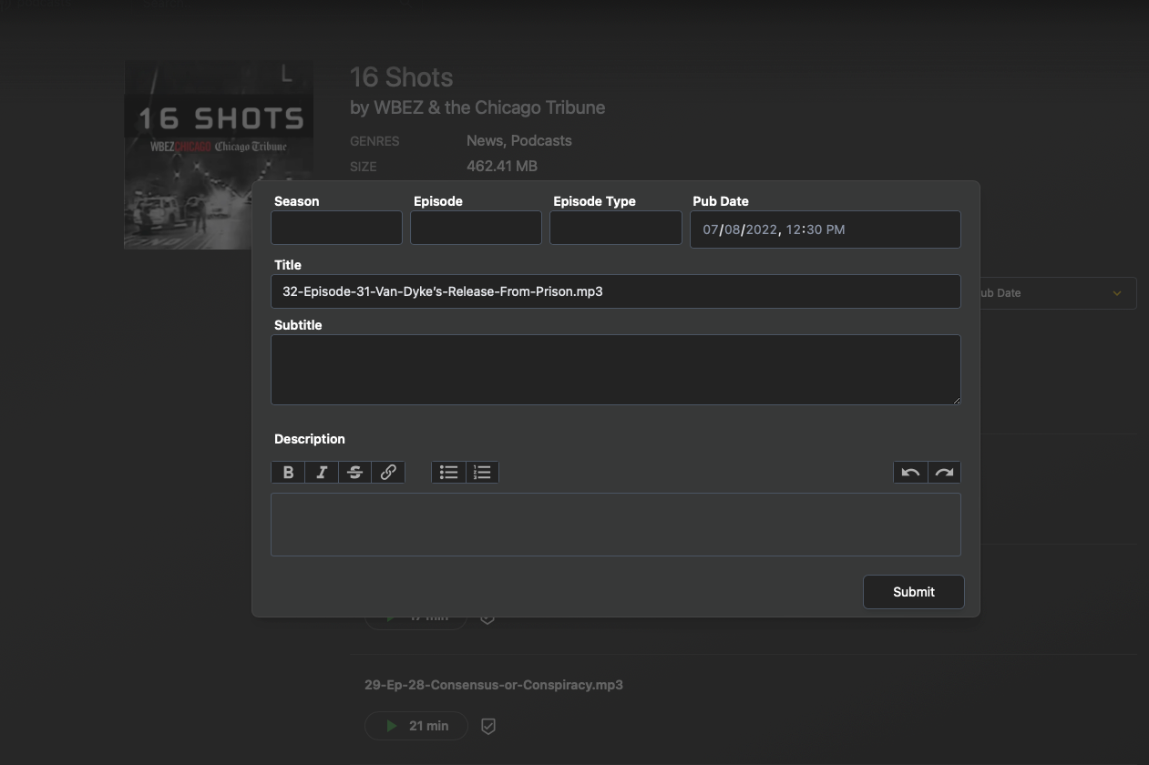

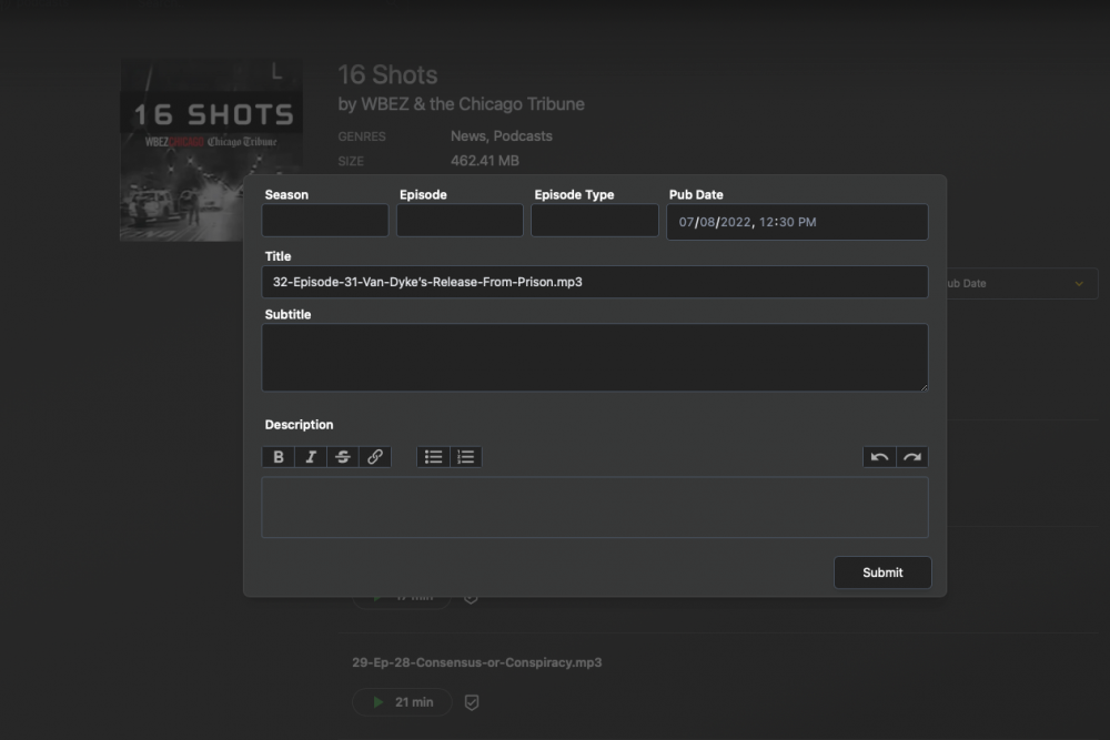

You're definitely on to something - it looks like the MP3 information isn't being filled. I'm using the app in conjunction with PodGrab (to get new episodes/download existing episodes) as has been suggested on this forum and elsewhere. It doesn't look like the metadata is populating.
I'm attaching a list view image, and a "edit" image from my system. The pub date does not appear to represent the time of the podcasts release, but rather something like when it was downloaded via pod grab, or when it was added to the audio bookshelf database.
Any ideas on how to fix this? I did a force refresh on the library, and that didn't help. It also doesn't seem to help if I match the podcast (using the iTunes source) on the last tab. The podcast in the picture has had both actions done with no effect to the sorting (nor does it populate metadata information for individual episodes in the interface).
Any suggestions on how to proceed?
Thanks!
Edited by bonmot
cropped image for clarity

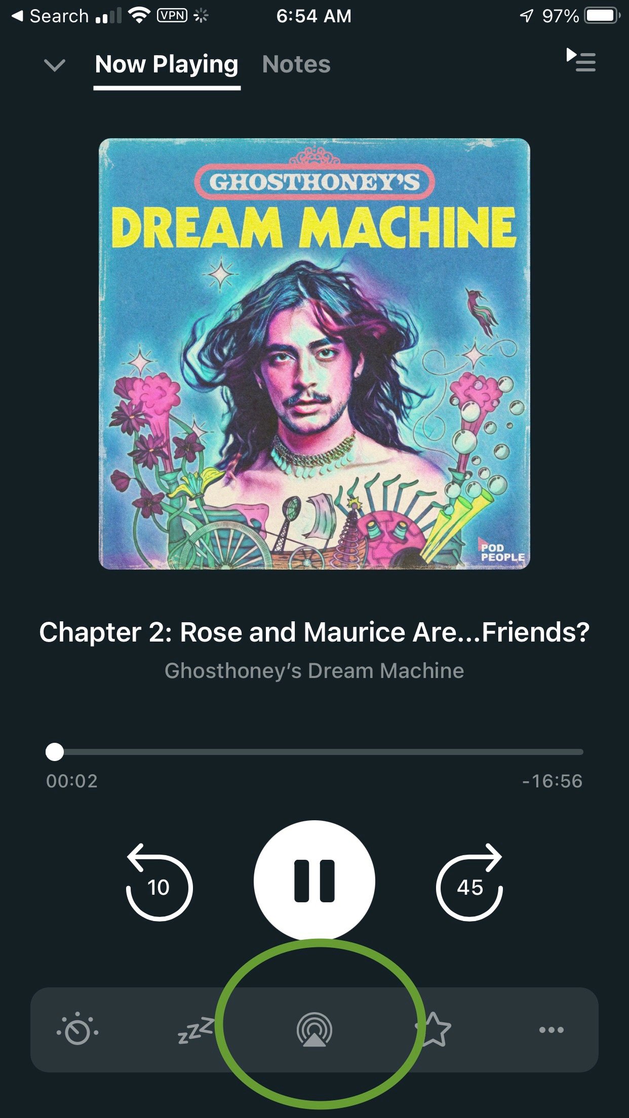

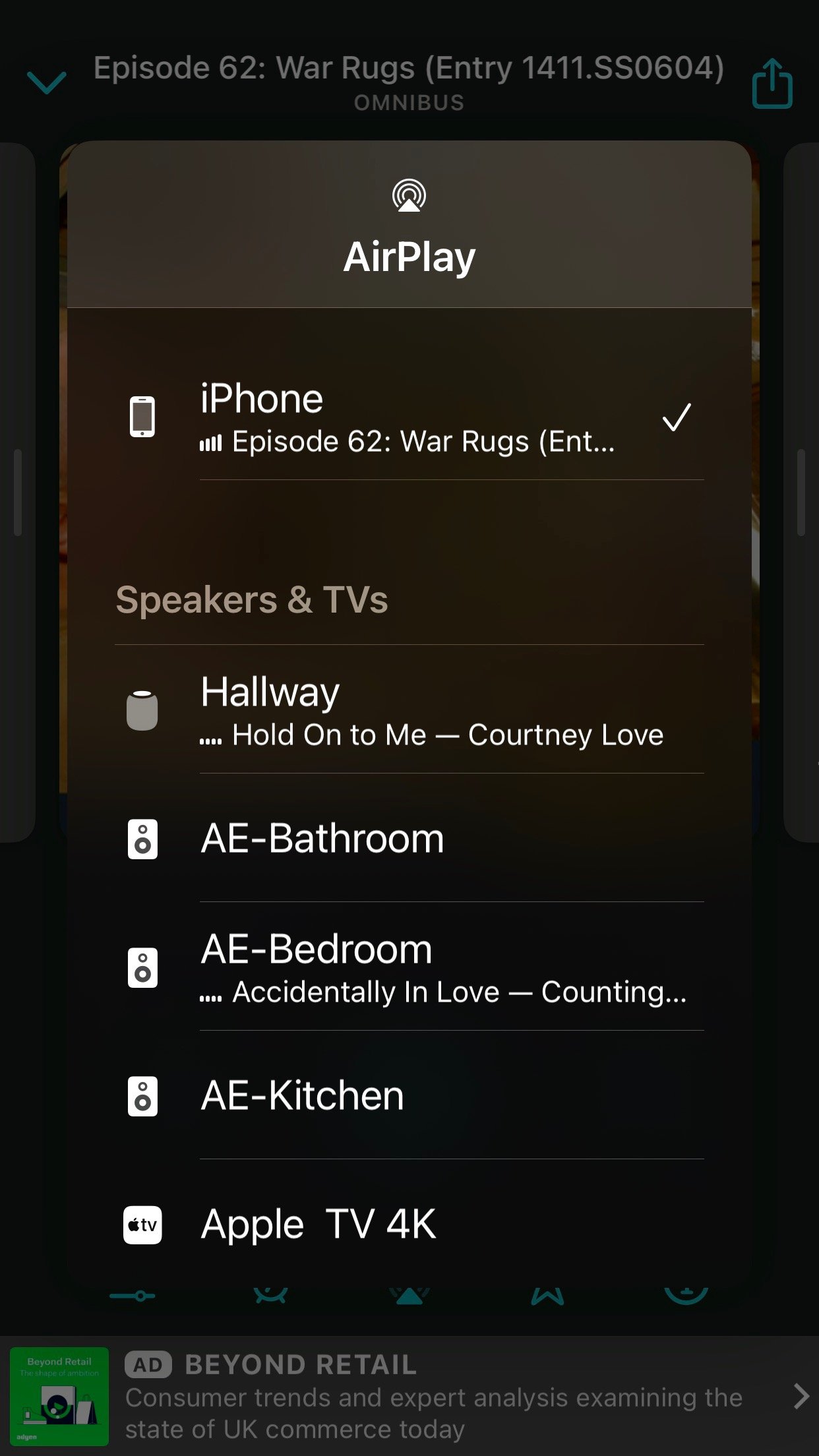

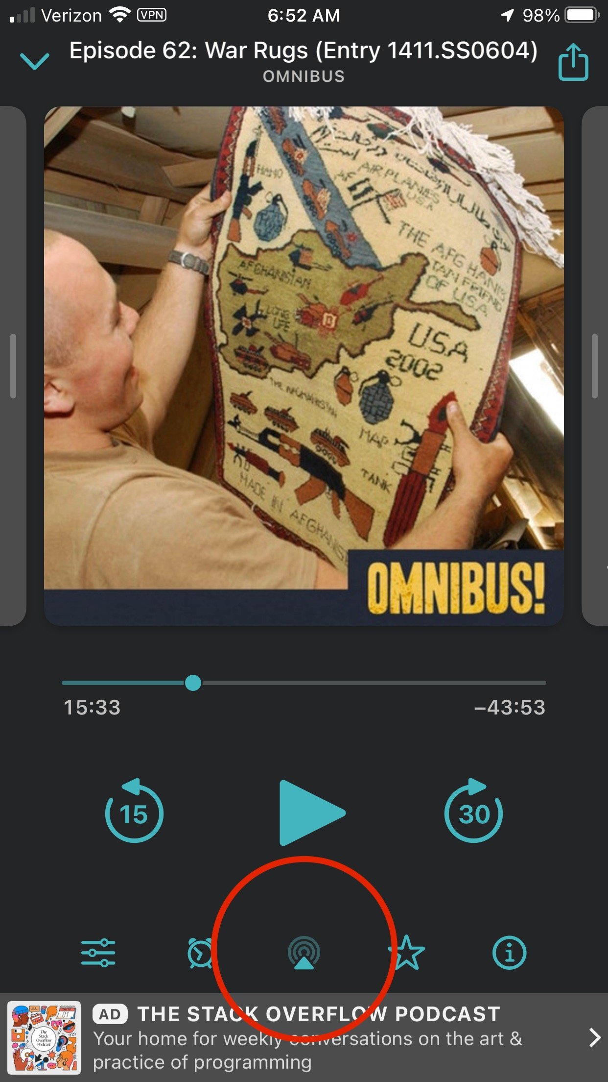

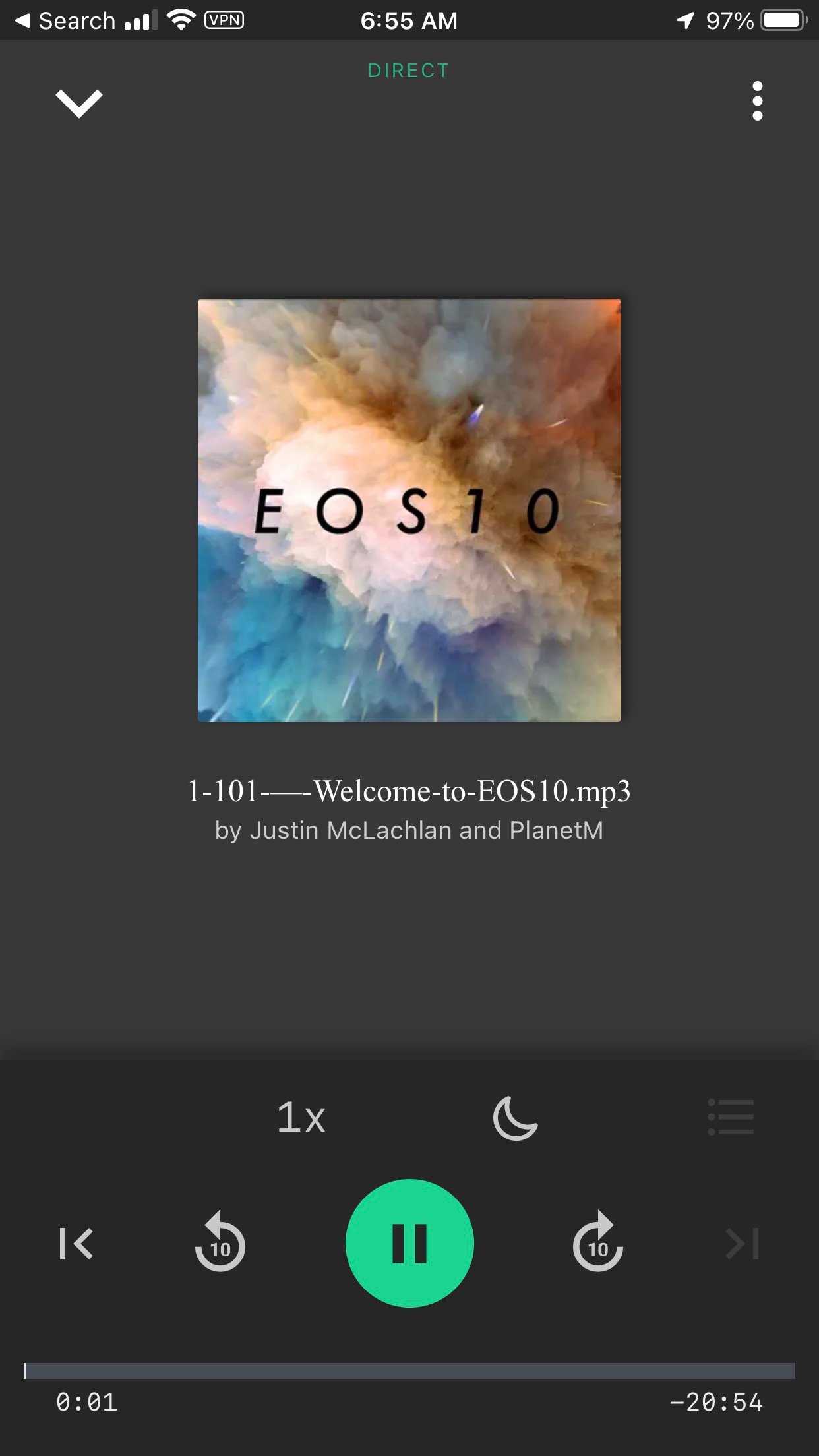

As far as audio and airplay etc, in other frequently used apps, I get the airplay icon on the now-playing screen. I'm attaching screen grabs from both Overcast and Pocket Casts. They each seem to include this interface element in a similar way. By way of contrast, I'm including a grab from the now-playing screen on the beta version of your audiobookshelf app.
I've also included a screen capture of the menu which appears when you click on the airplay icon.  If I have headphones inserted/connected via bluetooth, they also appear here. This allows the user to easily switch between audio outputs on the fly (from headphones, to iPhone speaker, to airplay target).
Something like this would be really great in Audiobookshelf!
Thanks!
Unfortunately that metadata will only be filled in if you download the episode from audiobookshelf. The match feature only matches the podcast metadata and not the individual episodes. This is something we still need to build out and I forgot about it actually since there is no github issue opened for that yet.
Thanks again for the follow up.
This is great, thanks for the overview and the screenshots. I will make note of this feature.
