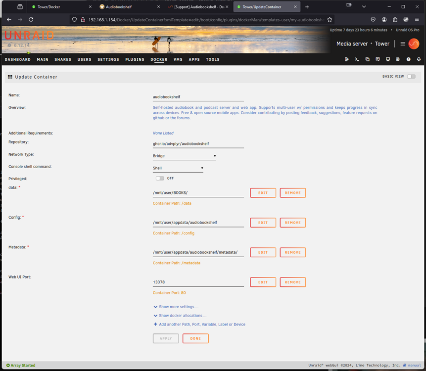

I figured it might be caching through "Previous Apps" so I cleared the template before reinstalling, I get the same "Unauthorized" error ... not sure this means the credentials are wrong or if I don't have the correct permissions..
Edit: Ok, so it looks like the audiobookshelf folders are still in both my cache drive where I run all my containers, and also in my appdata folder.. can I delete from both location safely using Krusader? Or should best practice be deleting from the cache and this change being automatically reflected in appdata due to the cache -> array configuration?
Just get "Cleanup appdata" from the appstore.. Works well for what you need.

Thanks. I ended up manually deleting the folder using Krusader - I was able to delete the folder (containing the sqlite database) on my cache drive, but I was unable to move the audiobookshelf folder from appdata to the trash, it didn't give me any any errors, but it also didn't seem to do anything, despite refreshing and trying a few times.
Reinstalling did seem to work and let me create a user and pass, so mission success!

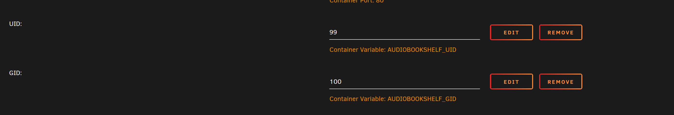

Just edit the template add two new variables like this:
Those environment variables were removed a long time ago because the preferred way to set the UID/GID is using the built-in docker options.
Oh, didn't know that. I still have it in my template and I haven't had any permissions problems.

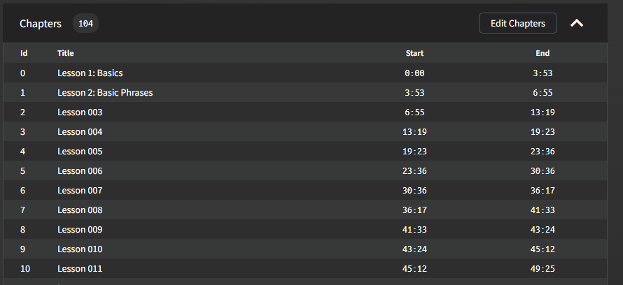

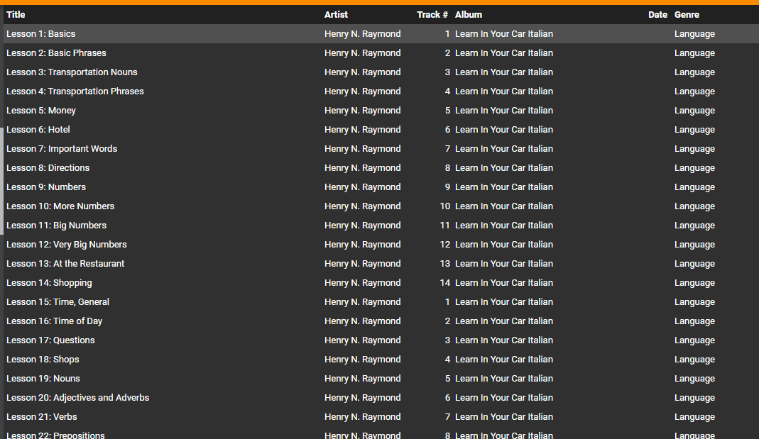

I imported an audio book that had all the tracks named "Lesson 001" "Lesson 002" etc as ID3 tags and also the filenames "Lesson 001.mp3".  I then manually changed the names of the first two chapters from within audiobookshelf.
I then changed every track title with MediaMonkey:
I deleted the book from audiobookshelf and re-scanned it, hoping that it would update the track titles, but it retains the original tracks. It even keeps the first two tracks that I renamed from within audiobookshelf, which leads me to believe that audiobookshelf is somehow keeping the metadata somewhere.
How can I force audiobookshelf to force update the chapter titles using the ID3 tags?
You are conflating chapters and tracks. Chapters are stored separately and can be edited separately. If you want to scan the chapters in as new again then press "Edit Chapters" button. Then "Remove All" chapters. Then press edit on the book again and "Re-Scan".
Scanning isn't going to overwrite your existing chapters incase you made manual edits. If you want them scanned in fresh then remove the chapters and re-scan.
Edited by advplyr
That did the trick! Thanks for clearing that up.

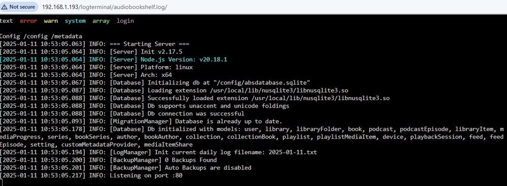

Audiobookshelf crashes every time I try to play anything.
It's extra strange because it was working a few hours ago and I didn't change anything.
I've tried this on multiple devices and restart the docker container many time. I also tried to downgrade to
advplyr/audiobookshelf:2.11.0
Each time I get the same result. When I try to play any file the GUI says
Socket failed to connect
Then the docker container crashes.
My log file pulled with "docker logs audiobookshelf" from the unraid terminal is attached.
I can't really make heads or tails of this log file. Maybe it's a database error?
errorLogs.txt
Scanning the library seems to have fixed my above problem

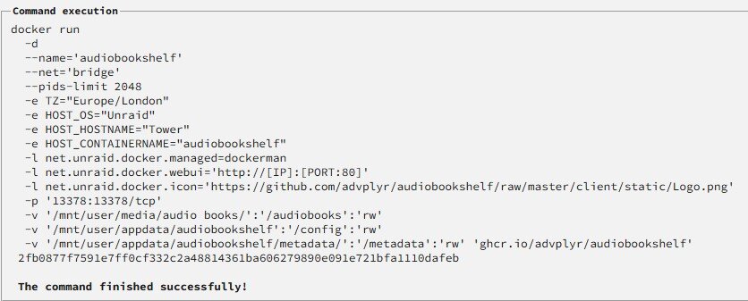

Maybe you guys could try to use the extra parameters I'm using on the container.. might be helpful.
 --memory=2G --restart=always --log-opt max-size=50m --log-opt max-file=1
