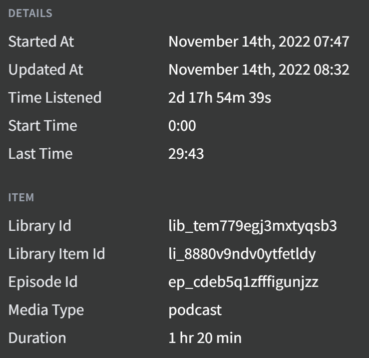

Hi, Does anyone has a clue why the listening session times are all over the place.
Picture attached for reference.
There is a bug in the iOS app. You can delete those bad sessions for now
