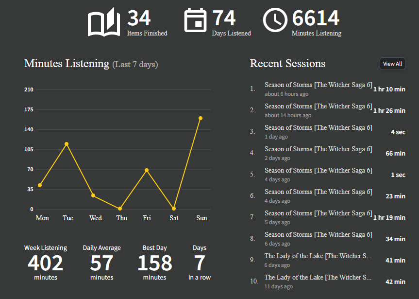

Question about the stats:
The "days listened" is that number of days I have listened to an audio book? It's a bit confusing right next to minutes listened - clearly the two numbers aren't related.

Not sure about donations yet. You are correct on the number of days you have listened and I agree it is confusing. I'm open to suggestions on stats. I built the page off of a design that was requested: https://github.com/advplyr/audiobookshelf/discussions/167
I'm perfectly happy with the stats.. I'm sure "days listened" is relevant to.. someone. :D
