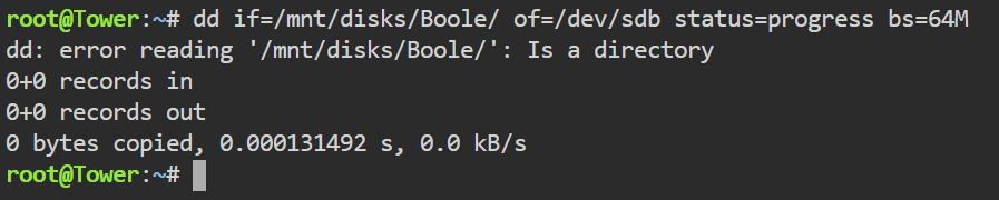

yes i did, and the "best" way i found is going into console and doing.
dd if=/path/to/input of=/path/to/output status=progress
Although i'm not sure i need to mount them as they are seen in /dev, right ?
That won't work, it will clone the disk but it won't be usable in Unraid, you can use rsync instead for example.
how so ?
How should id do it then ? (using cli for instance )
I get this :
(i did not fiddle with shares just yet)
