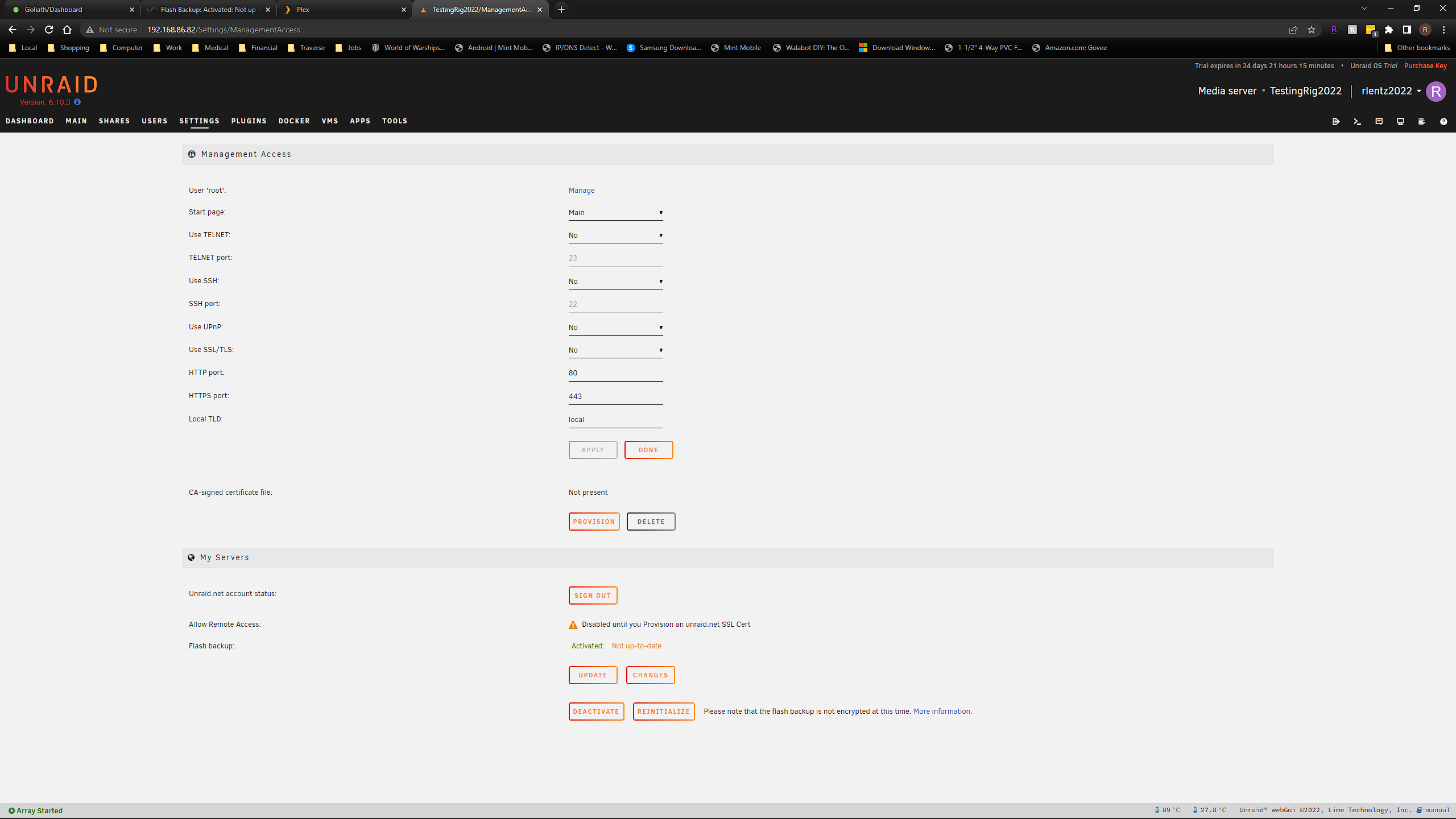

August 20, 20224 yr Here is the info you requested. I just had to redo the server cause I was trying to learn how to set up a VPN and I messed it so bad that I had to start from scratch. That's the only reason I have provision a cert yet.. Pinging backup.unraid.net [34.223.119.253] with 32 bytes of data: Request timed out. Request timed out. Request timed out. Request timed out. Ping statistics for 34.223.119.253: Packets: Sent = 4, Received = 0, Lost = 4 (100% loss), testingrig2022-diagnostics-20220820-0039.zip Edited August 20, 20224 yr by rlentz2022
