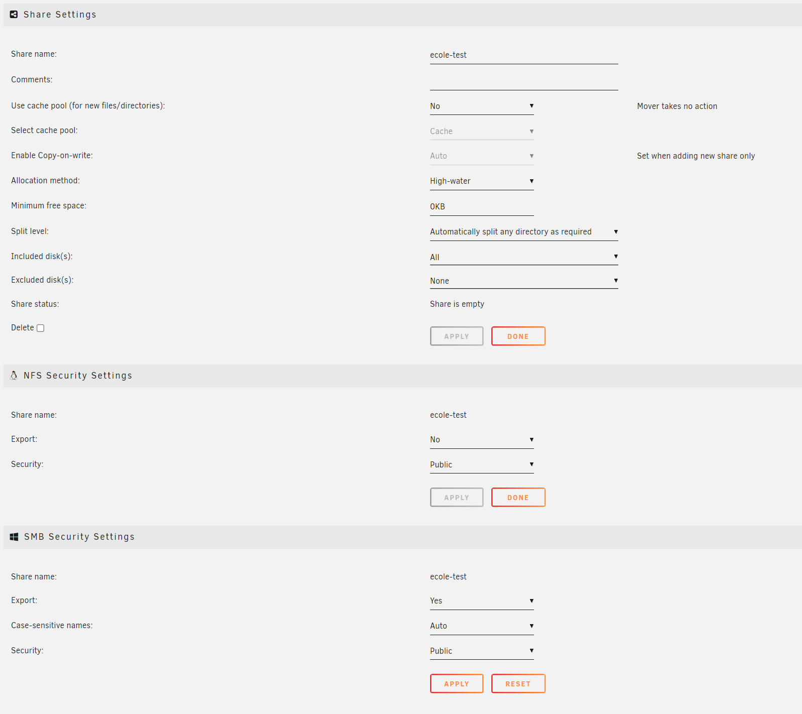

en gros il serait top de pouvoir faire un snapshot d'un répertoire comme dans la video a 37 minutes mes je suis pas sur que sa soit possible si le répertoire se trouve sur plusieur disque dur

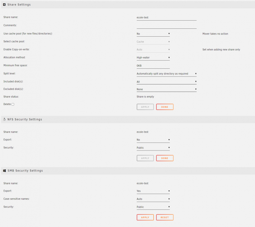

J'ai ma réponce
1155479629_Capturedcrande2022-02-0518-49-11.thumb.png.54246b050b467db9b5ef19cf710494e0.png1733667994_Capturedcrande2022-02-0518-47-34.thumb.png.e6fa0371b76135438f0c8f87abada95d.png

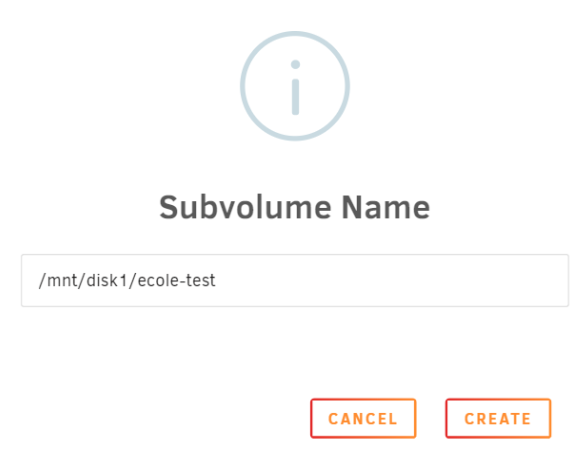

Not with array drives as snapshot has to be  on the same volume, but would work for a pool with muliple drives.
@vmlinuz
You can manually create as a subvolume on a drive and it will be a share. You can then snapshot the files on that drive.
Then goto shares and export, select disks you have created subvol on or leave as all if you added to all 5.
Now you can setup a snapshot for each drives folder, but this will only be a snapshot of the files on that disk not the sum of all disks.
oui il faut donc crée un partage sur un seul disque dur sinon sa fonctionne pas et la on a trouver les limite de Unraid on peut pas tout avoir 🤔
Not perfect but you can try this.
Create subvol disk1->ecole-test
Create subvol disk2->ecole-test
file 1 and 2 on disk 1
file 3 and 4 on disk 2
snapshot disk1/ecole-test => disk1/ecole-back1 will have spans of 1 and 2.
snapshot disk2/ecole-test => disk2/ecole-back2 will jave snaps of 3 and 4.

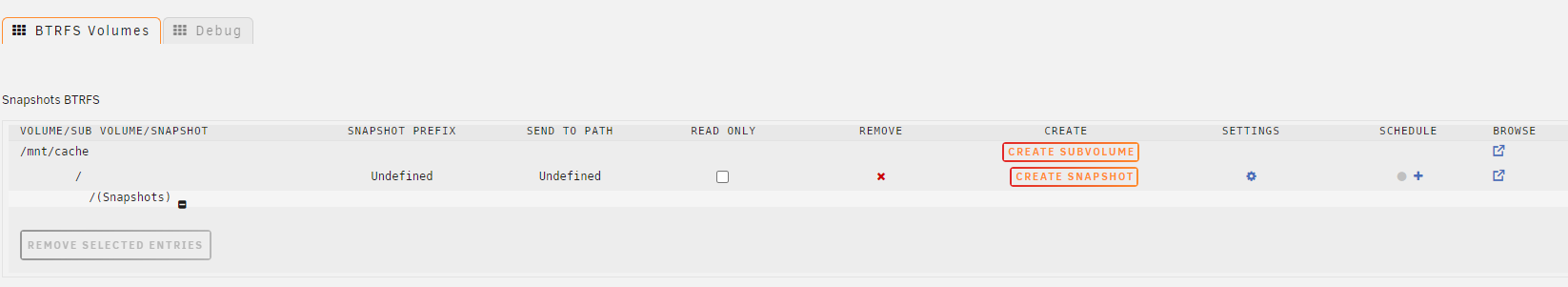

Great plugin, I started on a fresh Unraid installation and the plugin shows:
Is that by design? Shouldn't there be any snapshots by default because there is no subvolume after a fresh format?
Thanks
That view is correct, root of a drive was added to allow snap of whole drive. Snap shots will show under that I can look to hide if no snapshots.

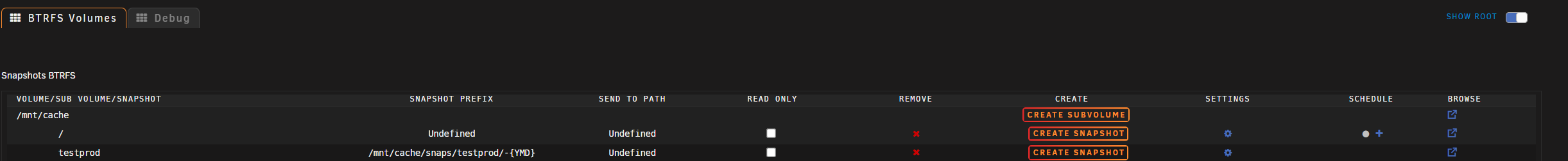

Small thing I noticed as a brand new user, "show root" was toggled by on default, but had to be untoggle/retoggle to get root to actually show
Thanks will look into that default should not show route paths, so likely the slider is incorrect for new installs.
Fixed in 2022.03.31
