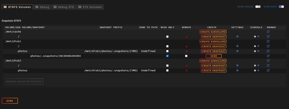

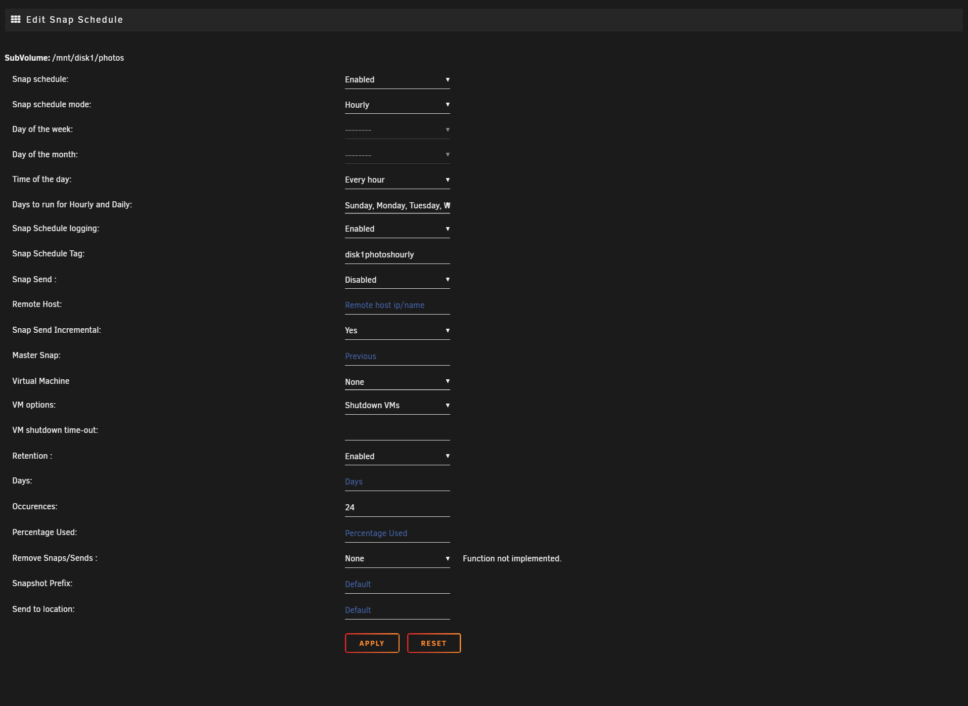

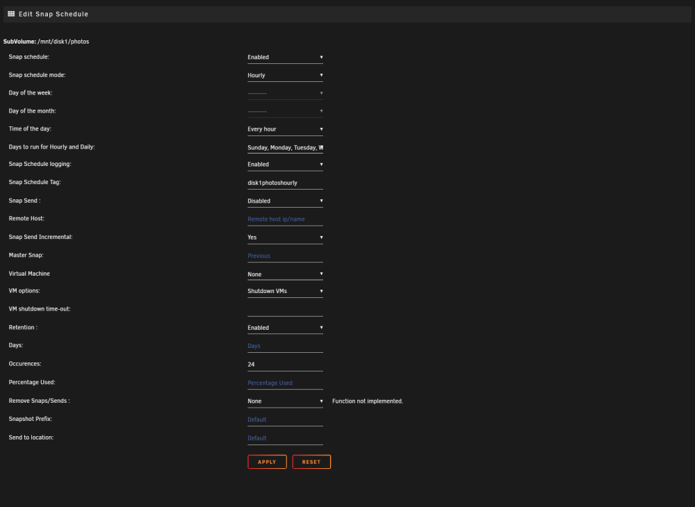

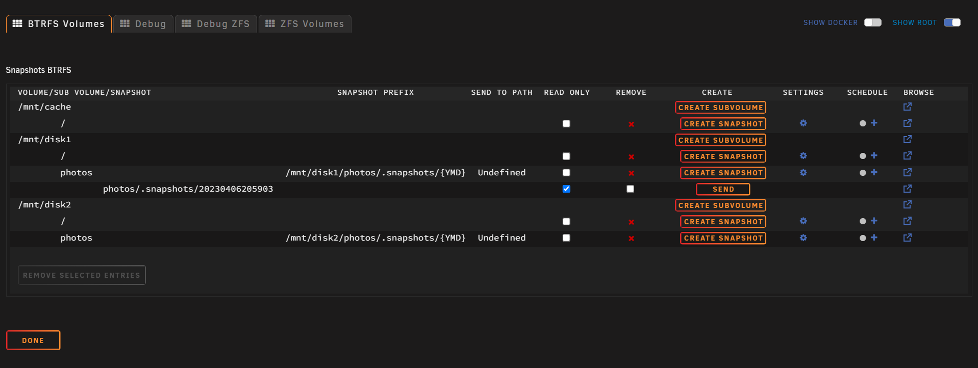

Now I've almost given up. I can still not get schedules to work. I've attached three images to this post. In the first image you can see that I can manually make a snapshot. In the second image you can see the settings I'm using when I try to set up a schedule for the folder "/mnt/disk1/photos". In the third image you just see the blank screen I get when I click "Apply" on the form from the second image.
Does anybody have a guess at what I'm doing wrong?

I will look to see if I can recreate.

I can confirm this is a 6.12 issue, I will look at a fix. The issue does not show on 6.11 and schedules created on 6.11 show ok on 6.12 when upgraded. Seems to be an issue when no schedules are defined and related to PHP8 changes in 6.12
On 4/7/2023 at 8:16 PM, Larsen1 said:
6.12-rc2, but I had the problem with 6.11 aswell
as a work around create the following file this will allow you to create a schedule.
nano  /tmp/snapshots/config/subvolsch.cfg
    "\/mnt\/disk2\/photos": [],
    "\/mnt\/disk1\/photos": []
It seems like it worked. Thank you!
But I'm still pretty sure that it didn't work when I was on 6.11.5 because I upgraded to 6.12.0-rc2 in hope that that would work.

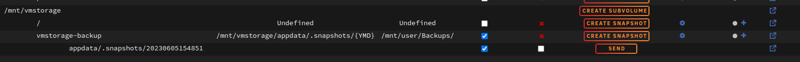

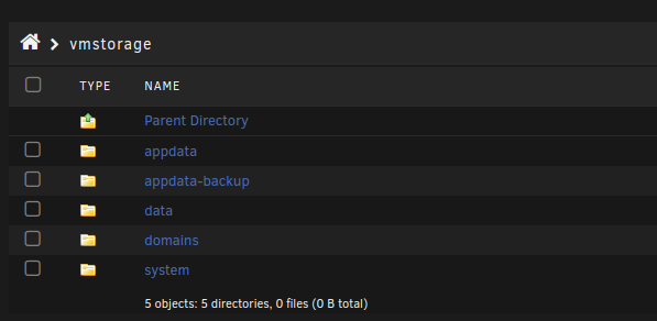

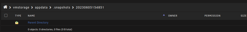

I cannot get this working. Every time I take a snapshot the folder is empty.
And here is the directory:
What I am trying to do, I moved my appdata for the dockers to this drive that is BTRFS, I would like to take a snapshot of it and then use duplicati to backup the snapshot online.

What is in vmstorage-backup?
Nothing, it was the directory I was putting the snapshots in. So I feel I am messing up. These are my current directories on vmstorage. I am wanting to get rid of appdata-backup in favor of the snapshots. Currently, I have the script that stops all containers, then copies the appdata directory into the appdata-backup and then restarts them all. But I read somewhere that taking a snapshot is better and you can leave the dockers running.
So right now, I just want to snapshot the appdata directory.
The folder needs to be a subvolume so create a test subvolume put some data in it and test a snapshot.
Can I not make an existing folder a subvolume?
Nope.
You would need to rename dir and copy/move the data back to a new subvolume with the orginal name. Make sure you have a backup.
