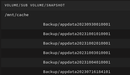

@SimonF - Thanks for the great plugin!  I was able to fairly easily get it to do most of what I want.  I did have to go research elsewhere how to setup the keyfiles for remote ssh access, but that was fairly easy to figure out and get working as well.

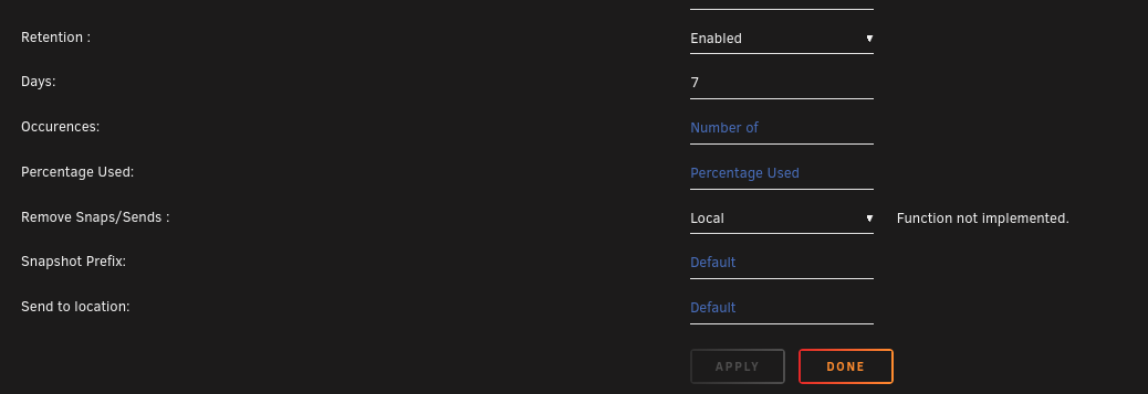

I'm stuck on retention for the remote server though.  I understand that this is still not implemented on the source server side, but is there something I'm missing to be able to apply retention directly on the remote server?  What are other people doing to cleanup old snapshots that have been sent from another server?
In my case, I have a BTRFS pool with some subvols on a 'source' UnRaid server that I want to keep ~3 days worth of hourly snapshots on, and then send them to a BTRFS pool on a 'remote' UnRaid server.  The remote server should then keep 14 days of the hourly snapshots, but then also take daily and weekly snapshots, each with their own retention periods.  So, I have one schedule on the source server to create the hourly snaps, tag them with 'Hourly' and send them to the remote server.  Then, I have two schedules on the remote server to create the daily and weekly snaps, tagged as 'Daily' and 'Weekly'.  I think the retention of the hourly snaps on the source server is working ok, and I think retention of the daily and weekly snaps on the remote server is working ok as well, but what should I do about the hourly snaps on the remote server?  I tried creating an hourly schedule on the remote server, basically just to handle the retention cleanup, but it doesn't seem like it considers the received incremental snaps when it applies retention.  Is this just a bug, or does it purposely exclude snaps that were received from a different server?
So, again... what are other people doing for retention on 'remote' servers?  Maybe custom scripts, or am I just missing something obvious?

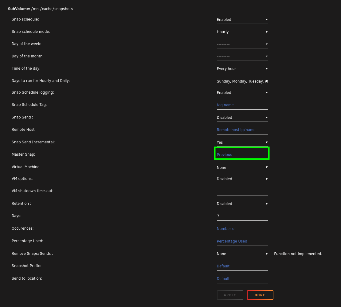

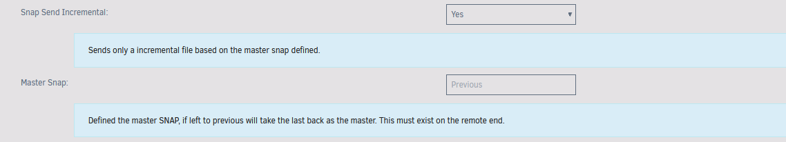

  1. When I create snapshot on a schedule, the default value is to base it on the previous snap.
    What am I supposed to do if I want to only keep a week worth of hourly snapshots, with auto-deletion of older snaps? Won't deleting a previous snap destroy data?
Snapshots are not "based on a previous snap" they are a Copy on Write copy of a subvolume. For the purpose of restoration there are no dependencies between them, (all of the data sharing stuff is handled by the CoW nature of the FS). You can delete any of them without effecting the others . The only time the relationship of one snapshot to another really matters is when sending them between filesystems using btrfs send. With send if the snapshot to be transferred has an ancestor snapshot at both the source and destination then the amount of data to transfer is reduced (highly simplified explanation).

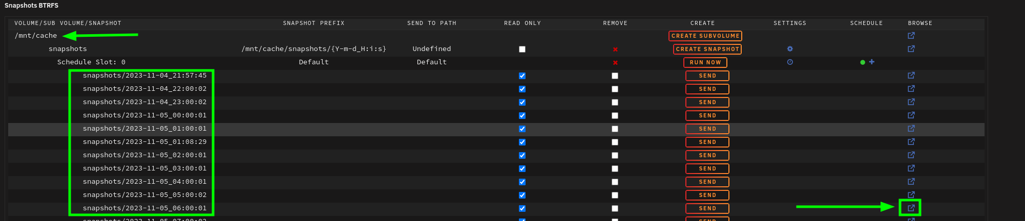

  1. How does one roll back a file, folder, or a state of the file system on unraid? We don't have Timeshift or other cool GUI stuff like that of which I am aware. Can it be done while the server is running? Do I need to mount the disk on a live boot and use Timeshift?
There is not really a simple gui way to handle rolling back. Snapshots appear as just folders on the filesystem. The simplest way of restoring is to delete the live file or folder and then copy it from a snapshot directory back into place. If you are restoring entire subvolumes (the whole snapshot), there are fancier ways of doing it involving deleting the subvolume and then creating a writable snapshot of the snapshot you want to restore, but copying is the easiest to understand. Since snapshotting only involves data disks an not the OS there is no need to bring the server down when restoring something. At most you might have to stop some VM or Docker containers that are using data from the subvolume to be restored.
But what is the meaning of this then? Does it apply only to remote sends ?
It only applies to "incremental sends". I believe its purpose is to define the "Master Snaptshot" (not a btrfs term) against which the snapshot will be compare to do an incremental send. This is a feature of the plugin vs something to do with the underlying fs.
 P.S. If you expand the help text (either globally or by clicking on labels like Master Snap) you will find some useful information.

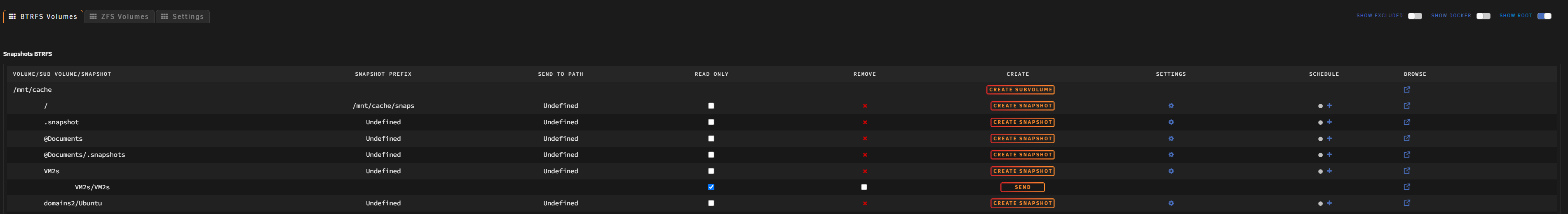

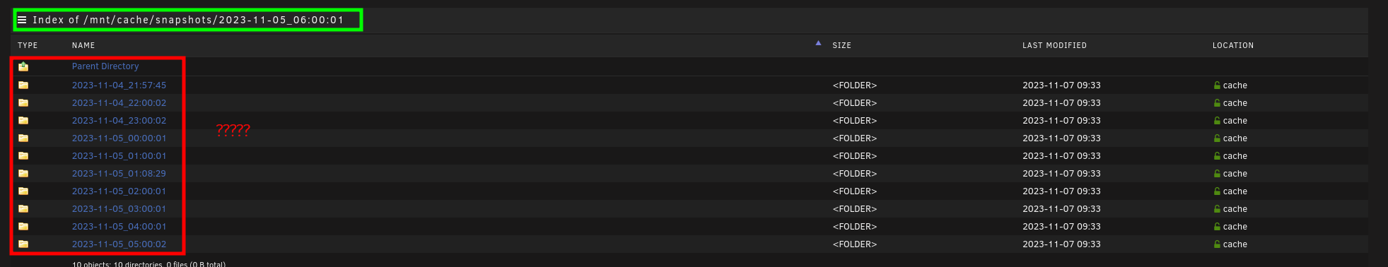

@primeval_god, I don't know what I am missing, but when I navigate to the individual snapshot folders (either from the plugin, or from the terminal) all I see is all the preceding snapshots, but no file...
I really don't get how it works!
I am confused as to what you are doing / trying to do here. From the snapshot plugin it looks like you have a subvolume called "snapshots" on /mnt/cache and you have several snapshots of that subvolume, which are located under within that subvolume at /mnt/cache/snapshots/2023-*

I dont think that the Snapshot plugin GUI allows you to take snapshots of the root volume of the drive (the entire drive). At least thats what your screenshot shows, and i have never done it myself. Personally I have replaced my share folders (every top level folder on the drive) with subvolumes (which look like folders but can be snapshotted), and then i take snapshots of each share at different schedules.
It looks like what you have done is create a subvolume called "snapshots" and then snapshotted that empty subvolume a bunch of times, saving the snapshots into the subvolume. Since the subvolume called snapshots is empty, each snapshot of it will be empty as well (note that snapshots do not recurse through subvolumes so the snapshots in the base subvolume will not appear in subsequent snapshots of the base subvolume).

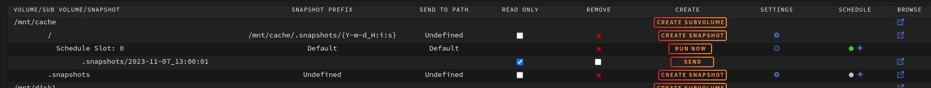

An option to snap the root was added, but you need to toggle the root to show with the switch. It was at a user request.

Will the snapshot exclude the snapshot folder? (I don't want to snapshot the snapshot!)

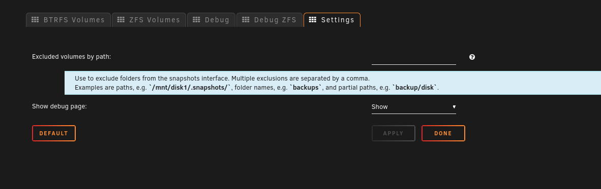

That is an exclude for the display not the snap process

To save time, I activated the "root" option and it works fine
I created a subvolume called ".snapshot"
For some reason, it works... The full volume gets it's snapshot inside the .snapshot subvolume, and the .snapshot folder exists inside the snapshot, but is empty... maybe there is something in Unraid or BTRFS that keeps it from making snapshots of snapshots... can't tell!

That is the expected behavior per my previous comment. It is the way btrfs snapshots work for nested subvolumes.
