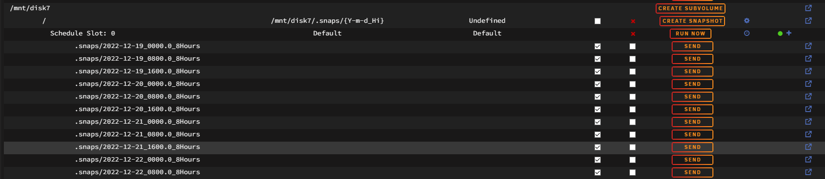

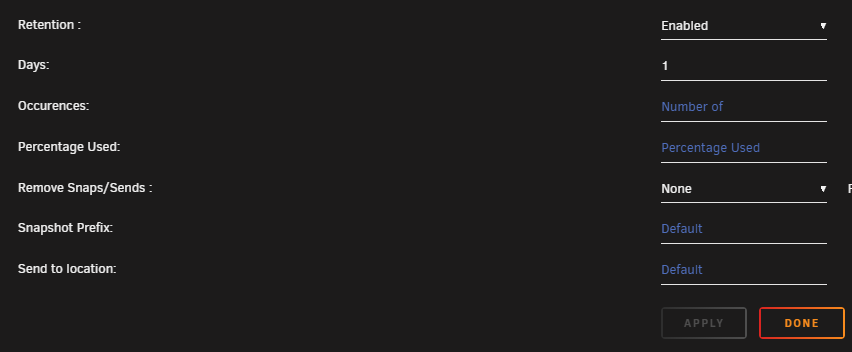

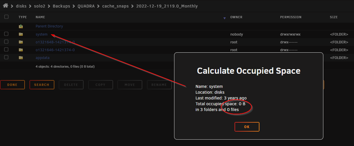

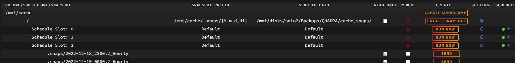

Hi @SimonF, Is there a GitHUB repo for this plugin if one wanted to contribute?
Also my snapshots do not seem to be pruning by the retention settings for me, is there a known issue there? let me know what details I can provide.
Lastly, I am sure I am misunderstanding but I am having issues sending snapshots as well, so far just local from Cache root to a spinny disk. I get the subfolder but the contents are all wonky. Once again let me know what details I can provide.
Folders, but no data in the sent subvolume, it is like an incremental but options are set for full.

37 minutes ago, neurocis said:
GitHUB repo
https://github.com/SimonFair/Snapshots I have started working on some of TexasUnraid's suggestions, but have not publish them to the repo as yet but will be in branch Enhancement Release

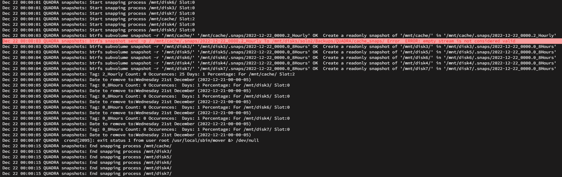

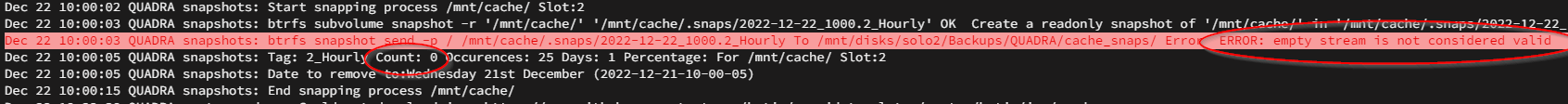

No issues that I know of.
Do you get log messages like:
Dec 22 22:12:37 computenode snapshots: Start snapping process /mnt/cache/vol Slot:0
Dec 22 22:12:37 computenode snapshots: btrfs subvolume snapshot -r '/mnt/cache/vol' '/mnt/cache/snaps/vol-202212222212.Hourly' OK  Create a readonly snapshot of '/mnt/cache/vol' in '/mnt/cache/snaps/vol-202212222212.Hourly'
Dec 22 22:12:37 computenode snapshots: Tag: Hourly Count: 6 Occurences: 5 Days: 2 Percentage:0 For /mnt/cache/vol Slot:0
Dec 22 22:12:37 computenode snapshots: Date to remove to:Tuesday 20th December (2022-12-20-22-12-37)
Dec 22 22:12:37 computenode snapshots: Deleted Snapshot by occurence: /mnt/cache/snaps/vol-202212211900.Hourly
Dec 22 22:12:47 computenode snapshots: End snapping process /mnt/cache/vol
Dec 22 22:12:47 computenode snapshots: Manual Run '/mnt/cache/vol' 0
Will need to check the send process. When have you specified the send location?
Edited by SimonF
So yes, this is interesting:
Send location is specified as the default:

Addn'l detail from Disks
I will review the repo tonight probably, see what I can contribute.
Thanks!
Will  need to check root path was added after the initial build as to see if that is used. I was all subvol based initially.

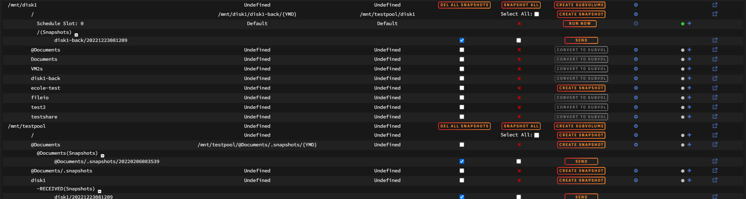

Looks like the process is running ok for me, but not checked data as yet. Ignore the additional buttons there are not in the current release.
Dec 23 08:12:09 computenode snapshots: Start snapping process /mnt/disk1/ Slot:0
Dec 23 08:12:09 computenode snapshots: btrfs subvolume snapshot -r '/mnt/disk1/' '/mnt/disk1/disk1-back/20221223081209' OK  Create a readonly snapshot of '/mnt/disk1/' in '/mnt/disk1/disk1-back/20221223081209'
Dec 23 08:12:10 computenode snapshots: btrfs snapshot send /mnt/disk1/disk1-back/20221223081209 To /mnt/testpool/disk1 OK  At subvol 20221223081209
Dec 23 08:12:10 computenode snapshots: Tag:  Count: 0 Occurences:  Days: 1 Percentage: For /mnt/disk1/ Slot:0
Dec 23 08:12:10 computenode snapshots: Date to remove to:Thursday 22nd December (2022-12-22-08-12-10)
Dec 23 08:12:20 computenode snapshots: End snapping process /mnt/disk1/
Dec 23 08:12:20 computenode snapshots: Manual Run '/mnt/disk1/' 0
Latest code is here but not released. https://github.com/SimonFair/Snapshots/tree/Enhancement_release

Hi, just checking in on Snapshot Send functionality and issue I had reported earlier. Let me know if I can assist in any way! Thanks!
Can you try to run from command line.
btrfs send {snapshotname} | btrfs receive {destination file}

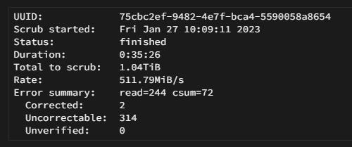

Succeeded on my one unraid box, failed on the other. digging deeper:
Looks like I have some corruption to address & maybe some memory to test as it is a RAID 1. Tried to send on my other unraid, worked a charm, so alright then, not the plugin's fault there.
