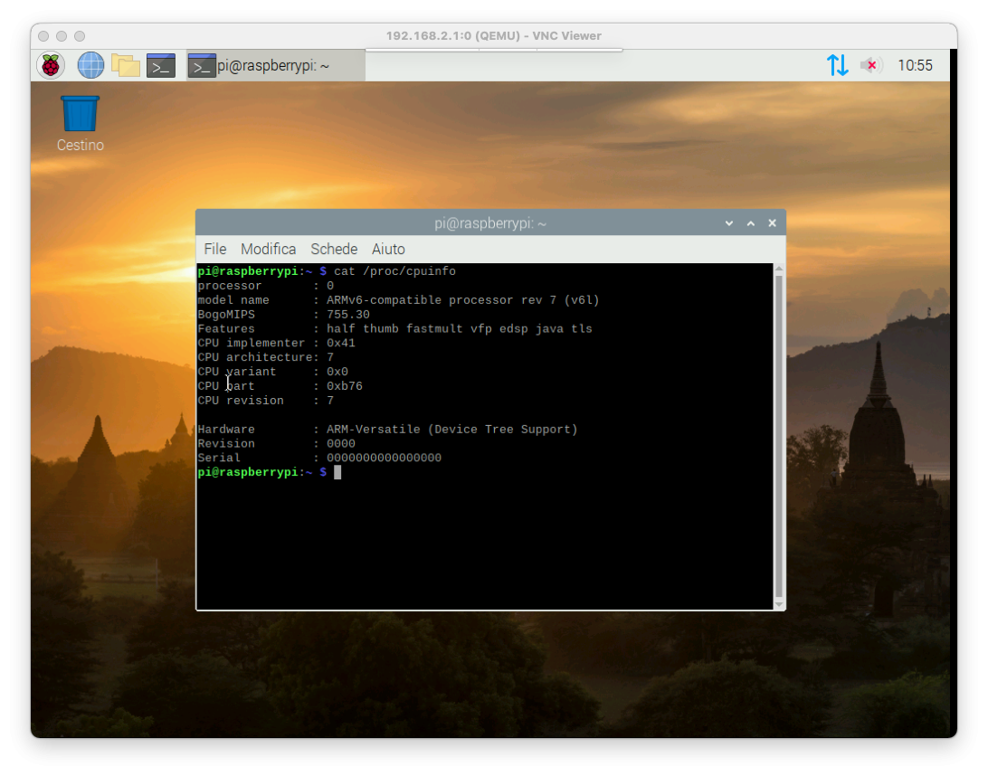

This is a basic template I'm using to boot the image:
<domain type='qemu'>
  <name>rpi</name>
  <uuid>removed</uuid>
  <memory unit='KiB'>262144</memory>
  <currentMemory unit='KiB'>262144</currentMemory>
  <vcpu placement='static'>1</vcpu>
  <os>
    <type arch='armv7l' machine='versatilepb'>hvm</type>
    <kernel>/media/6TB/rasp/kernel-qemu-4.19.50-buster</kernel>
    <cmdline>root=/dev/sda2 rootfstype=ext4 rw</cmdline>
    <dtb>/media/6TB/rasp/versatile-pb-buster.dtb</dtb>
    <boot dev='hd'/>
  </os>
  <cpu mode='custom' match='exact' check='none'>
    <model fallback='forbid'>arm1176</model>
  </cpu>
  <clock offset='utc'/>
  <on_crash>destroy</on_crash>
  <devices>
    <emulator>/usr/bin/qemu-system-arm</emulator>
      <source file='/media/6TB/rasp/2020-02-13-raspbian-buster.img'/>
      <backingStore/>
      <target dev='sda' bus='scsi'/>
    </disk>
    <controller type='scsi' index='0' model='lsilogic'>
      <address type='pci' domain='0x0000' bus='0x00' slot='0x01' function='0x0'/>
    </controller>
    <interface type='bridge'>
      <mac address='52:54:00:ed:eb:c7'/>
      <source bridge='virbr0'/>
      <model type='virtio'/>
    </interface>
    <graphics type='vnc' port='-1' autoport='yes' websocket='-1' listen='0.0.0.0' keymap='en-us'>
    </graphics>
    <audio id='1' type='none'/>
    <video>
      <model type='cirrus' vram='16384' heads='1' primary='yes'/>
    </video>
  </devices>
</domain>
kernel/dtb are downloaded from here:
https://github.com/dhruvvyas90/qemu-rpi-kernel
Raspbian buster downloaded from here:
https://downloads.raspberrypi.org/raspbian/images/raspbian-2020-02-14/
For now it's giving a kernel panic on shutdown..need to investigate: seemed to be solved with qemu 6.1-RC, but it seems it's not the case..
I'm only able to use arm1176 with qemu-system-arm (32 bit), maybe related to the custom kernel.

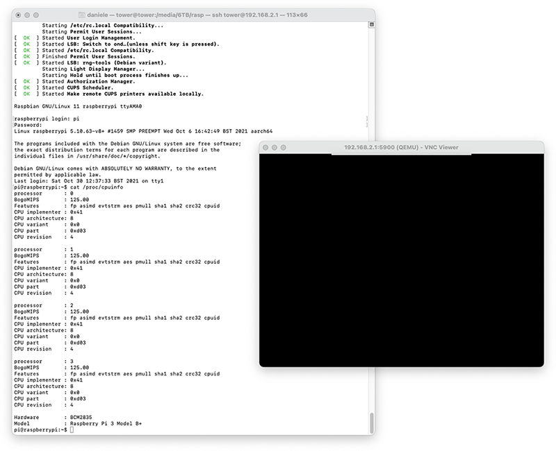

I also tried the emulation of machine type raspi3 (pi 3b+) instead of the versatilepb (-M raspi3 in qemu), but this has a lot of limits because we wont have a pci bus, so we can't attach things to it, including a simple vga...
It is able to boot, also the latest raspios bullseye (2021-10-30), but only "in a console mode", with serial device configured with stdio (or mon:stdio).
Moreover qemu is not happy if the sd (note that we need sd bus, as no controller is available because of lacking of pci bus) img is not 2 Gb or a power of it, so the 2021-10-30-raspios-bullseye-armhf.img must be resized to 4 Gb (2021-10-30-raspios-bullseye-armhf.img is 3,7 Gb) with:
qemu-img resize 2021-10-30-raspios-bullseye-armhf.img 4G
Full qemu command:
qemu-system-aarch64 -M raspi3 -append "rw earlyprintk loglevel=8 console=ttyAMA0,115200 dwc_otg.lpm_enable=0 root=/dev/mmcblk0p2 rootdelay=1" -dtb bcm2710-rpi-3-b-plus.dtb -sd 2021-10-30-raspios-bullseye-armhf.img -kernel kernel8.img -m 1G -smp 4 -serial stdio -usb -device usb-mouse -device usb-kbd -vnc 192.168.2.1:0
Adding -vnc ip:port and connecting to it results only in a black screen (expected).
Porting that qemu command to libvirt is quite a mess, and maybe not supported at all for raspi3.
For all these reasons, the versatilepb machine type is advised instead of the raspi one(s).
In this case, for native emulation (-M raspiX), one can extract the kernel and the dtb files from the official img with the following commands:
losetup -f --show -P 2021-10-30-raspios-bullseye-armhf.img
mount /dev/loop0p1 /path/to/mount/point
cp /path/to/mount/point/kernel* ./
cp /path/to/mount/point/*.dtb ./
Following screenshot refers to the output of qemu command issued through ssh:
Edited by ghost82

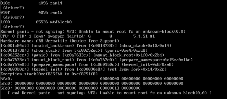

Hello @ghost82 - I was following your template, but I am unable to boot the VM, I always get the following. Any idea why? I used the template you provided, just modified local path to img/kernel/dtb files.
9 hours ago, stefan.tomko said:
Any idea why?
Error is related to kernel, unable to mount root fs.
Check that you downloaded kernel from the source I provided (you need a custom kernel).
Check that the image you downloaded is able to be mounted by the custom kernel.
Check that you have the cmdline in your xml to specify root path, fs type and rw mode.
Thanks. I got confused with kernel/dtb files. I fixed that accordingly and now it is booting up. Many thanks!
