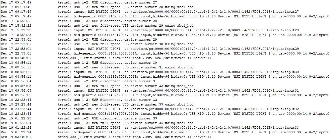

after about a month running the server crashes for the second time. Not reachable and on display output only black screen.
I found something in the Logs maybe that could help.
thank you
I´ve done that after my first crash and that are the syslog messages before the server wasn´t reachable anymore.
I rebooted the system yesterday shall i post the diagnostics nevertheless?
