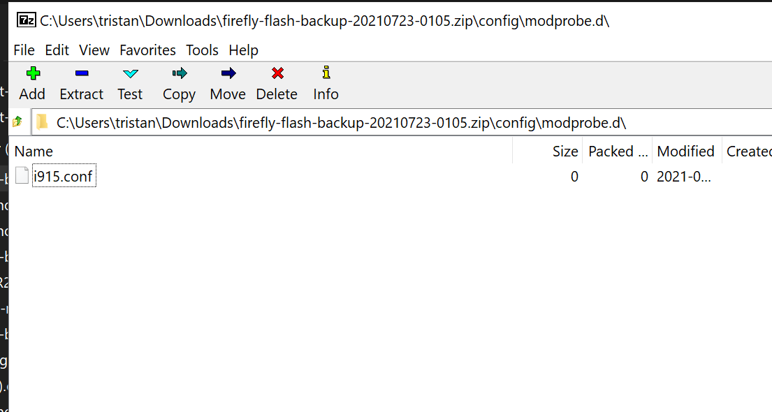

6.9.2 Backup file, let me know if you want it shared, but the following should answer your queries. Go is empty, and i do have the touch file. I haven't tried 6.10 but I understand the touch operation is no longer required.

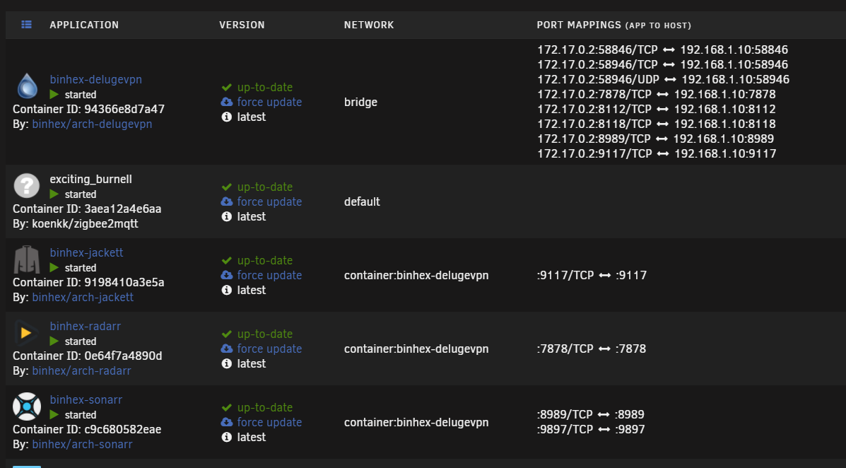

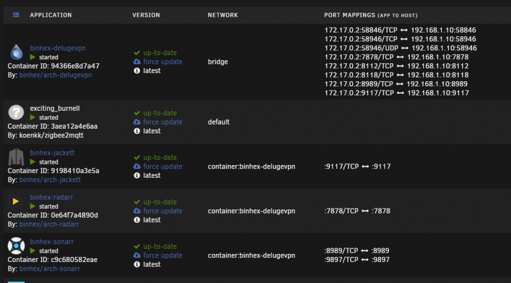

Is there a way to have my torrent docker use my VPN but not the server?
You set their network as the delugevpn container and pipe all the ports for the apps you want passed through by forwarding the ports in deluge contaner config. There are guides out there.
