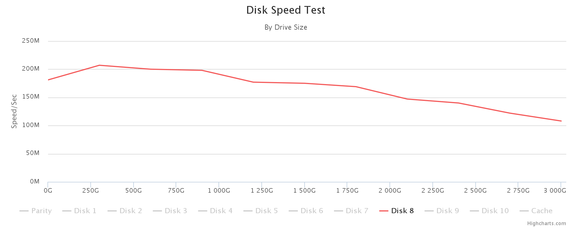

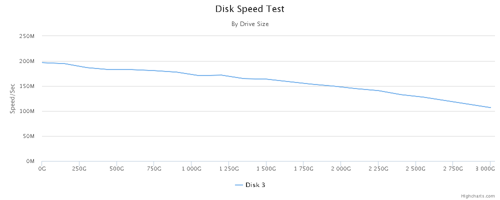

Those results are disk dependent, especially because the disks are tested one at a time, any sata2 or above controller should be capable of 250MB/s+.
Few disks on the market today can do 200MB/s+, these two are the exception from the ones I have, mostly WD green drives.

The controller isn't the issue -- as I noted earlier, you're only going to see speeds in the 200MB/s range with either 1TB/platter drives that are spinning at 7200rpm or with drives with higher areal densities.
The two drives Johnnie posted the reports for are a 3TB Toshiba with 1TB platters and 7200rpm speed; and the Seagate 8TB SMR drive, which spins slower (5900rpm) but has a higher areal density of 1.33TB/platter.    Note that NEITHER of these are rated at 200MB/s speeds (and in fact don't quite hit it) -- the Seagate specs show a max sustained rate of 190MB/s and the Toshiba shows 170MB/s ... but I'm not surprised the initial burst is close to 200MB/s  (this likely includes transfers from the drive's buffer).
If your drives have lower density and/or lower rpm, they won't get nearly as high.  e.g. all of my newer drives are WD Reds, which tend to top out at ~ 150MB/s for the 3 & 4 TB versions (which have 1TB platters) or a bit over 170MB/s for the 5 & 6TB units (which have 1.2TB platters).
