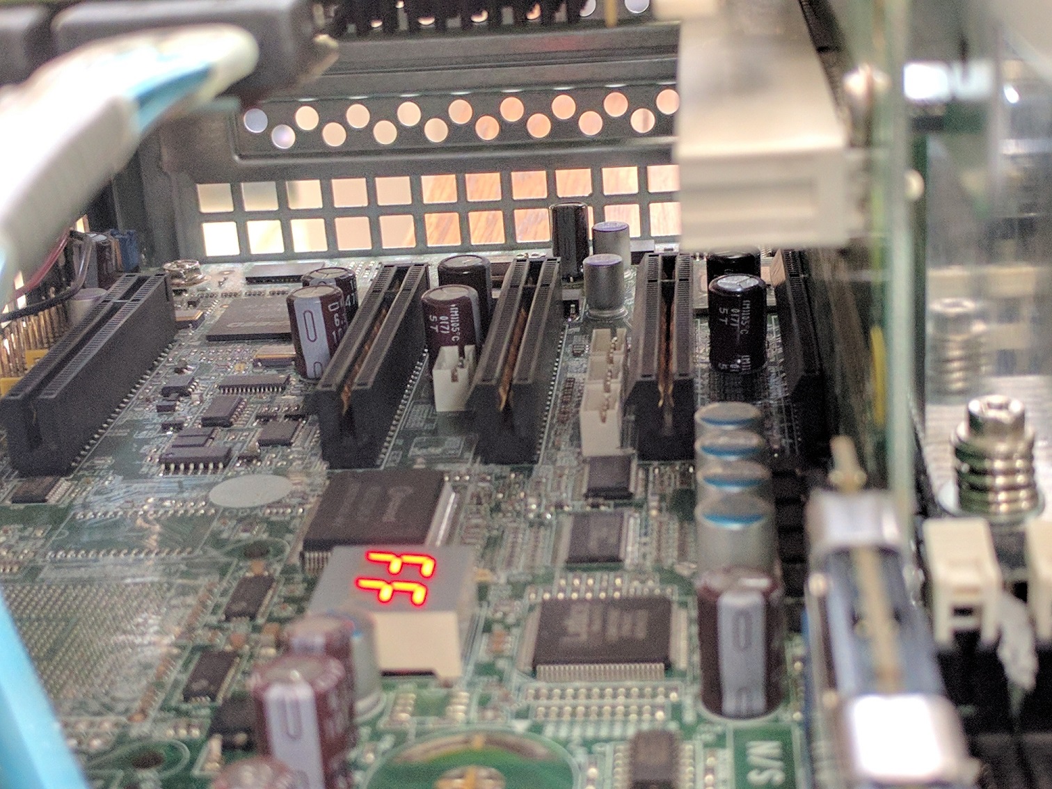

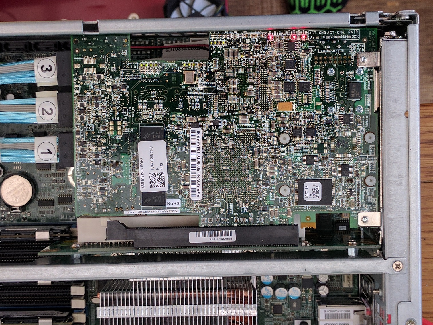

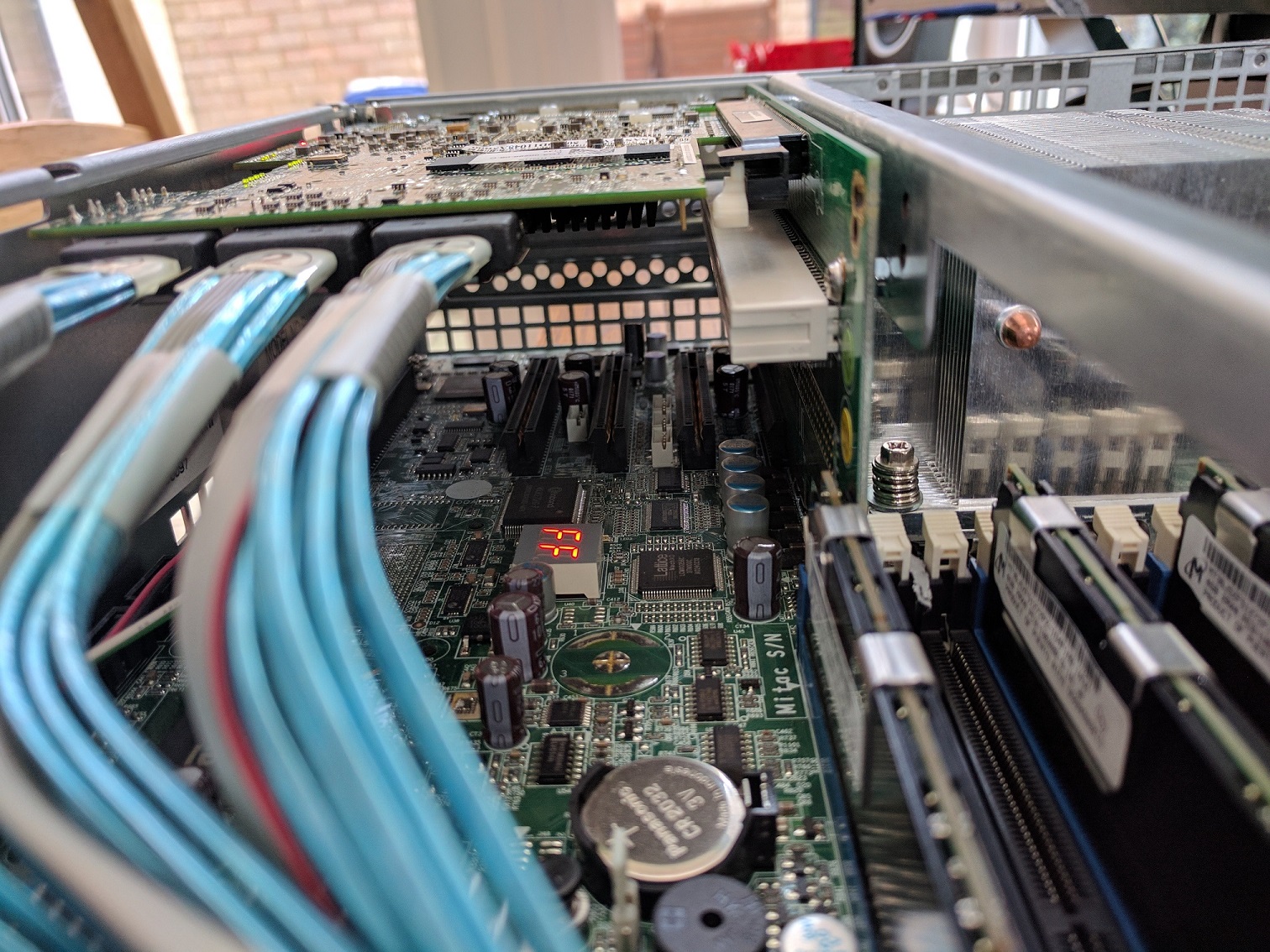

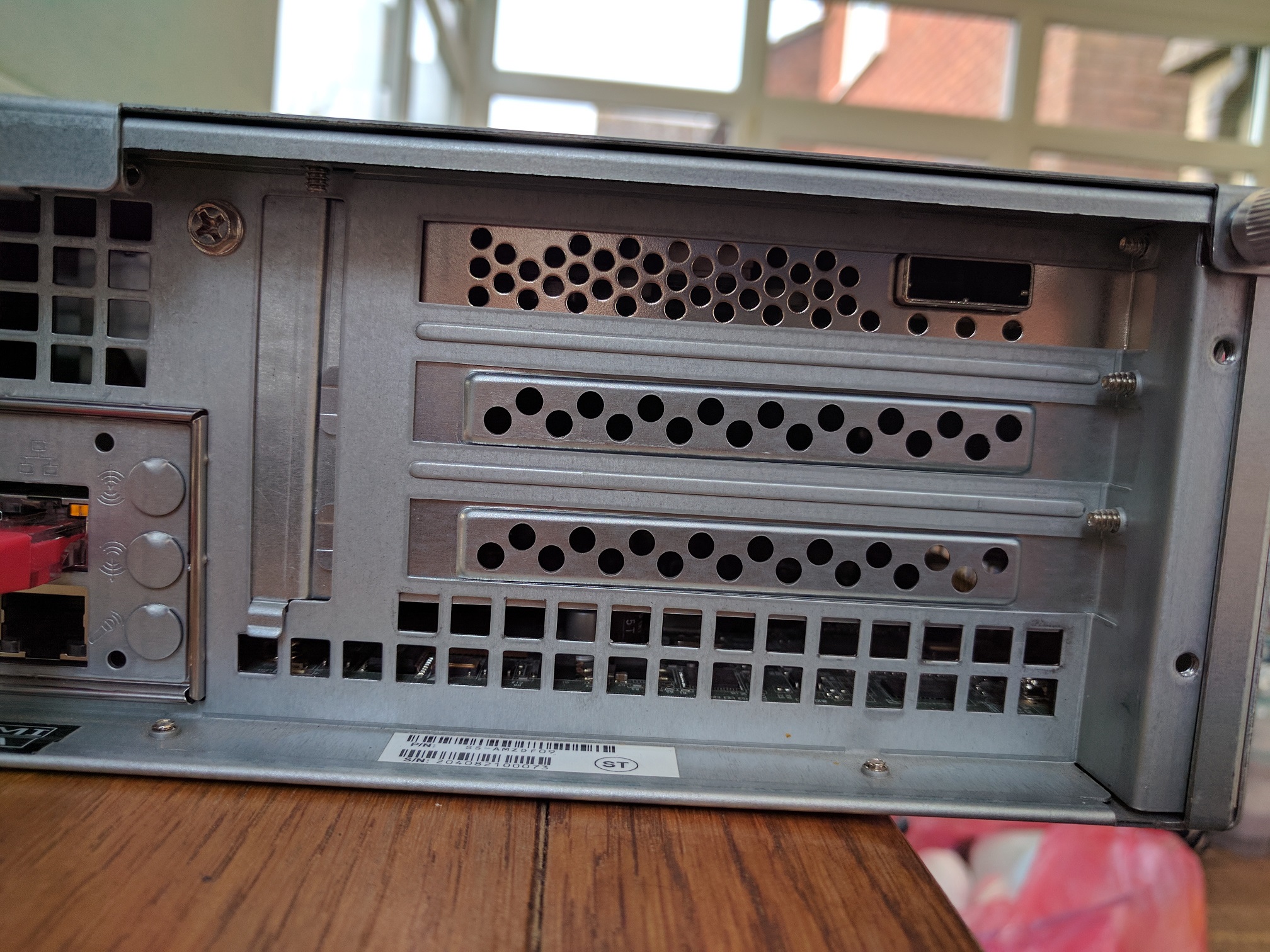

Are you able to put up some pics of the PCIE arrangement in the case?

I'll grab a couple this evening and stick them up - thank you

Looks like the Chenbro case is designed for use with a riser rather than vertical slots
After somehow posting them in completely the wrong forum, here are the images of the chassis / PICe area.
Looking at the maintenance guide on the rear of the lid, the rear window in the full-height configuration (as I have here) was an optional extra part.
I've emailed Chenbro to find out the part number for the original window, but given it's pretty old, I'm not holding out much luck.
