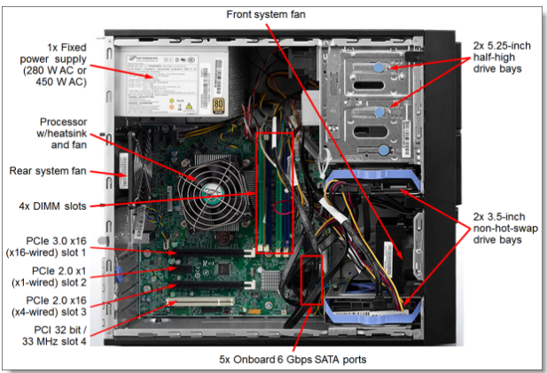

I had a look at your case.
Check the space where the controller shall fit.
You should have some extra space for the cable plugs in the rear of the card!
Maybe a card with vertical connectors is a better choice.
I don't know if there is an original LSI 9211-8i with vertical connectors - like the H200.
Edited by Fireball3

I attached a picture of my little old TS140 for your review.

How many 3.5" drives can you accomodate in that case max?
2x 5.25" half height? ==> 2x3.5" ?
2x 3.5" drive bays in the lower portion
At the moment I can't see the need for an additional controller...
