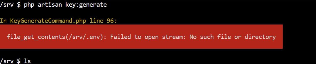

December 23, 20223 yr @SmartPhoneLover How to generate new APP_KEY ? i installed but used password from Vaultwarden and cant to change to new APP_KEY
