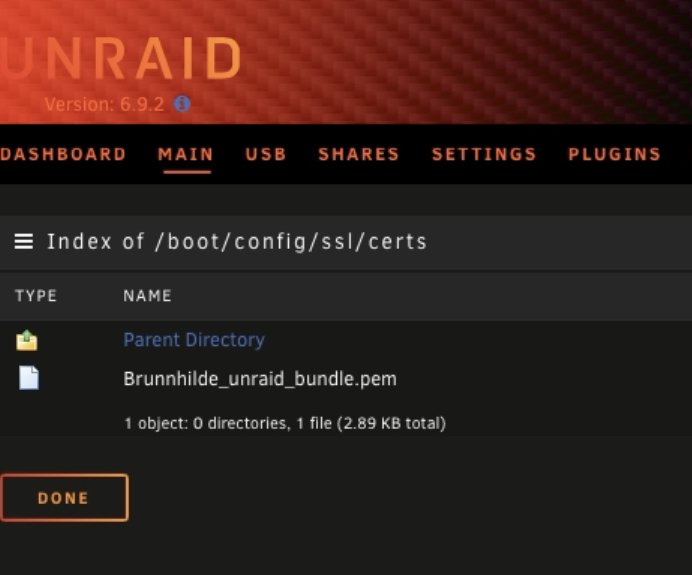

I haven't upgraded to the RC but your post raised a question for me. Does unRAID have to generate the self signed certificate? My server is using a certificate generated by my pfsense router. Just wondering if I’m going to have to replace it eventually?
Yep! Unraid automatically creates self-signed certs if you don't provide a cert that matches servername.localTLD. More info here:
   https://wiki.unraid.net/Manual/Security#Securing_webGui_connections_.28SSL.29
So I just need to change the file name?
Custom certificate - with no possibility of My Servers Remote Access
Same as above, but the certificate file name should be /boot/config/ssl/certs/certificate_bundle.pem
Set Use SSL/TLS to Auto
servername_unraid_bundle.pem is best. For backwards compatibility we do support certificate_bundle.pem too, but that could change in the future.
