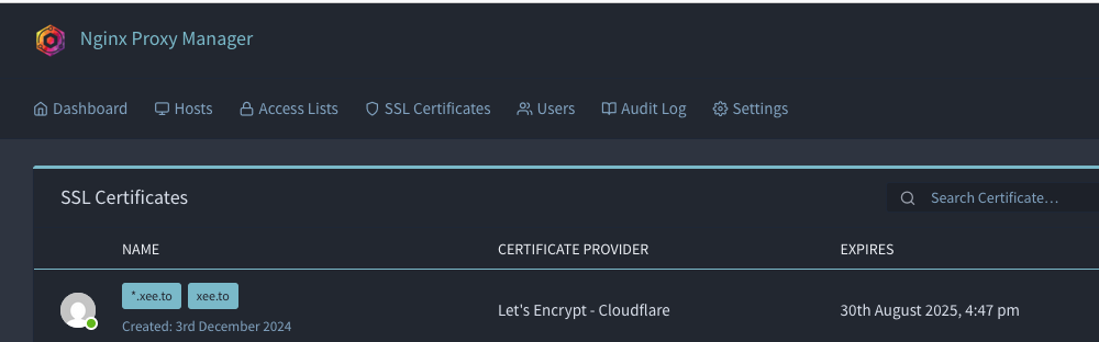

June 30, 20251 yr You can definitely get wildcard certs with LE as I have a couple for two domains, in addition to also managing unique ones for some services/machines.NGINX Proxy Manager provides a suitable UI for managing this, and scripts on Unraid via User Scripts plugin handles copying/installing certs onto machines where I don't want to rely only on NPM's reverse proxy and automatic HTTPS. Like installing certs onto my Unraid machines themselves. Edited June 30, 20251 yr by Espressomatic
