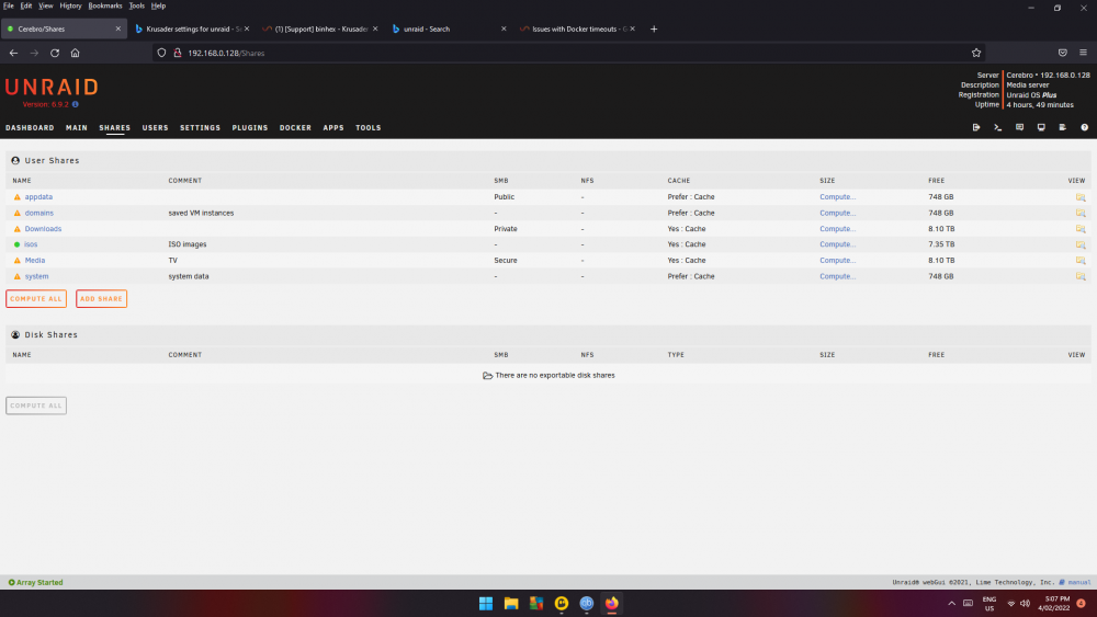

Probably unrelated but do you really have 74 shares ?

No I don't have 74 shares???  I did stupidly leave the router open and someone attacked the server and ransom ware a heap of files .. ive just quarantined them and replaced them as they were only movies . image.thumb.png.351a157c21006fb3cbb52d8ead4b4a6e.png
Sorry for bombarding you .. How do I shut down the unwanted shares??
Delete any .cfg files in config/shares on the flash drive that do not correspond to shares you actually have.

OK cool thanks . Thats what I was about to do. I know what the shares are now . somehow I shared individual folders in a media file.  Thanks for the reply.
Any folder at the top level of array or pools is automatically a share.
