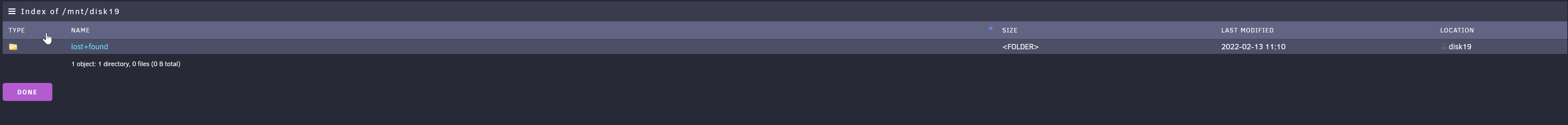

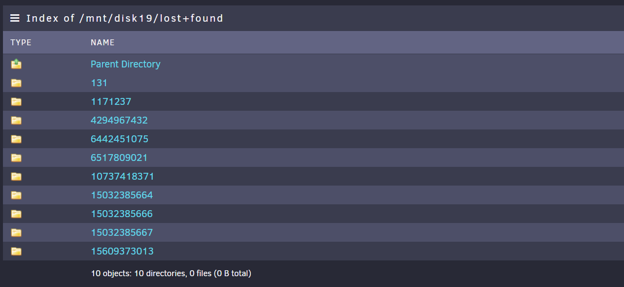

Disk 19 had lot more lost+found  moves.
Edited by abhi.ko

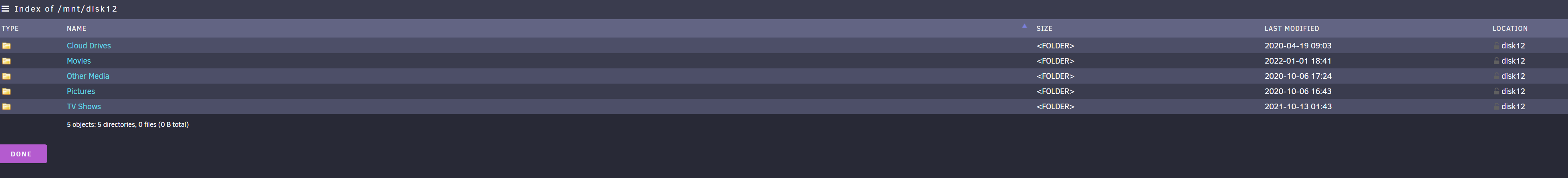

Both mounted fine - still disabled and emulated.
Disk 12 has no lost+found
Disk 19 only has lost+found

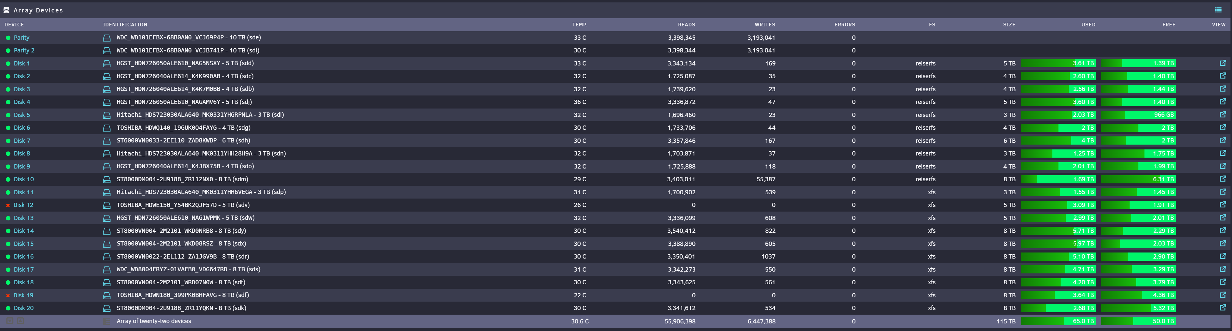

Diagnostics & screenshots below.
What now please? Thanks for all the help till now.
Does its content look like it should?   The absence of that folder normally means the repair has been fully successful and all data is intact.
Does the contents of the lost+found have recognisable content or only items with cryptic names?
Sorry, I honestly don't have a before frame of reference disk-wise to compare against, to know if it is actually missing anything. I took it to mean the same (i.e. repair was successful). Is there a chance that there is a still a chance of corruption?
Numbered folders within lost+found but recognizable sub folders within those.

You get entries in the lost+found folder when the repair process cannot find a directory entry to give the correct name.   Since the sub-folders have recognisable names you should be able to sort out the original path.
Ok, so just clarify next steps:
For Disk 19: Do I just rename the numbered directories to the original share names? How do I change the disk from the current disabled status?
For Disk 12: what do I do?
