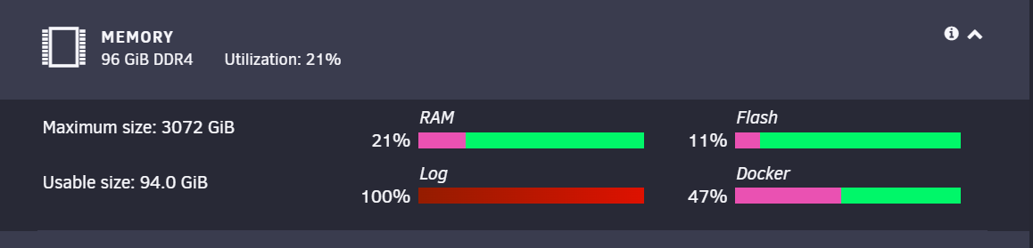

I started rebuilding the data disk (disk 19) with the new drive yesterday (2/15), and everything is going well except for the fact that I noticed today morning, the logs are getting filled up. it looks like it is mostly filled with error messages from 2/14 when the array was not even started but eh preclear was running. From what it looks to me, it seems like a backup trying to access a share that was not live during that time, the client IP in the error message below is that of my main workstation, and I have that being backed up using Paragon Backup to the server, so I am thinking that is what it is about. I might be wrong.
There are some other call trace errors in there as well and I am not sure if there is still a hardware issue that is causing errors in the log since the log is not being written to now, hence this post here to seek some expert help.
Feb 14 02:32:51 Tower nginx: 2022/02/14 02:32:51 [error] 11687#11687: *323602 limiting requests, excess: 20.842 by zone "authlimit", client: 10.0.0.232, server: , request: "PROPFIND /login HTTP/1.1", host: "tower"
Feb 15 21:12:58 Tower kernel: Call Trace:
I have posted the diags here not sure if that is helpful, since the logs have been full and not written to since yesterday night it looks like.
Is there any way to clear the log file without restarting in the middle of the rebuild? Should I even try to?
tower-diagnostics-20220216-0643.zip
Edited by abhi.ko
You would probably have to restart syslog in addition to deleting some of it. The logs are at /var/log.

Thank you. I think I'm going to wait till this disk finishes rebuild. I am not seeing any other issues in the array (outside of the log) as I did before. Like disks with reallocated sector counts going up etc.

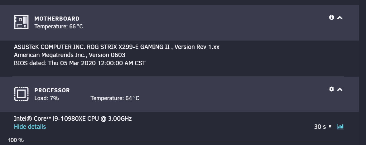

Check CPU ( 10980XE ) temperature, throttle before, not new ?
Feb 17 21:35:13 Tower kernel: CPU29: Core temperature is above threshold, cpu clock is throttled (total events = 4)
Feb 17 21:35:13 Tower kernel: CPU11: Core temperature is above threshold, cpu clock is throttled (total events = 4)
Edited by Vr2Io
hmm - interesting. This is new, the case is pretty clean and I got enough fans running inside, wonder why.
Are these temp too hot? Can I adjust the threshold?
In diagnostics, CPU run in high load ( SHFS process ), pls check temp. in console by type "sensors" and focus on coretemp
I keep my 9800X max @ ~66C ( with powerlimit )
Edited by Vr2Io

The log filling up issue stopped happening after another reboot and the system is running much cooler, I was going to replace the existing CPU cooler and with something more beefy but did not need to. Even while the log was at 100% the system was running pretty solid, so decided to wait and see, and no issues after that reboot. I upgraded to rc3 and still everything to the best of my knowledge is running smoothly.
