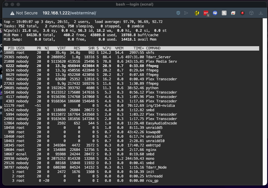

With every container except for Plex and Tautulli disabled, the parity check finally completed -- although it again had 5 errors written to correction. But towards the end of the parity check process, my machine was running low on RAM. I have 64GB, the max my motherboard will allow. Now that I think of it, the other times the shares crashed I saw memory allocation errors. Anyway, I used Top in the console to see what was using the RAM and it was shfs. I stopped the array and the RAM utilization went back to normal levels. When I reenabled the array shfs wasn't using very much RAM. Now that I have been running it for a few days with all the containers operational, RAM is again creeping up to high levels of utilization, with Top reporting that most of that utilization is due to shfs. My guess is that within a day or two, without intervention on my part, my shares will all crash again and I will see the memory allocation errors show up.
Does anyone know why shfs would be hogging all my memory? Are there particular logs that I should be looking at for this issue?

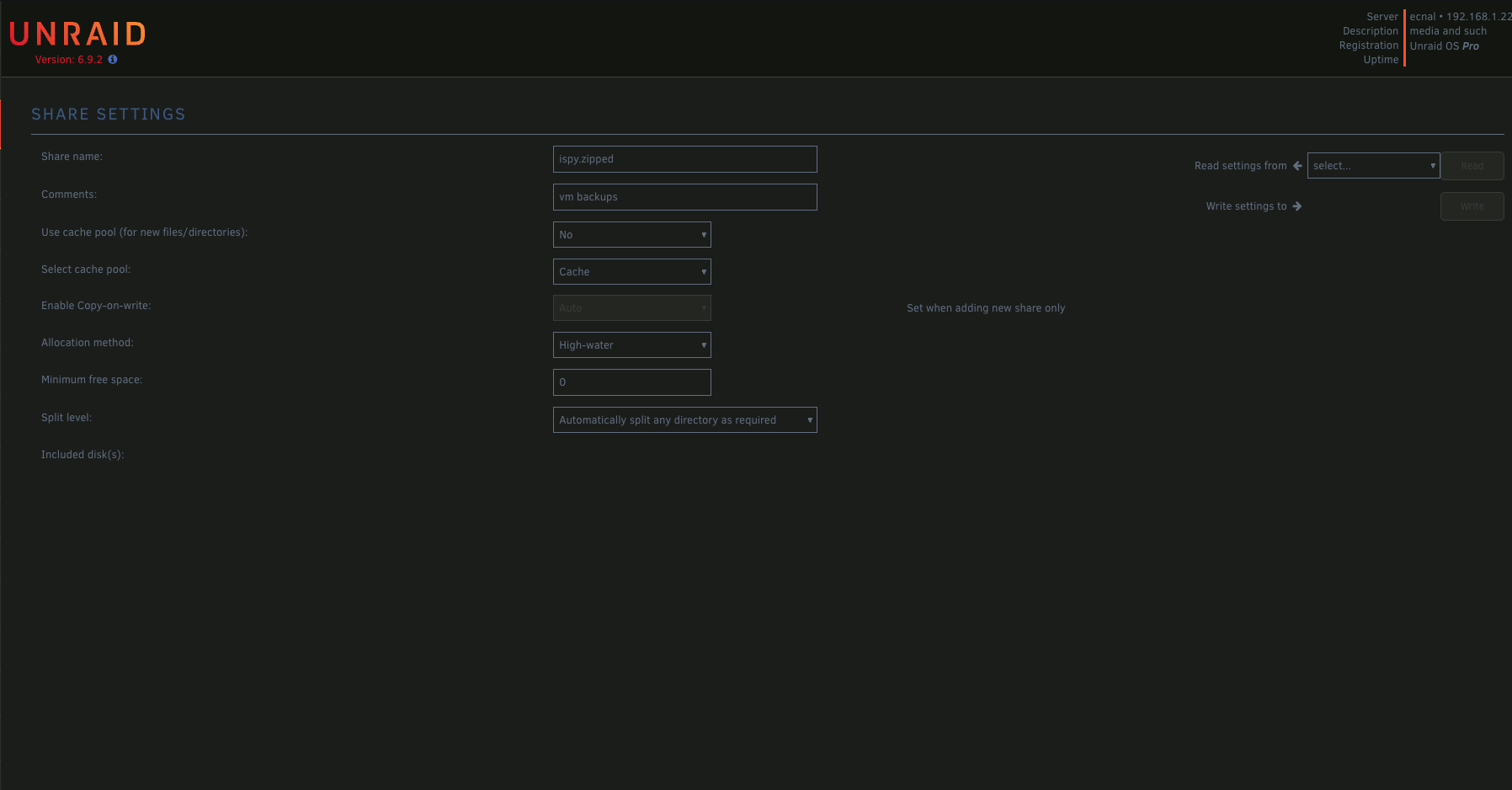

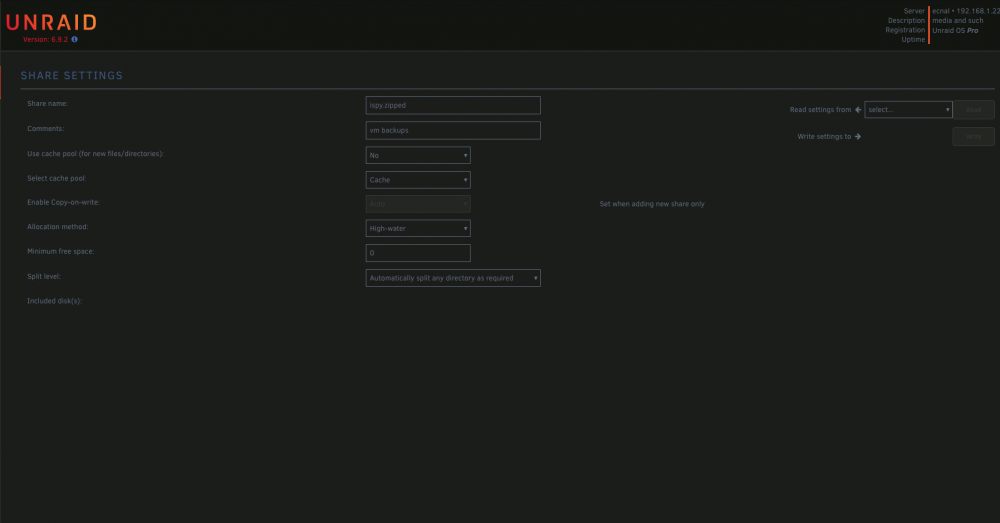

I discovered the attached posts from 2020 and they put me on the right path. I currently have SMB disabled and everything is working fine (other than I don't have SMB access, that is). In the process of scouring my shares and disabling SMB on all of them, I discovered a share whose "Share settings" page won't fully populate. It is the only one that behaves this way (screenshot attached). It only loads the top portion of the page, and then the loading indicator on the browser tab just spins until it eventually stops and all that is displayed is this much of the page. I truly don't care about the data on this share. Does anyone know the implications if I just delete this share from the config file? Is there a better way of going about getting access to this shares setting page? Is there a config file where this Share Settings page can be altered by hand in a text editor?
1164644423_ScreenShot2022-04-17at9_59_52PM.thumb.png.da8944e18b86820054e4a84ab43254c3.png
Thanks,
ecnal
