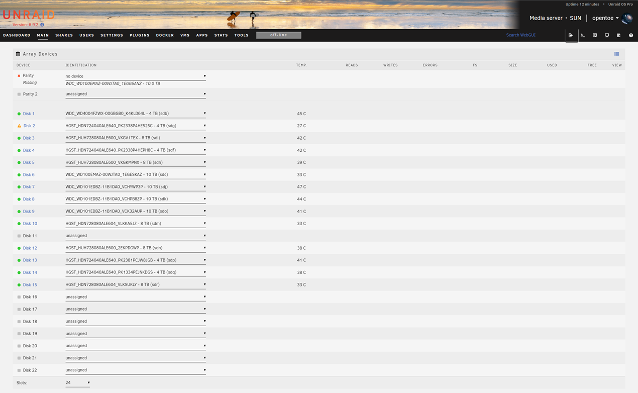

It seems my parity drive died. What happened was when sliding another drive into the bay it was a very tight fit, so the metal edge of the bay scraped a little piece of the label off the drive and that piece somehow dropped right onto one of the pins on my parity drive. Not knowing this I kept trying to get my server running but eventually the parity drive doesn't even show up. I want to temporarily run the array without the parity drive to get some files I need and take the chance leaving it like that for a couple of days. My START array button is greyed out. So I'm guessing I need to go into the tools section and click NEW CONFIG? There is one caveat. I was in the middle of replacing a bad drive, so the new drive which is a larger drive has no data on it and can't be re-built until another drive comes. Any suggestions on what to do in this odd situation. The older 4TB drive I removed actually still works, so I can install that back in and then use the replacement which is a 10TB to replace my parity. Then at least the system will re-build my parity and I can worry about that 4TB that's going bad after the re-build. Does that sound like a good plan? The last thing I want to do is click a button and have my entire array go pooof. :)
Thanks!

The most complicated thing you need is the screenshot you have already made and showed above.
If you do "new config" (and tell it to throw away all infos of the old array) you then just go to the array definition and create a new array using the serial numbers of your screenshot and leaving the parity entry free (no disk).
Then you can start the array, NOTHING will happen, just your data will reappear and accessible again.
This is because there is no data stored at all on the parity drive, its wise to have one in case of a data disk failing, but it is not needed for normal working operations.
Then you can go out, buy ONE new drive (maybe one of those 20Tb ones, to start with. I prefer faster 18TBs...), stop the array and assign it to the parity slot. It will then regenerate the parity  taking a long time.
It will make your data protected again and also opens the door for you for further updates. Someday you can go out and buy the next 18 or evern 20Tb drive and add it as a data disk (or replace an old drive with it)
But there is no time pressure, things can be done with long pauses or even not at all.
(of course, a 20Tb parity drive will be overkill right now, but it will allow you future updates without any stress and long copy orgies. And, dont sit on the money! the parity drive is the speed limit to all data disk. So go out and buy a FAST ONE! Usually those end with -PRO in their names and are more expensive, but you will notice the difference someday. Data Disks can be slower, but a slow Parity will slow down everything!)

Well, I ran the NEW CONFIG without adding the new 10TB parity drive and unraid was smart enough to see all parity was good. Got all drives back, just not using parity now. I did not want to make myself get into the 18TB realm of drives, but as you suggest I may look into getting one for partity and another one to kick out a couple smaller 2TB drives Id o not need anymore. I see lots of Seagate IronWolf Drives. I know I will not break speed records, but  would like to do what you mentioned. Get a fast 18TB model. Are Seagate drives ok to buy these days? Growing up, working in the IT LAND we have piles 6 to 10 feet high of consumer Seagate drives. Western Digitals were among the most reliable.

If so, UNRAID was not thinking that parity is good, it simply sees: "there is no parity".
And because parity is optional, there wont be any complains. Sooner or later you should add a parity drive again. If you never plan to use really big ones, 10Tb maybe sufficient for a long time for you.

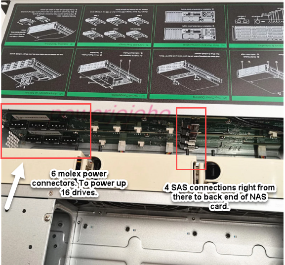

16HD bay with included backplane. Backplane is one piece.

Your case looks good, almost identical to the new one I've bought a few weeks ago. 16 cages in 3U too. But I only have 6 slots filled (with all 18Tb and 1 10 TB, 2*2TB NVme and 512G NVMe for write cache only. I use 4 * 4 Port SATA Controllers, 2 on the Mobo, 2 in 1x Slots. The Disks in the array are spread among all controllers and all slots (so there is always enough empty slot for better airflow. I dont think this beast will ever be filled up to the limit.
https://www.amazon.de/gp/product/B00O4G71XU/ref=ppx_yo_dt_b_asin_title_o00_s00?ie=UTF8&psc=1
