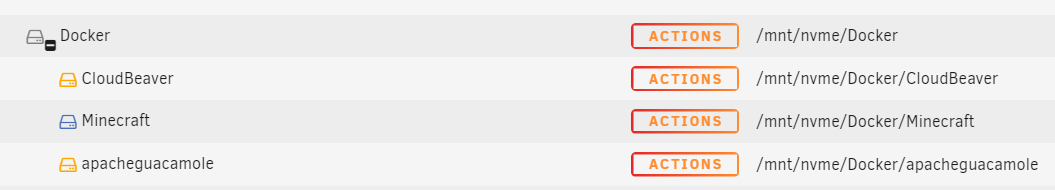

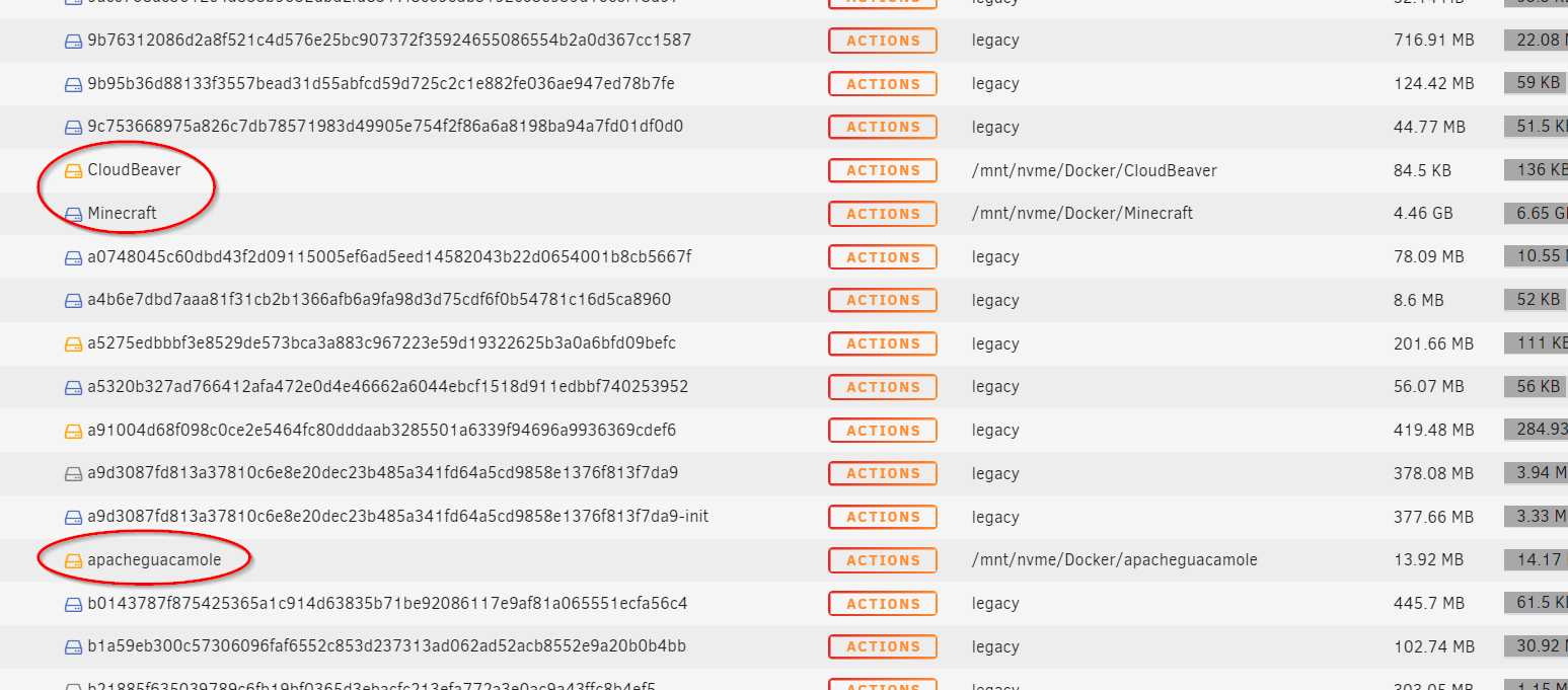

Hello all
I am having trouble defining the correct LUA patterns.
My ZFS tree looks like this:
I would like to filter out (not display) all records with lower case letters and numbers with a length greater than 60 characters.
The folders CloudBeaver, Minecraft and apacheguacamole should still be visible.
Does anyone have any idea how to do this? under regex it was simple. My regex:  /^nvme\/Docker\/[0-9a-z]{64}/
Thanks for the help.
Andi
4 hours ago, andber said:
Hello all
I am having trouble defining the correct LUA patterns....
Please be aware that Lua Patterns are not equivalent to Regex. Your use case seems to be more than Lua Pattern could handle, my suggestion is to create another dataset/volume exclusively for Docker Files so you could filter that dataset from view.
02601e402ca98cc83817695bd00d7bd186fdc910706df0c22715648fcedfa259
029575bd645b76b459a8355560fa0cf8e67cfa0d68d85c0b4a6f9d3539b09d70
0cbe30f9fe37bf450a48e68eff7172c30befc57c889e3b329da24fbd684f89a5
06fd8ae3e9acf4650afb15b5ddb7de33821adb348e2034919b1e2ab504fb80f7
Thank you for your hast help Iker!
Next time i set up unraid i will do it the way you told me. For the moment i hav put in the pattern "64 dots" like above and all docker state drives are gone. I think this is because the length of the name is exactly 64 characters ...
does not look "nice", but works :)
Wow, that's very clever! I'm not that Docker savvy, but yeah, I assume that volumes names are just 32 bytes hashes (64 bytes hex). I'm so sorry about all the mess with the patterns; but it really worth the trouble, thanks to that the load times were reduced to half.

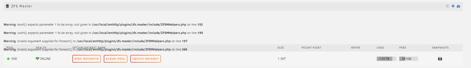

Hi @IkerI was on v6.10.3 and seeing the below issue so I reinstalled the plugin but I'm still seeing the error. I tried upgraded to unraid v6.11.0 but the error still persisted.image.thumb.png.21181449438969a4cf5bad308dafbef1.png
Any recommendation?
Any recommendation?
Which plugin version are you using?

I'm using ZFS Master version 2022.08.21.54
It's possible that one of your pools doesn't have any datasets?, I mean, that's the only thing that comes to my mind that could case that error; if that not the case, please send me a PM with the result (in text) of the following command:
