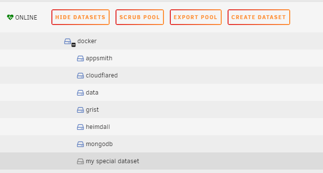

The plugin doesn't show datasets which have spaces in their name, is this correct? I thought ZFS was ok with spaces?
Kind of. You can not create them from the user interface (Next update I will fix that), but you can list them and operate over them.
Interesting, mine isn't showing any datasets which have a space in their name.
Please share what Unraid and Plugin version are you using, and if possible the ZFS list command output from the top directory that contains those datasets not being detected and the dir tree; if it's not possible, at least some mock up names and tree that can help me to reproduce the situation.

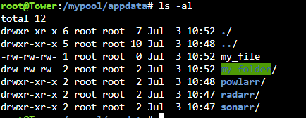

17 minutes ago, deliverer said:
Lastly, what does "Recursively create snapshots of all descendent datasets" mean when I manually perform a snapshot?  I don't quite understand if I should select this or not?  Based on my google research, it's more if you want to do the entire pool?  Since the UI only allows the dataset to be selected for a snapshot, does it matter if I select this option or not?
Let's say you have the following datasets structure:
Note that only powlarr, radarr and sonarr, are Datasets; my_folder is a regular folder, and my_file, well is just a file. Now imagine you want to create a snapshot that apply to every single dataset in appdata and regular folders and files; you check the option "Recursively create snapshots...", if you don't, the snapshot is only going to apply to the regular folder and files, but not the datasets inside appdata. this is handy if you want for example, backup the entire appdata dir every 6 hours.
