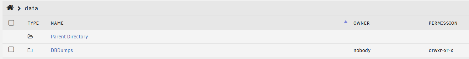

When creating a new Dataset, the directory does not have write permission granted on it. Requires manually adding the permission to be usable in a SMB share.
Yes, it's by design; a couple of versions ago, the permissions scheme was changed to 755, with nobody as the owner and users as the group by default, which I believe is pretty much the standard in Unraid and also the most common use case. I can add an option on the dataset actions menu to change permissions if that is convenient for you.

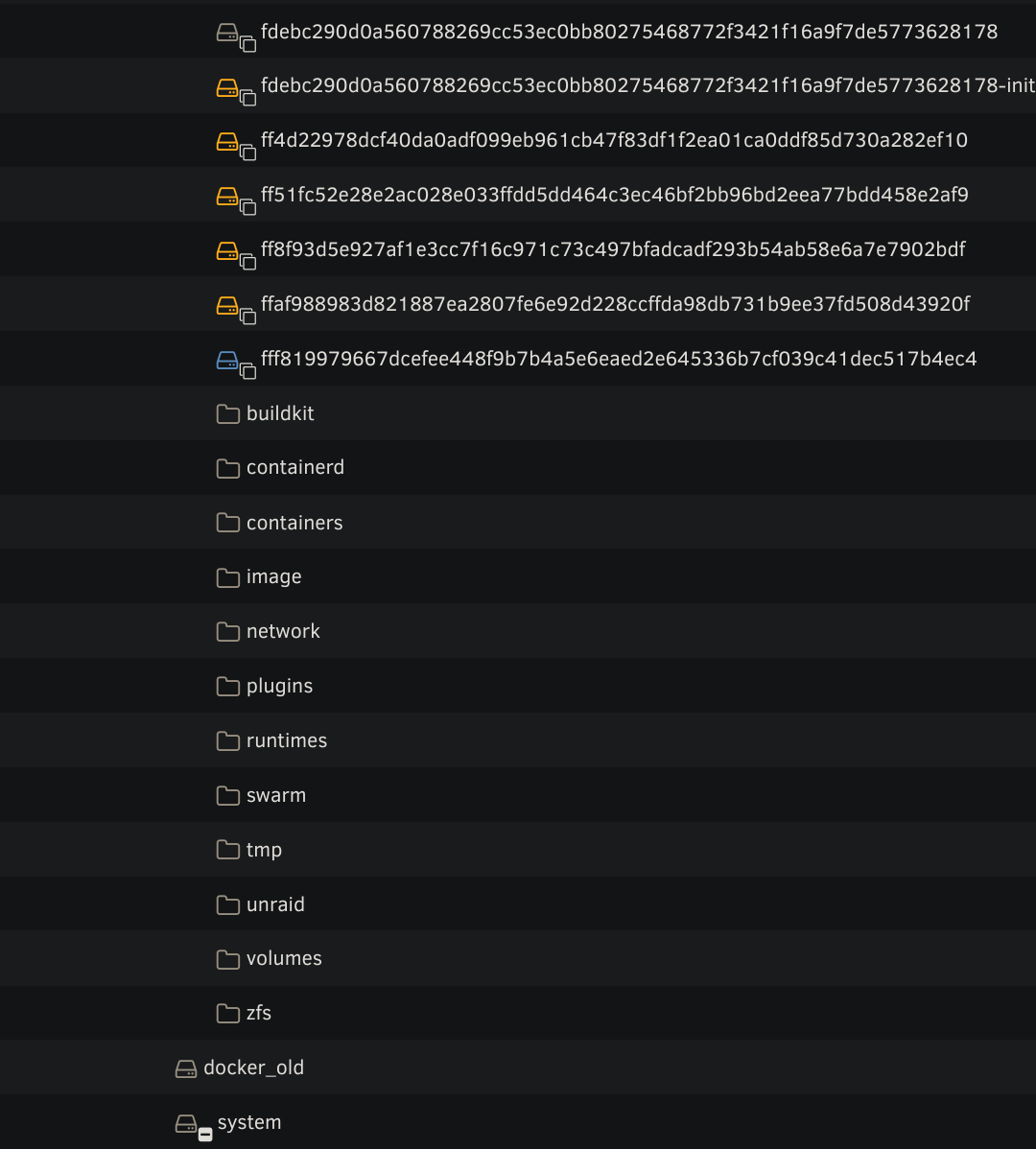

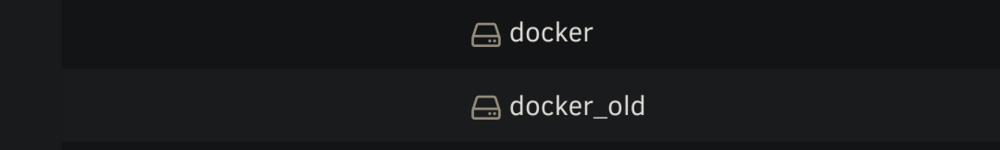

The Exclusion Hint is not working. /dockerfiles/.*
/docker/.* not working
/docker.* working but include the docker and docker_old Share/Folder
Can you fixed this?

10 hours ago, Iker said:
Fix - Exclussion patterns keywords

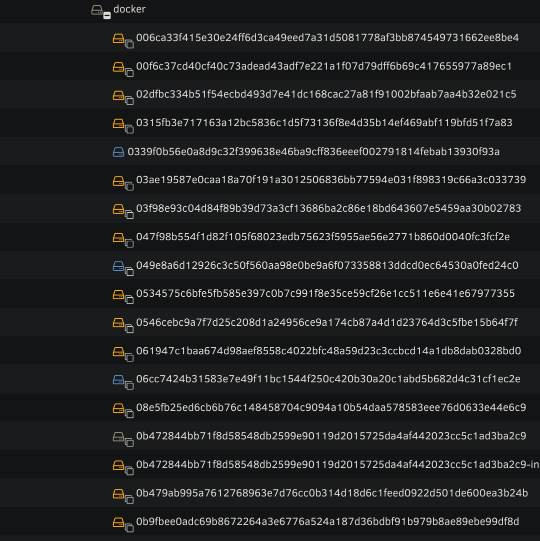

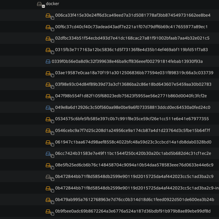

Mean this my Issue?
Its not working. > /docker/.*
With /docker.* two folders are hint/exclude.
This is without filter:
Screenshot_20240506-125729_Firefox.thumb.png.a00e3e89e7f0b6563301a2b0e735205a.pngScreenshot_20240506-125705_Firefox.thumb.png.88f5fa832f369105eba1398777a66c7a.png
Edited by Revan335
It's working, or at least as it has been working for a while. Datasets are not entirely hidden if you use ".*" termination, but his children are not listed, as it's helpful to know how much space they take and what their properties are. If you want to get rid entirely of the dataset on the main interface, use "/docker", but be aware that it can match multiple datasets outside of the ones you mentioned.

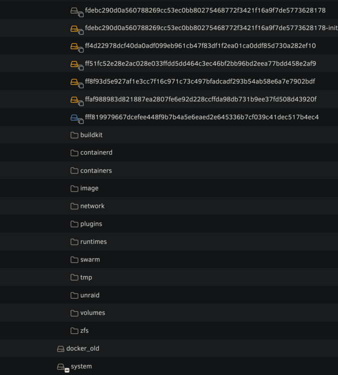

OK, how can I include only the /docker/ folder and his children's? Others like docker_old are visible.
"/docker/.*" works for me, but the "docker" dataset is still showing, I think that's the best you can achieve with the current limitations. (Give it 30 seconds to pickup the config change)

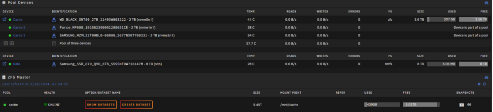

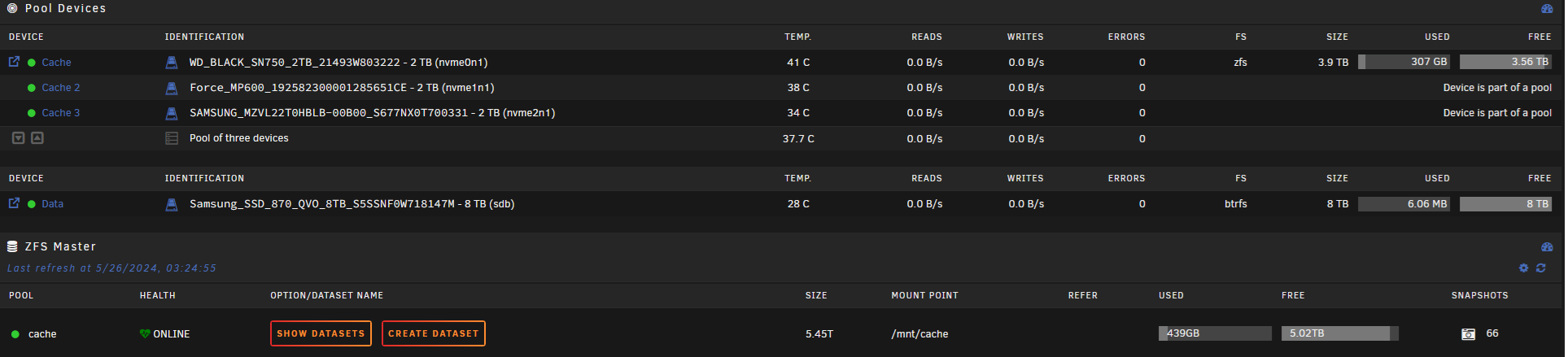

ZFS master isn't showing the correct pool size for me but instead showing the amount of space for all disk.
