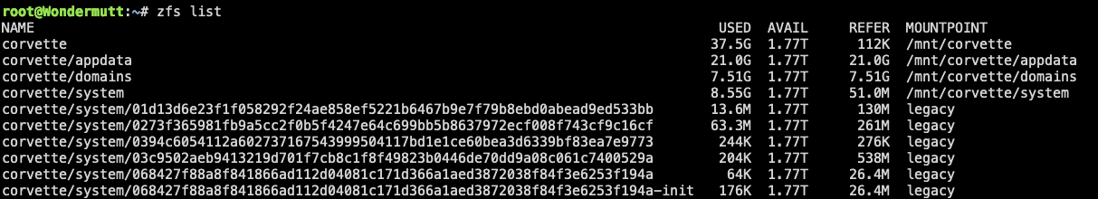

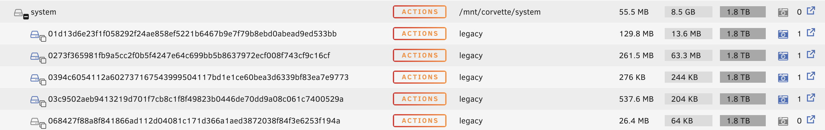

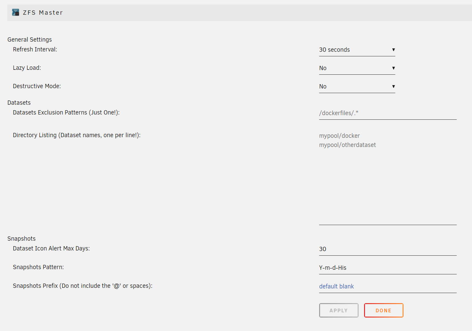

Quick question: what are these cryptic entries with a legacy mount point under my system share/dataset in the ZFS Master plugin entries on the Main tab?
I'll be the first to admit, ZFS is new to me, and I'm no expert. I recently did a server upgrade, and in the process, I added new ZFS pools and moved my appdata and system shares over to it. These all popped up under my system after a reboot (It might have been a dirty reboot) after the server was initially booted up and my files were moved to the new shares on the ZFS pool. I see that some of them have snapshots and some of them don't.
Generally, there are a lot of them (hundreds) and I'm bothered because I didn't make them, and I don't know what they are. On a more superficial level, they're really mucking up my GUI since they always open expanded, and I've got to really scroll to get down to my unassigned devices now. So, besides "what are these?" My follow up question is "how can I get rid of them?" Or at least "how can I hide them?"

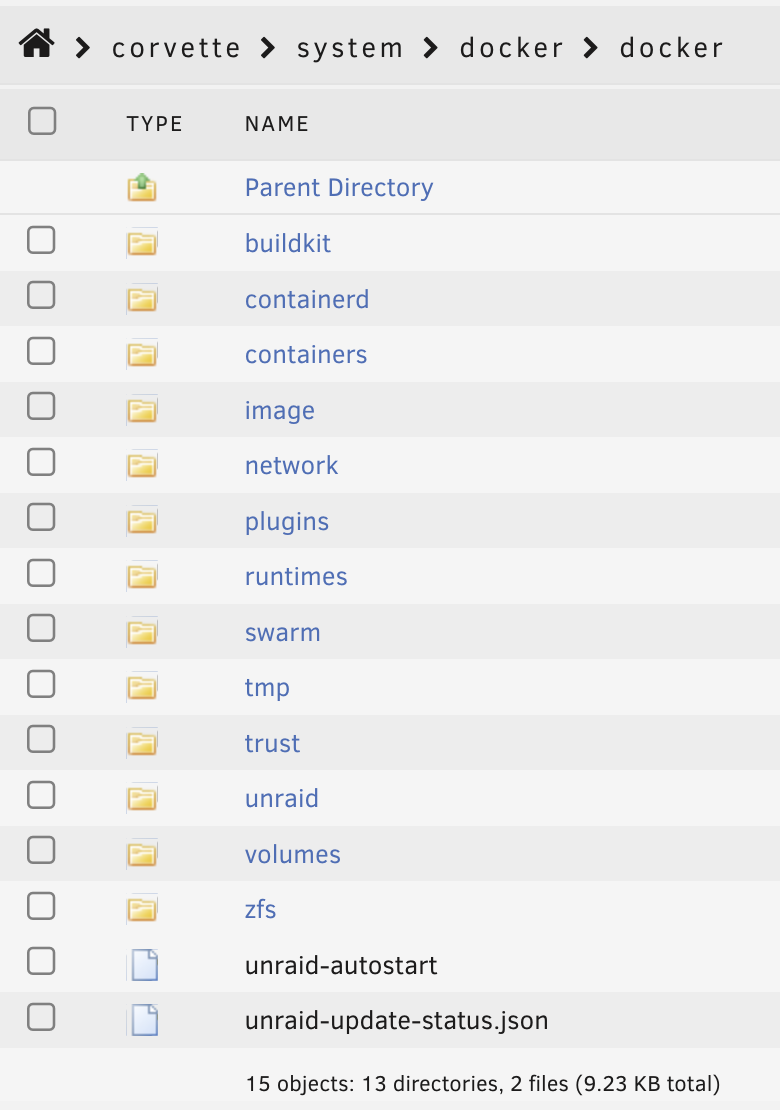

My system share has standard stuff in it (docker and libvirt.) Docker is set as a directory (not an image.) I tried setting the dockerfile filter in the ZFS Master settings (/dockerfiles/.*) but that didnt work. I didn't have high hopes since these didnt seem to match any of those file strings (like the files in the /zfs/graph/ subdirectory.)
That's how Docker handles using a directory for image storage. It's normal.
Try "/docker/+" as the exclusion pattern, or similar for your dataset structure.
Thanks @Renegade605! I suspect you're absolutely right. As it is, my blindly plugging in the example "/dockerfiles/.* would not have worked since my directory structure is "/system/docker/docker/". But I'm still having a tough time coming up with a lua exclusion pattern that works. I've reviewed the tutorial, and if I'm understanding this correctly, "/docker/.*" or "/docker/.+" should work for me (the former matching /docker/, as well as all subfolders and files, and latter mattching only the subfolders and files of /docker/.) I don't think I need to add the full path if I don't include the start of string pattern match (the ^) as well. But, despite all these permutations, I still can't exclude these files. Any advice? Here's a look at my directory structure for docker.
I did try "/docker/+" witch didn't work. And if I understand Lua patterns correctly, the "." is necessary as the "all character class" character before the * or + pattern match character.
Edited by FirbyKirby
Now that you mention it, I did typo that. But it worked anyway, because "docker/" matches all child datasets of docker (ie. "cache/system/docker/01d13...." matches "docker/" and the + 'one or more times' is irrelevant).
Looking closer, I suspect it's because your docker folder is just a folder, not a dataset. The exclusion pattern only matches datasets, not file/folder structure. (Type "zfs list" in the terminal to see what datasets there are on your system.) You can either a) make a child dataset under 'system' named 'docker' (you'll have to delete your existing directory first, and reinstall your containers after), or b) exclude "system/.+"
If you do the latter, and later make a child dataset for system, it will also not appear. Unless you make your exclusion pattern something like "system/[a-f0-9]{64}". EDIT: Nevermind, looks like Lua doesn't support {} notation.
I suggest the former, as creating new datasets for differing tasks is a big part of zfs design philosophy and you can do more later on. (For example: I have a reservation and quota of 20G on the docker dataset, so it's guaranteed to always have 20G available no matter how full the rest of my cache pool is, and to never take up more than 20G if something weird should happen.)

Ahh. That makes sense. Essentially, there is a "hole" in my datasets between the Unraid share dataset (/system) and the docker files further down the directory tree (which are also, I guess, created as datasets?)
Yep. My docker folder is just a folder, not a dataset.
And thanks for the explanation of what a dataset is and your recommendation of making docker a dataset. In my server upgrade, I moved /system, /appdata, and /domains over to single ZFS pool with exclusive access for the best performance. So I am vaugely nervous about the amount of space these directories will consume as they dynamically grow. So a reservation and quota for docker makes a ton of sense for me as well.
I guess I wouldn't really need to make a dataset for any directories below /docker based on your description of the ZFS design philosophy being focused on 1 dataset per task (everything under /docker is the same "docker" task, so to speak.)
OK, off to figure out how to create a new dataset with the ZFS Master plugin....

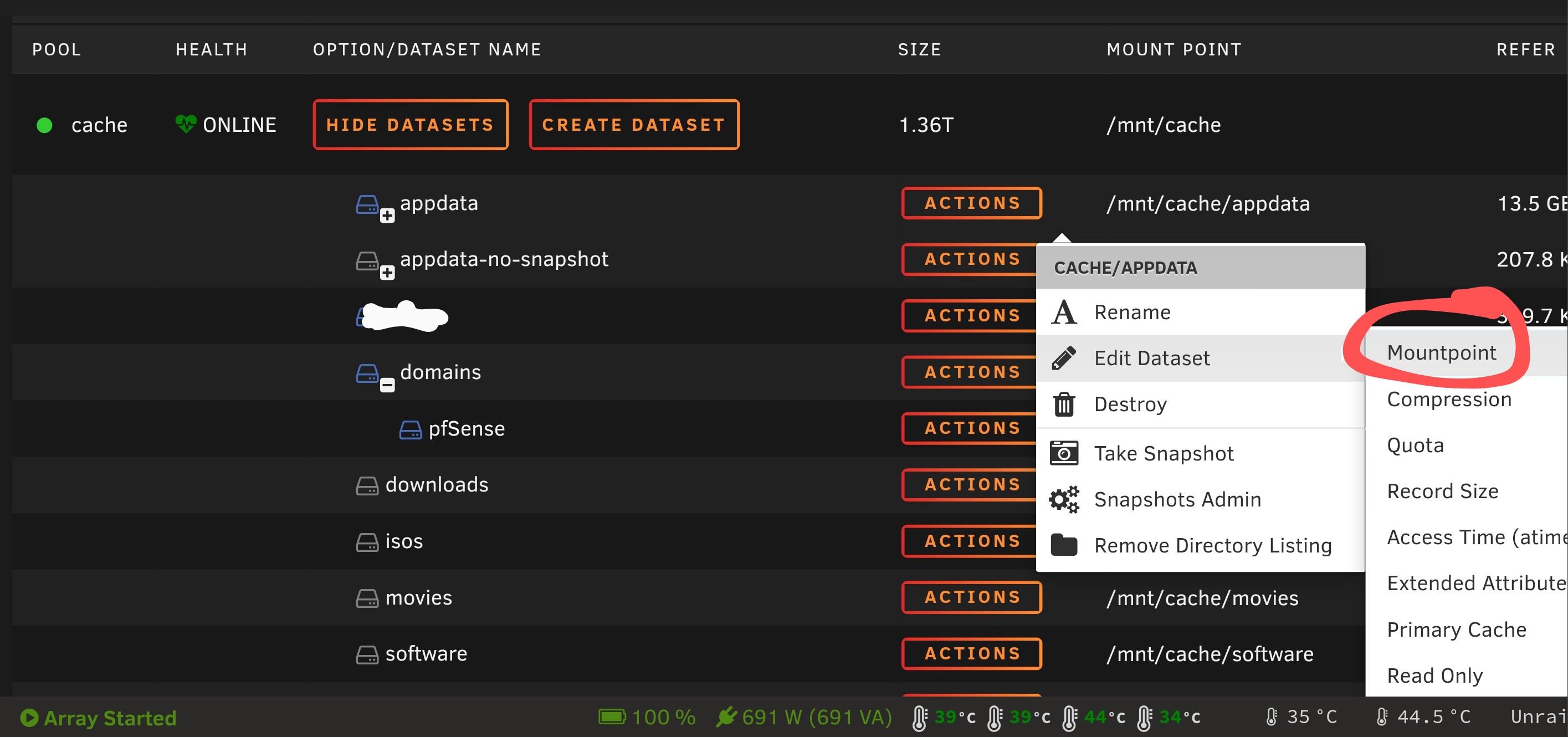

funny enough I just lost my appdata (still had to set up the backup plugin) since I had the appdata folder but not the appdata dataset
I went to Create Dataset -> typed appdata and wiped straight the appdata folder
In my opinion there should be a follow up warning for this if the directory exists
It isn't gone, just hidden. The old appdata folder exists but the new appdata dataset is mounted over top. Change the mountpoint of the appdata dataset to "none" and the folder will be there.
how can i do this? I mean is possible by gui?
Yes.
1 minute ago, Renegade605 said:
Yes.
oh thanks, i already did by cli, it needed the destructive mode on
Now i have back the data so i destroy this dataset, create a new one and just move the files in?
I guess is a nice to have to have appdata folder as a dataset no?
thanks :)
thanks :)
You can either
- rename the current folder
- remount the dataset
- move the files
- delete the folder
Or
- mount the dataset somewhere else (eg /mnt/cache/appdata-new)
- move the files
- delete the folder
- change the dataset mount point back to default
ZFS will let you mount a dataset anywhere you want, which has many practical uses. If you wanted you could create a dataset on the cache and then mount it to /mnt/disk1, although that would not be a good idea.
At minimum, every top level folder on a zpool should be a dataset. Unraid will do this automatically for user shares that don't exist yet, but doesn't convert folders that already exist. It's up to you if you want to create more.
For example, you can see my "cache/domains" dataset has a "cache/domains/pfSense" child dataset.

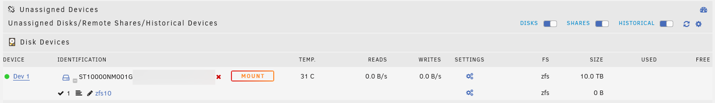

I found weird behavior: if I have Unassigned Devices formatted in ZFS they will never spindown.
It seems this setting  'no refresh' works only for array ZFS drive.
