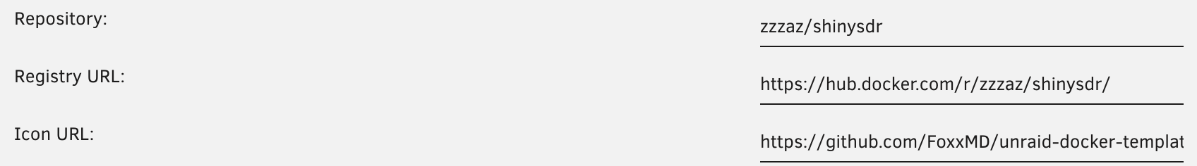

  16. I had trouble getting this app to work with the latest RTL-SDR Blog v4 radio dongle from RTL-SDR.com. It connected just fine, and no errors were thrown, but I did not receive any signals (except for a birdie from the RTL-SDR's oscillator.) In researching a solution, I noticed that the docker image this app is built on hasn't been updated in 4 years (and the RTL-SDR Blog v4 radio was released more recently.) They changed some details of how that particular dongle works in V4, and drivers were updated to support it. I saw a docker image forked from the original this app that was built on, claiming that its only change was support for "rltv4". I gave it a shot, hoping that was a typo and that they actually added RLT-SDR v4 support. I got lucky, and indeed, that fixed my issue! I can now use this app on the new docker image with the RTL-SDR Blog V4 dongle. Just posting my journey here for anyone else who happens to get the new V4 dongle version as well. To make the change, you need to go to the advanced view of the app template in Unraid and change the repository link. That's it. All the config info doesn't change.

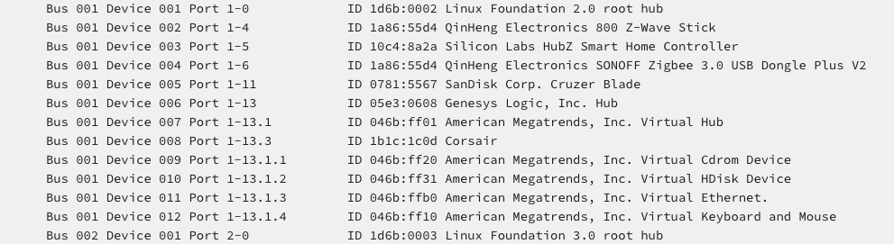

  17. @calmasacow Ditto over here, with the exact same devices. Maybe it's a vendor ID, and not a device ID? My home assistant VM really doesn't like it though. Did you, by chance, resolve this?
