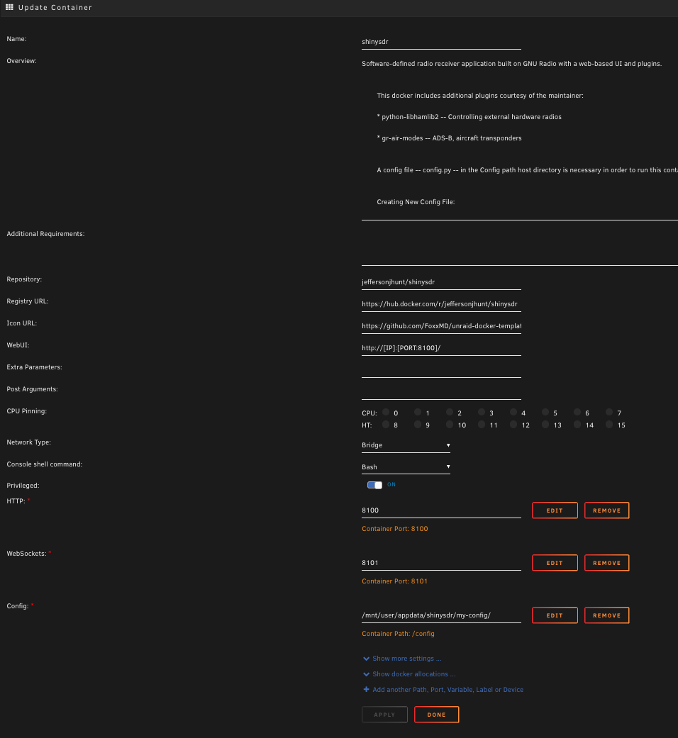

November 2, 20224 yr On 8/19/2022 at 2:34 AM, SeattleBandit said: I just had to recover my isb stick that unRAID runs on - got everything back up and running but for whatever reason shinysdr can open the USB connection to my rtl-sdr - has anyone experienced similar issues? If I use the sdr I have connected for my fr24 adsb it works fine so it's not the radio Updated the config per guidance in this channel - tried running in privikiged mode - removed and reinstalled - still no dice Same, I'm getting: Quote Using device #0 Nooelec NESDR SMArt v5 SN: 00000001 usb_claim_interface error -6 FATAL: Failed to open rtlsdr device. Trying to fill up 1 missing channel(s) with null source(s). This is being done to prevent the application from crashing due to gnuradio bug #528. after adding the config. It correctly identifies the device, which is a good sign, but lost now. Edit: Ughh one of those classic "fix it 30s after asking for help". The config edit specified above has to replace the existing "osmo" device config line on line 13. Edited November 2, 20224 yr by Jambo

February 15, 20242 yr On 4/11/2023 at 1:12 AM, sniffton said: Hello, I'm trying to instal the docker but keep on getting a "docker: bad format for path:" error. In the log I get this: [error] 2083#2083: *164074 open() "/usr/local/emhttp/https%3A/apps.modpacks.ch/modpacks/art/99/FTB%20Skies%20512x512.png" failed (2: No such file or directory) while sending to client" Thank you in advance So what I did to overcome the issue is to "remove" the device variable/path from the config page before launching the container and to turn on privileged mode. Be sure to pay attention to the Post Arguments that are defined in the Overview header to generate the initial config. Edited February 15, 20242 yr by spitfireza7 Add path to the device specification in template
