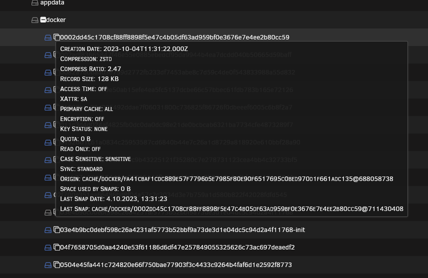

On 10/3/2023 at 3:17 PM, Niklas said:
Look at page 8-9 in this thread. You will probably need to remove the datasets manually.
I have deleted everything now, reformated my pool and setup everything fresh and new, now it looks right, but i still cant find the right setting to hide those datasets
Any idea? Tried "/cache/docker/.*" or "/docker/.*"
/docker/.* should do the trick, if not please send me a pm with the following command result "zfs list".
Best/
Best/
Ok, i dont know why it worked now and not before, but i tested it again and just waited a bit longer and now it works. Thx
