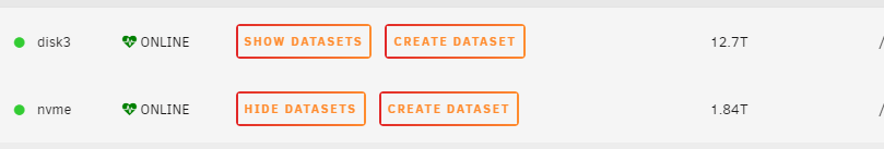

1. I see no button "scrub" in plugin, it was removed or some setting should activate it? I use
2023.12.08.48 version
2. Is it possible to remove dataset via plugin? For example it is easy to create, but for removing I have to do that in CLI.
BTW:  "No Refresh" doen`t affect Unassigned disks, so I just formatted them to btrfs and xfs.
  1. Unraid has built-in scrub functionality; you can check it on the pool properties.
  2. Yes, you must activate the destruction mode in the setting; I recommend you read the first post in this thread to check the plugin's functionality.
  3. "No refresh" affects either all or none of the pools, so something else is happening with the ZFS pool from unassigned disks.

1. Yes it has, but from some tutorial with your plugin I saw this "scrub" button and don`t see where it was removed according to last change log.
2. Thank you, activated, but after destroying see
3. No refresh works only for array disks, I don`t know why, but unassignedd will never spin down.
