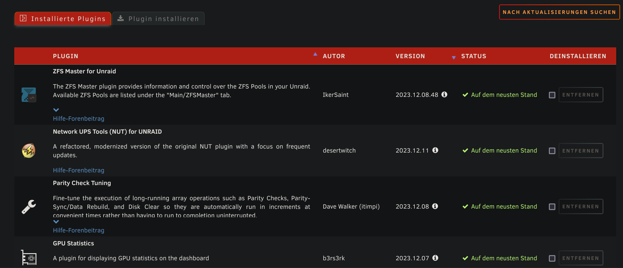

@IkerCan you remove the .48 in the Version that fix the Sorting in Plugins Overview.
Yes, I can, but, can you please explain why or how that is something helpful for the plugin? (I use it in to keep track of multiple things, and, to be able to release multiple versions on the same day if necessary).
I mean this. The 2023.12.08.x is above the 2023.12.11
Maybe its a Bug in the Plugins Sorting and you can used the actually Schema too.
That seems to me an error on the sorting algorithm. However, I can change it to letters after the day as other plugins do.

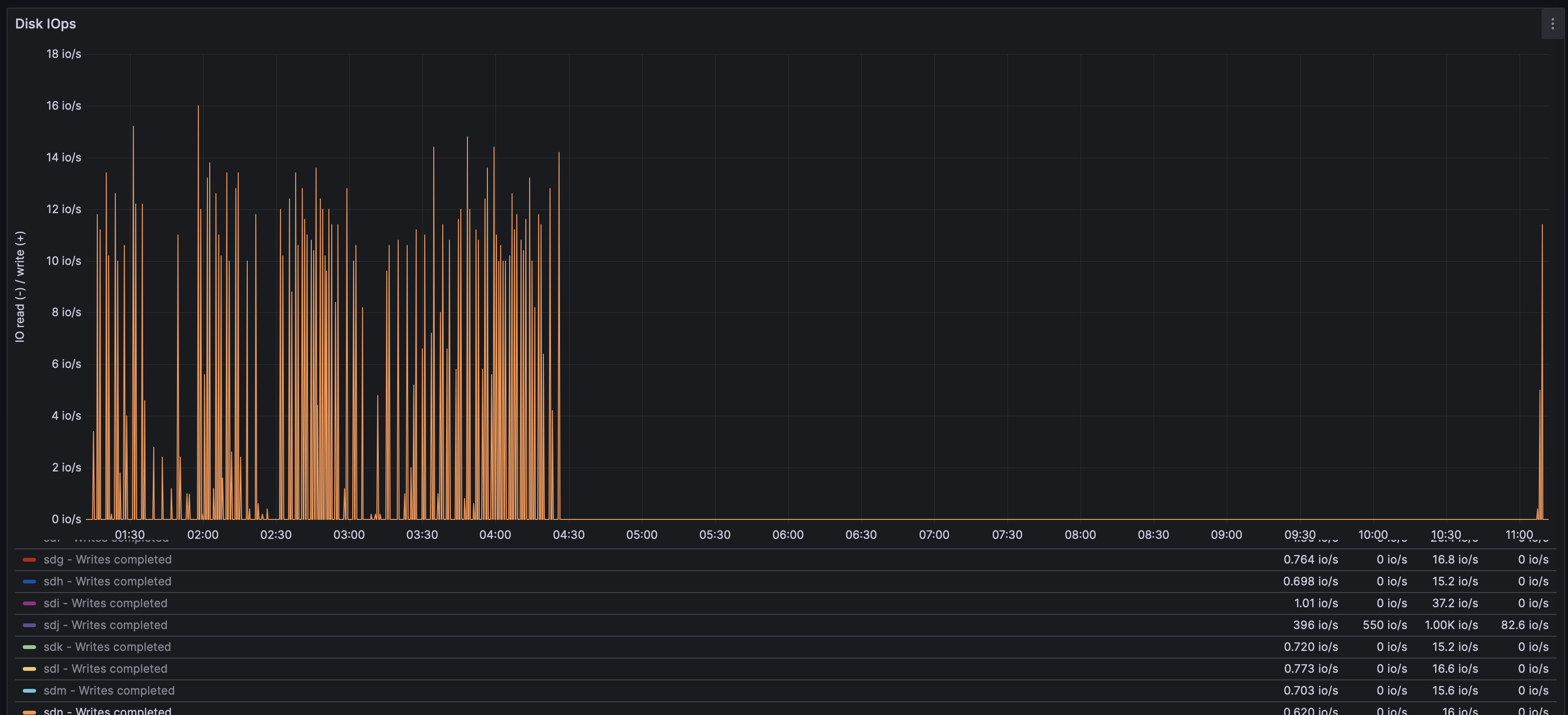

I'm experiencing some random read/writes on disk, I did a test on a disk not added in any share.
With the plugin installed I have all this disk write access, without it it stops
1641139818_Screenshot2023-12-18at11_12_07.thumb.png.08a82f794cc110a467ff976195a415f3.png
Disk12 (sdn) doesn't have anything inside, but there are some data somewhere:
# zpool iostat disk12
              capacity     operations     bandwidth
pool        alloc   free   read  write   read  write
disk12      12.4M  2.72T      0      1    485  9.29K
is someone else having the same errors?

Hi @skler, does this situation happen with the main tab open?, if so, very likely the plugin is the culprit. Still, you can go to the plugin config section and set how often the plugin refreshes the datasets and snapshot information.
yes I fixed removing the refresh (in tabbed view btw the link to manually refresh doesn't appear). btw, you know how is used this disk space? what is written, and where?
Yeah, I'm planning to fix the tabbed view on the next release. Generally speaking read and writes at that stage is mostly associated with metadata.
