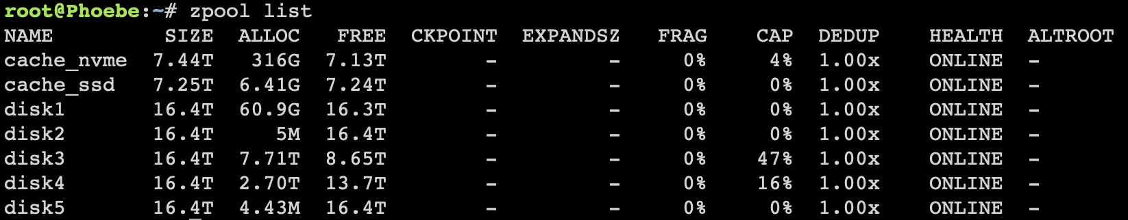

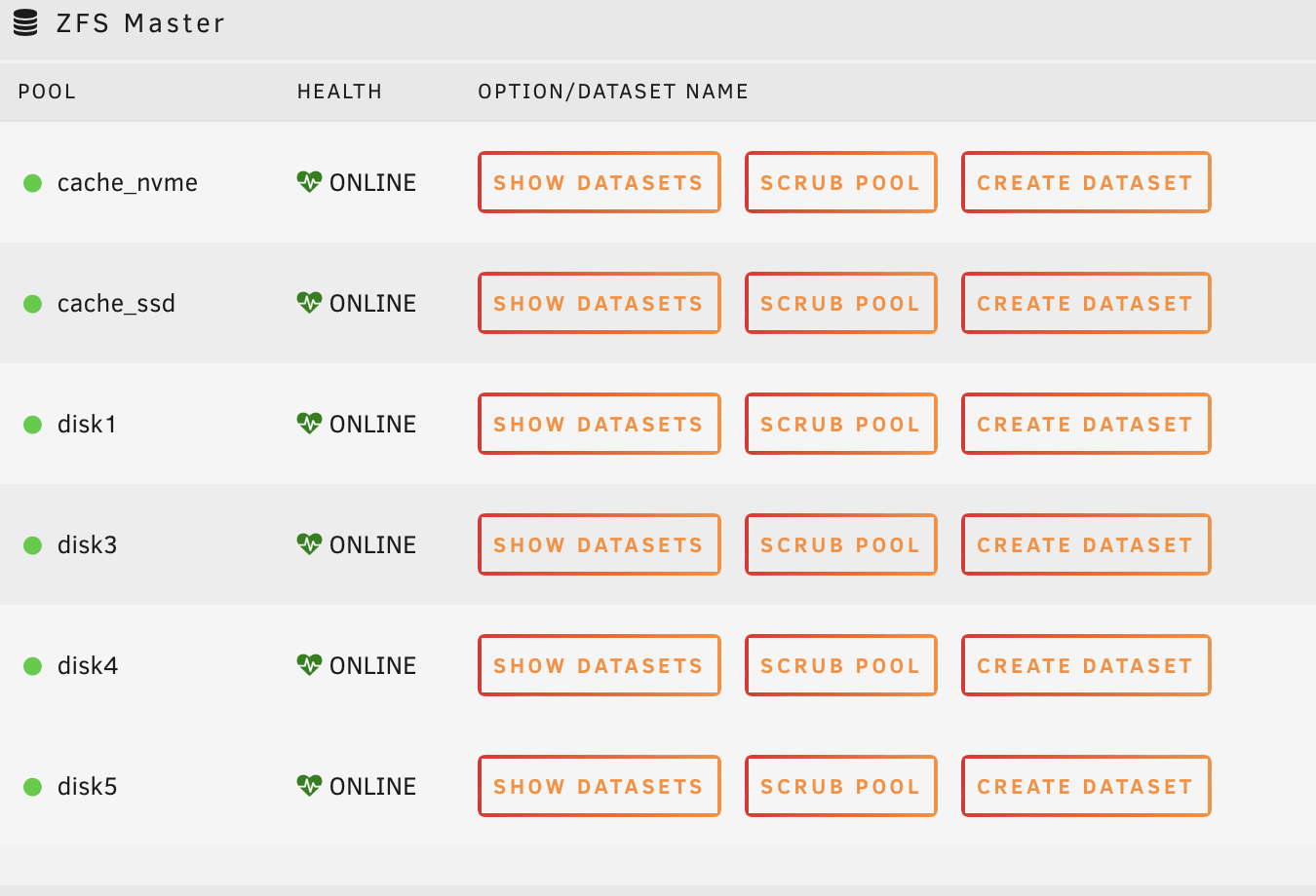

I am having an issue with one of my pools not showing up on the Main page under ZFS Master despite it being listed after running zpool -list. ZFS Master will show all my pools fine after a reboot, but after the server has been running for awhile it will stop displaying one of the pools on the Main page. It's not always the same pool that stops displaying on Main but it is always just one that stops showing up, i.e. I've never seen two not display. Right now it is disk2 that is not displaying properly:
1113765347_Screenshot2023-09-21at1_27_29PM.thumb.png.a13f6c44f2a19e0c03aa920d9413f798.png
1575292474_Screenshot2023-09-21at1_28_32PM.thumb.png.60a1df1506e28af9fdf0683357f71892.png
EDIT: Forgot to mention, I'm on 6.12.4 and 2023.09.05.31.main
Edited by lazant
Hi @lazant can you please send me the output of the "zpool list -v" command via PM. Please execute it only once the pool dissapears.

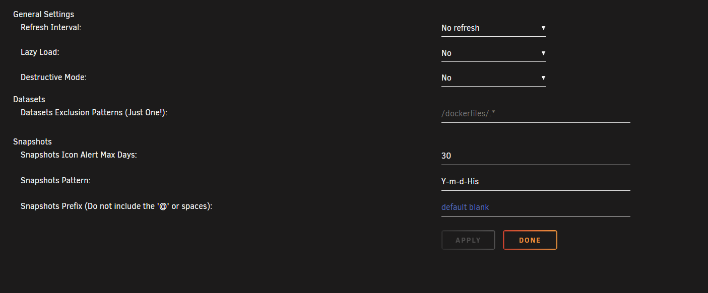

Are you sure the fix for refresh works? I have the latest plugin version. Settings:
And every time I enter my Main page the plugins last refresh keeps changing:image.png.a2b634723a2e52fa0d7e08170ceb847c.png.
My drives also spin up.
PS: I also tried with Lazy Load = Yes with the same result. Every time you enter the Main tab a refresh happens and then every time you click the main tab it also refreshes...

It's working as expected, or at least how I designed it; given the massive amount of changes in the backend for this version, I didn't want to introduce a functionality change that didn't result intuitively to a user. If you guys agree and it's really what is most useful for you, I can modify the "No refresh" functionality to not pull any info unless you click the button.
About your config not applying @samsausages.
On 9/25/2023 at 12:28 PM, Iker said:
Why is my configuration not Applying?
The new version moves away from POST and GET requests for updating the info and adopts the WebSockets way (Nchan); this has a disadvantage: any changes to the configuration are not applied immediately, you have to close all the Unraid Windows opened, wait for 10 seconds (For the Nchan process to die) and open again the Windows for the config to apply, I'm fully aware of this problem and working on how to solve it correctly.
Edited by Iker

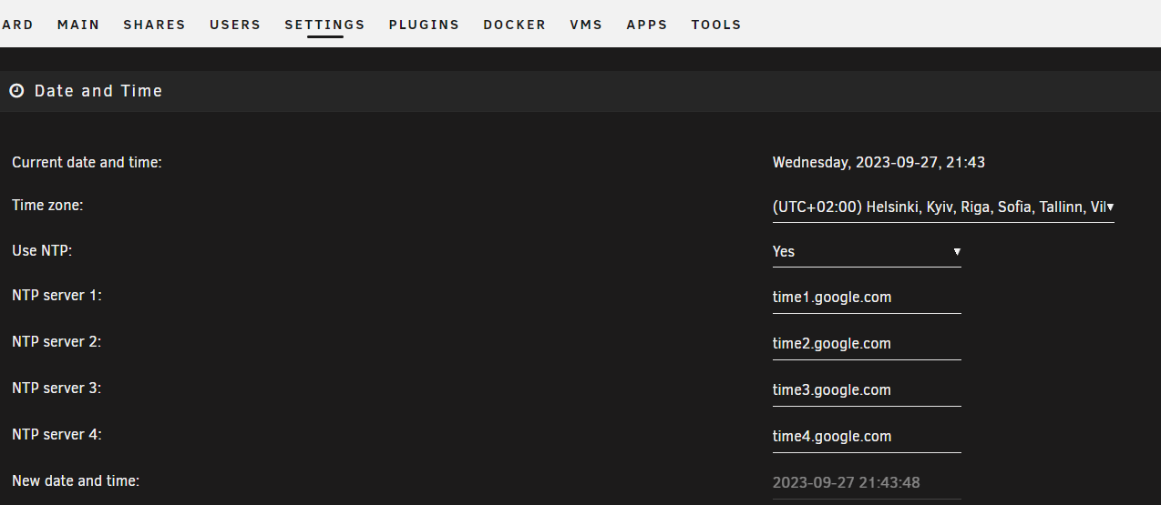

Thx! Works exactly as expected now! Time to hunt down non ZFS master related spin ups now! :D
BUT STILL! There is a minor bug:
This timer still gets updated every time you visit the main page even if no data is pulled.
It also does not conform to the same format as server -> settings -> date and time.image.thumb.png.748d04e66f385406ba64d501252cdb8a.png
(24 h vs 12 h format)
No problem; I will update for 12h format on the next release
