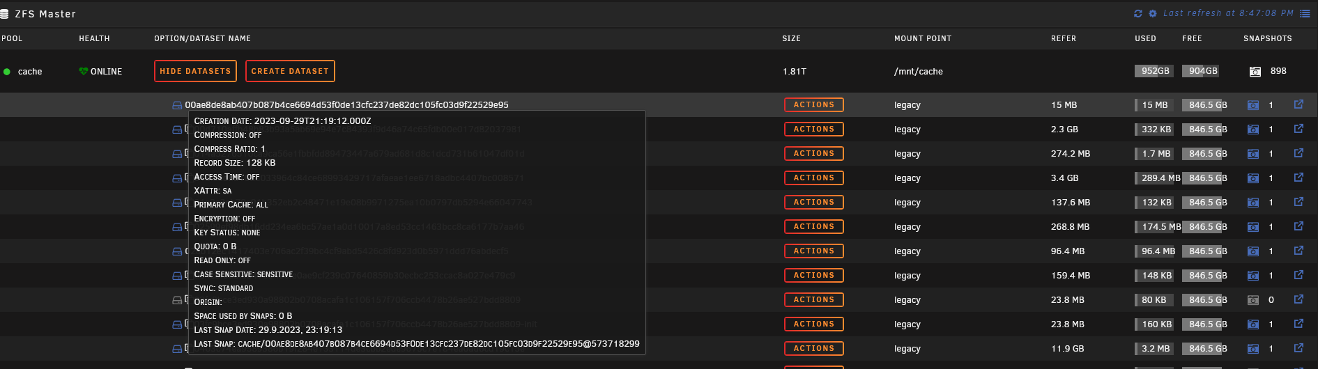

Hey guys, i have tons of datasets/snapshots (probably coming from docker folder, but not sure). What is the exclusion pattern?
I have tried "/system/.*", but that didnt work :(

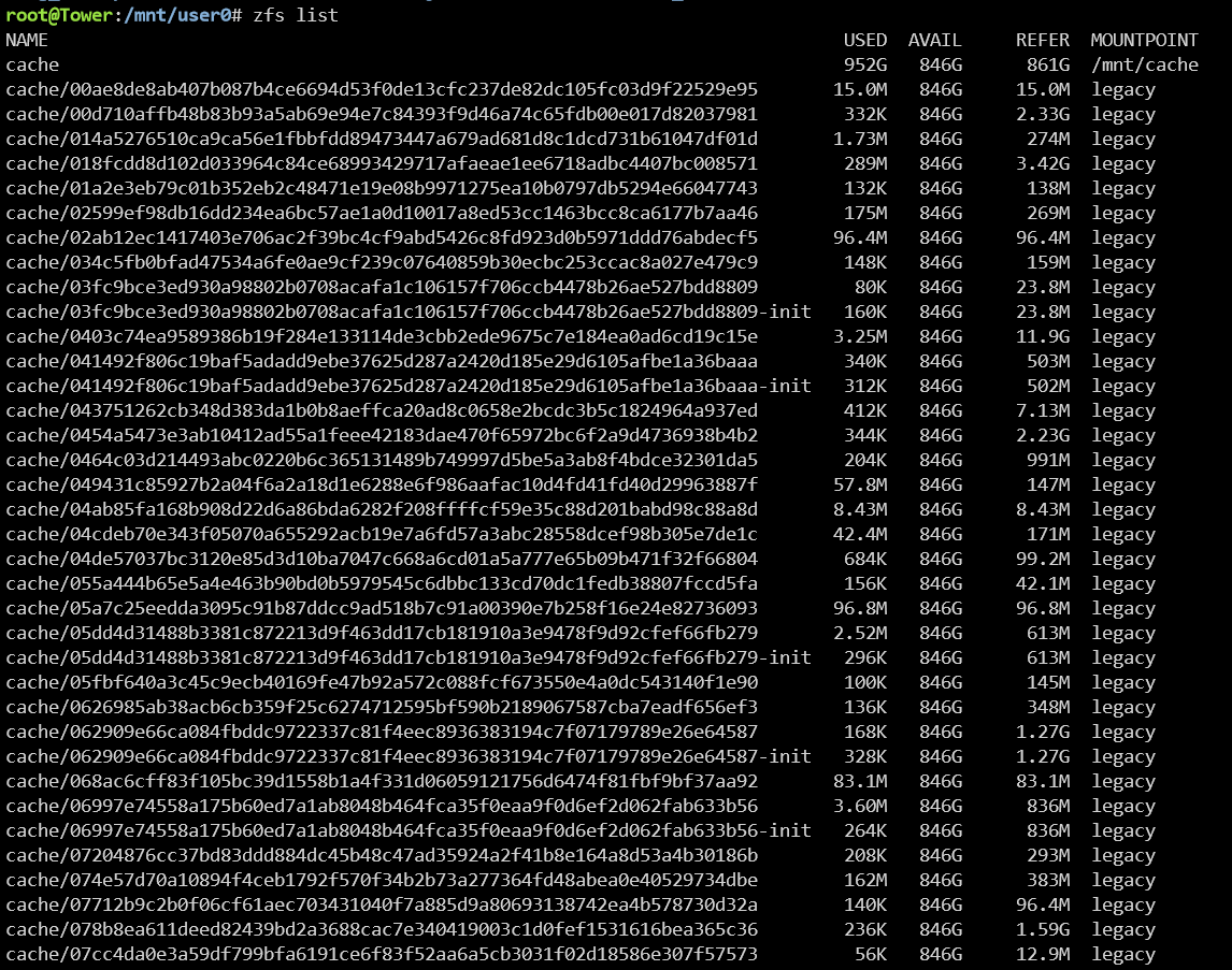

What does "zfs list" in the terminal show you?
9 minutes ago, Niklas said:
Hm. Ok. I have the docker share as it's own dataset.
17 minutes ago, Joly0 said:
Running 6.12.x?
You would have to exclude /cache/ and that's usually a no go for obvious reasons.
To fix it you will probably have to create a new share with the name docker and switch over to /mnt/user/docker in docker settings, like this:
https://docs.unraid.net/unraid-os/release-notes/6.12.0/#docker
Before doing that, you need to do this:
"Bring up the Docker settings page and set Enable docker to No and click Apply. After docker has shut down click the Delete directory checkbox and then click Delete. This will result in deleting not only the various files and directories, but also all layers stored as datasets."
You can then go to the Apps-tab -> Previous Apps, select and re-install all of your containers with retained config.
Create flash backup before anything.
Edit
After all this, you should be able to exclude /docker/.*
Edited by Niklas

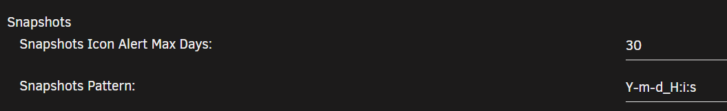

is Snapshots Icon Alert Max Days working ?
i have 30 days and no orange icon color.
@Masterwishx a couple things about that:
  • Is only displayed if the last snapshot is older than the days configured.
  • The icon color only shows on the Main page, not the dataset admin dialog.
Best
Best
Oh, OK got it.
Hey guys, i have written above already. I have a ton of datasets or snapshots (i am not sure) and i dont know where they come from?
Others said its because of docker folder, but it isnt, i removed it and they still are there...
Did you remove it like my instructions said?  You can't just delete the docker-folder manually. It will not remove the datasets. That's two different things. If you deleted the docker folder only, you'll have to remove all datasets manually. It is mentioned here before too so read back some posts.
Edited by Niklas
Yes, i stopped docker, deleted the docker directory throug the  docker settings and removed the the folder in the system share afterward aswell
