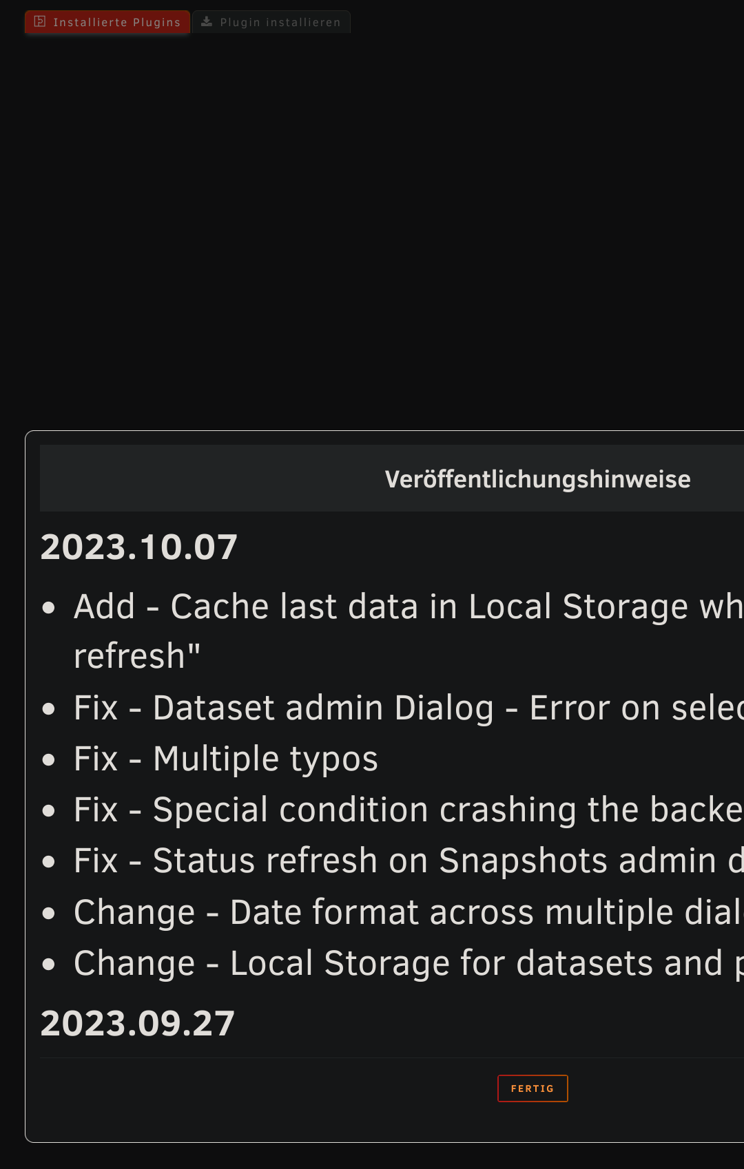

What's the Changelog? He was not showing.Screenshot_20231203-115419_Firefox.thumb.png.aed384c9dece69a361bd6b6f82e014d7.png

That was great!
This was improved the sorting in Plugins Overview too!
Every Plugin have the same Version Schema.
@Revan335 It was a empty update, no new functionality or fixes, just a test release fo the new (again) CI/CD pipeline; I'm finishing some fixes and I release the new version with minor improvements in the coming days.
@Masterwishx I'm not so sure what Squid means for "standard" versioning scheme, but I'll check.
